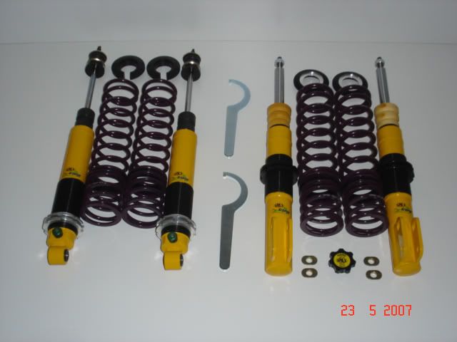

are spax coilovers good, here's 2 pics. what drop will they go does anyone know
to fit those, (tarmac and gravel rally spec sets) you will need to seam weld the rear turrets (strut tops) and possibly fit a brace in there as well as the weigt of the car wasnt designed to be taken on the shock mounts as these kits allow.

I think what Ant is referring to is the Spax kit - the coil goes over the damper on that one, unlike D2 - where the coil and damper are separate (as per OEM)
Craig
The lower picture, I believe is, the upper picture *looks* to be the sae set up as OEM
I'm sure Matt could explain the kit best, though.
Craig

i think for the last pic of the spax ones, the axle would also need strenghening aswell as the body, the damper fixing points on the axle arn't very strong.
