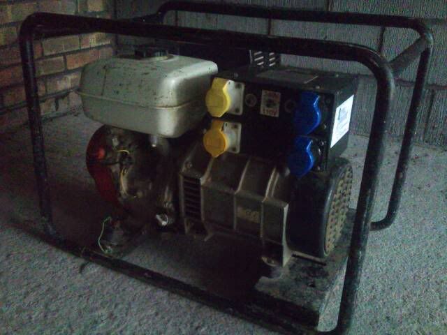

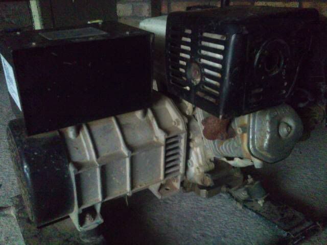

i havent a clue however i am now a proud owner of a 3yr old honda genny thats beefy and heavy! but it will do for now!
next thing for the genny is get it some rims and a silencer on the exhaust!

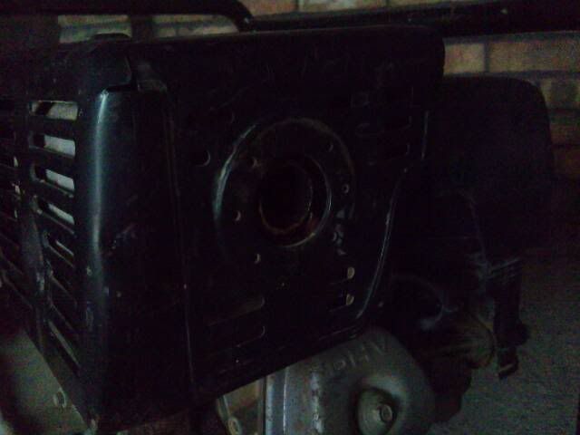

any ideas how to silence the exhaust a little?
water tub? seriously surely water would go back into the exhaust and do damage? i was thinking of extending the pipe a little!
i know i know! so your saying make up a pipe and run it into a bucket of water? sounds like clean generating! lol
but i was hoping to have the generator at the back of the garage and run a pipe out?
although i was going to "find" a shopping trolly and utilise the wheels to move the generator and simply have a bucket of water to run it in! i see sounds like a simply plan! i could make use of my old micra zorst or fab up something smaller?

the generator
the zorst! more puny than the average 998cc cg10, afterall its only 1cyl

yeah karl it does have 110 sockets and 2 240 sockets too! orderd a pair of adapters from the blue plug to normal wall plugs!
yeah ill be gettin a gasless mig soon too as i prefer mig as there simply awesome!
but im sure this one will hold out! pretty smokey though but i think it needs use
