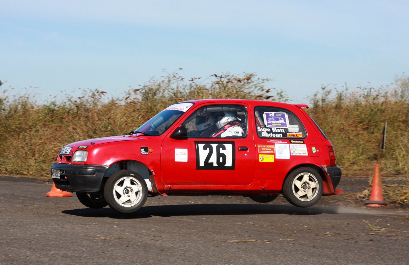

Actually nothing to the Micra for months as it is all ready to a British Championship Rally back in April which of course never happened...
So here is an old pic of the Micra rallying on #WheelsUpWednesday
