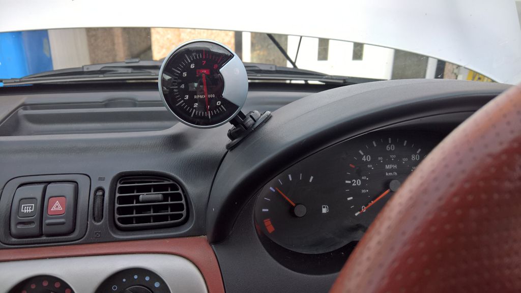

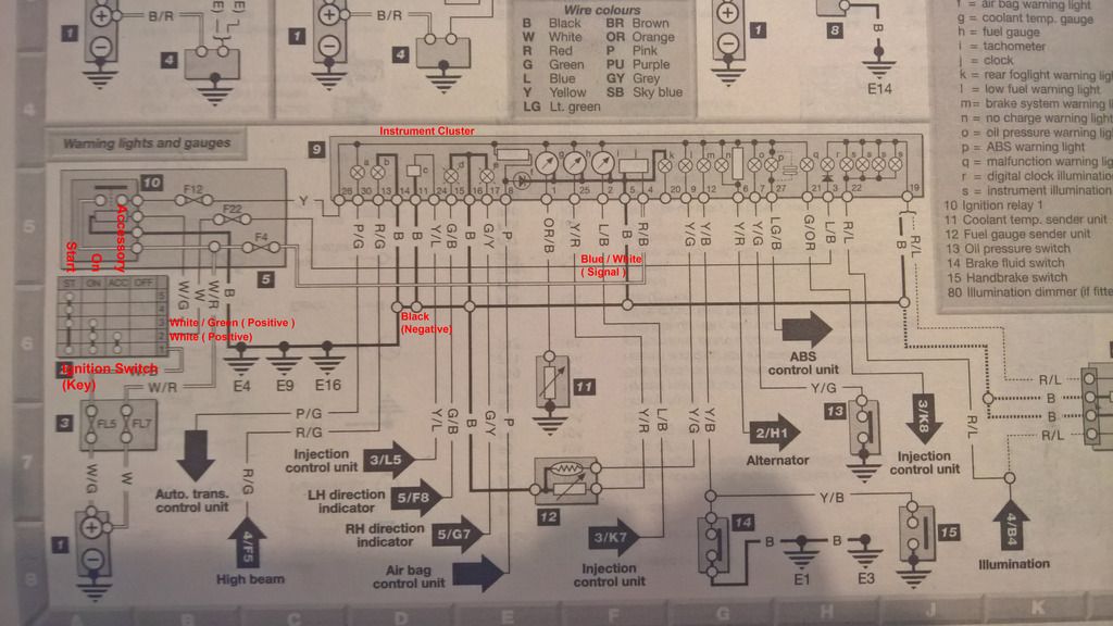

How do I fit one of these? Not having a tachometer is irritating for some reason... :)
It's really quite easy to do. Just need a phillips screwdriver, single core wire ( incase of needing to extend a wire or 2 ), snips and electrical tape for the quicker route or also a soldering iron and some solder for a cleaner more permanent connection.
Mine is a coil pack ignition, so my signal cable is spliced into the blue/black wire that goes into the instrument cluster, negative into one of the two black wires going into the instrument cluster, positive into the just white (could use green/white) wire of the ignition switch(key), quite a distance for the stock cable on a tacho hence why I suggest having some extra cable hanging around.
There's 2 screws holding the instrument shroud in place at the bottom then the whole piece will lift up and slide out, that will give you access to the instrument cluster which is secured with 3 screws. You also have to lower the steering column as far as it will go for the shroud to have enough room to be removed.
To get to the ignition switch, there's 2 screws holding the casing around the steering column together on the underside, the top just lifts away, the bottom also needs the plastic cylinder around the key barrel to be removed ( just pops of with some persuasion ). The switch is plugged into the rear of the key barrel.
I ended up making use of a dremel on the shroud so that the tacho cabling had somewhere to go without getting squished and so that the shroud sat flush.
Cheers. Just to make sure I understand you right, theres already the capacity for having a tacho on the Micra so you just need to wire the aftermarket one in using your instructions?
that's correct, as all models will have used the same wiring loom, including the super s / sr which had a tacho in the instrument cluster
Not the always the case. On the dizzy engines The wiring will be there at the clocks yes but the wire goes back to the Ecu where it's often not connected at the ecu. On coilpack engines however it is connected .
1993 Prefacelift GT15 turbo cg10de(t) @ 7psi
2001 Facelift cg10de
was hoping for someone else to chime in on this in regards to dizzy engines, only worked with the coil pack engines so far
