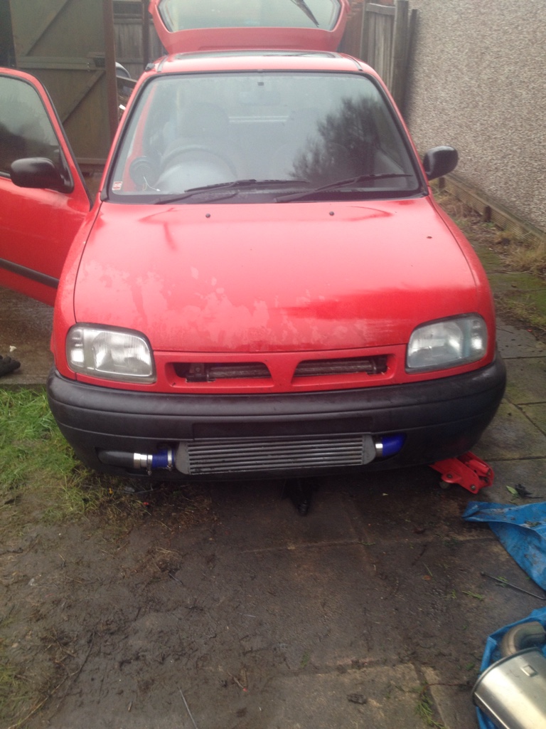

Got my engine out. Now i gotta try and test fit the CG13 in tomorrow so i get some measurements for a drivers side mount :)

Got this far fitting the MA10 gearbox to the CG13. Found out the bolts are M10 on a CG13 vs M8 on the MA10, just need new bolts though, which is nice :)

Question - why are you using the MA box? :)
Mainly to make the swap a little easier. Using the MA10 box means i only have to change one engine mount and as a bonus i get some maaaad acceleration :L
I do have to use a 160mm clutch though and i am unsure how much power an MA10 box can take before it goes bang.
I am hoping to have around 90HP when im done :)
