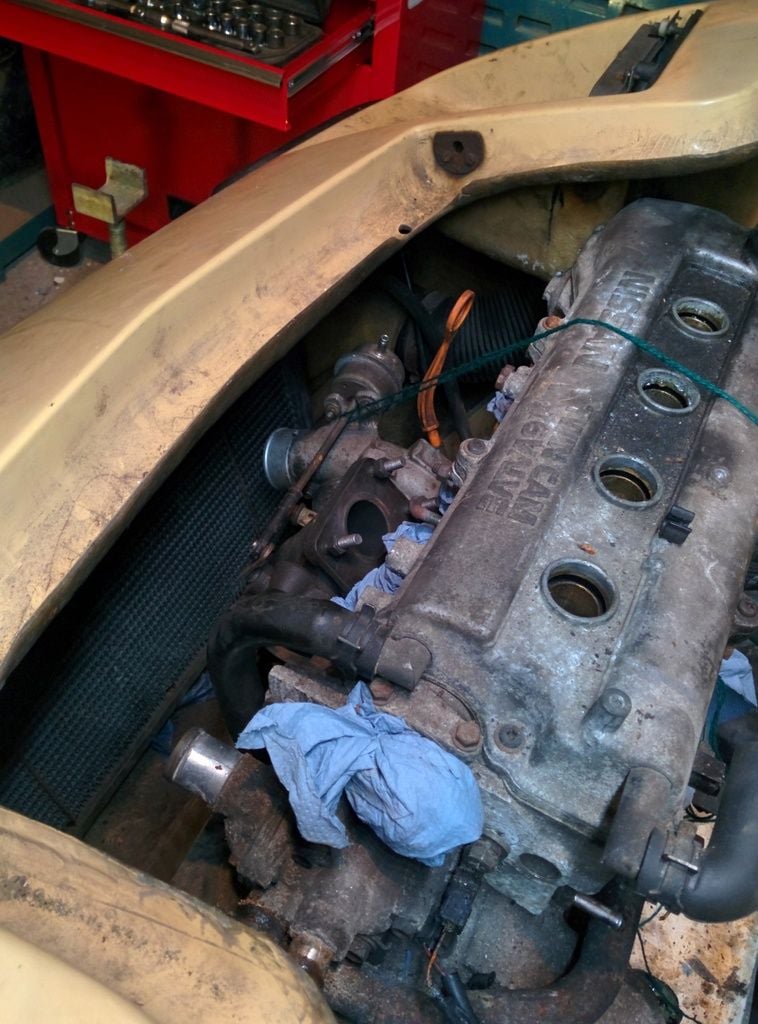

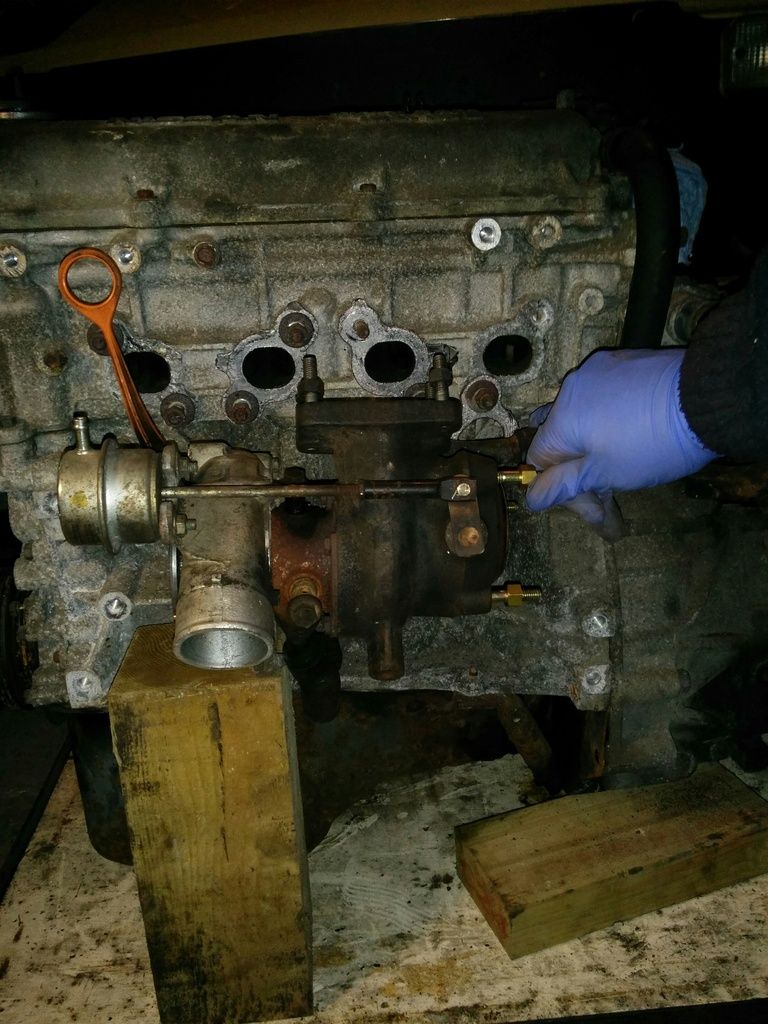

Started to look how the turbo&engine fit in the kit car
Yep its very tight

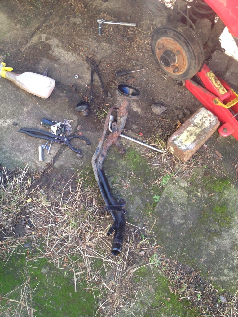

finally found the leak of the filler neck so got a new one gona under seal it then fit it in eh @frank

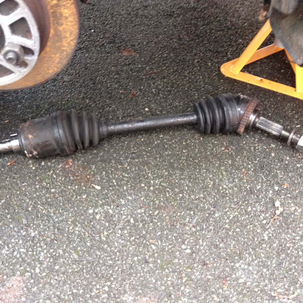

Good day today considering the nightmare yesterday, sourced two new cv joints and track rod ends in Belfast and installed the track rod ends and the cv joint that wrecked me yesterday was wee buns putting the new one on so I guess the original was knackered .. The test drive was a surprise.. So sweet on the road with the tracking still to be done tomorrow..

I'm not surprised :eek: The only micra one I've separated took a lot of persuading(BFH) before the spring clip gave it up and that was with the driveshaft out and in a vice.
You're trying to ' shock ' the spring clip inside the splines in the cv joint so it can slide out. I'd try smacking the back of the CV with a solid lump of wood and move on up from there...
Try to keep the cv straight, I think we may have turned it upside down and rammed it down through the vise jaws? We came close to buggering the joint.. Two hammers one either side might do it but your timing might have to be good...
Don't they give you whole driveshafts as replacements anyway?
