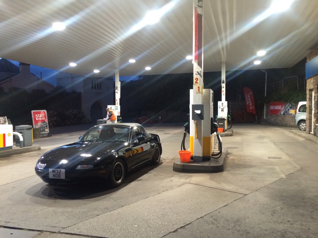

Been quiet for a while because I've been busy on my occasional road and definitely fun car.
At first glance I thought your number plate was a tad rude... Looks good though mate :) I've toyed with the idea of getting one of these, but it means giving up the starlet :|
