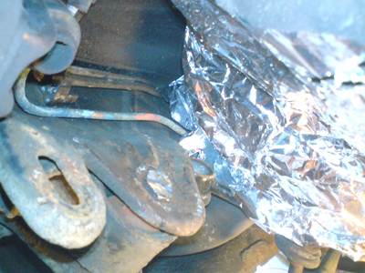

2- you mean grinding off seized trailing arm bolts?
I covered my tank with kitchen foil or some sheet metal to protect the tank from hot sparks.

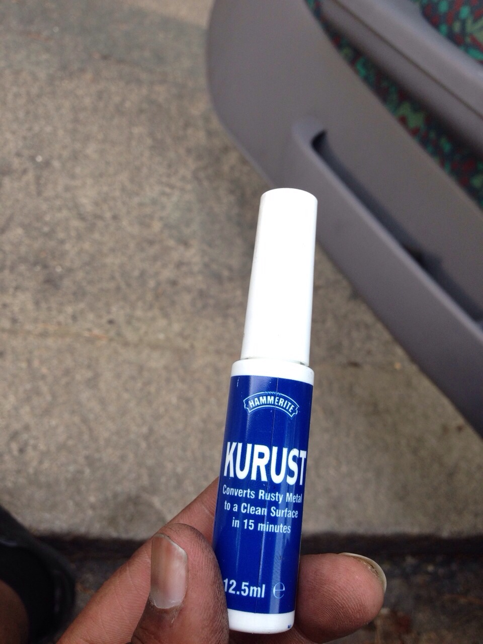

Many thanks PollyP,
What you mean by treating? Will it not suffice to paint on bare metal with hammerite direct to rust metal paint?
Regards

once rust starts and gets more severe, it eats deeper into the metal becoming harder to stop and can only be slowed down.
even after grinding down to bare metal, there's still specks of rust pitted deep inside the metal.
simply painting over grinded rust, it still continues rusting underneath and soon reappears.
direct to rust hammerite may slow it down abit. I apply rust treatment and underseal to the chassis to further slow it but there's no stopping it.

for the underside that's not seen, I usually wirebrush till bare metal, clean, brush on kurust n wait till dry, primer, dry, base coat, dry, laquer, dry, underseal.
