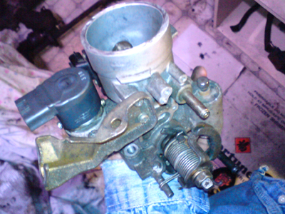

Told dad to get me some 8mm pipe from work...
It's coolant bypass time!
Is it worth it?
Why coolant bypass? whats happened?
J
Just bypassing the coolant lines that run through the throttle body. Marginally colder throttle body. Marginally denser air. Less than marginal power increase.![]()

And by doing this doesnt it affect any morning start idle? or even during driving etc?

Idle is set to about 1000 so it's not too badit's going good so far

Ok so is there any reason for the hi idle?
When bypassing the tb coolant, the fast idle waxstat at the rear tb no longer works n stuck on, which is keeping the throttle stuck open and always fast idling.
You need to remove the fast idle cam mechanism to let the throttle plate fully close.
Idle control is also managed by the IAV at the front tb. Ensure its clean n working.
