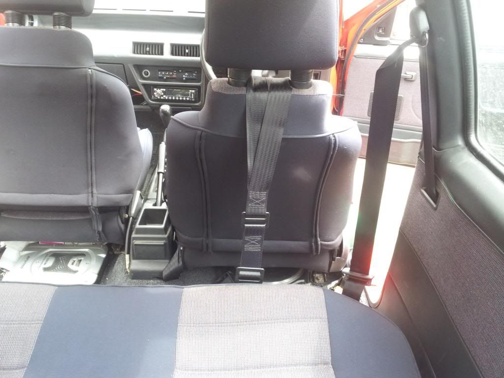

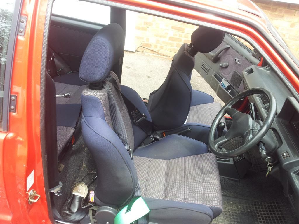

I mounted my harness in my car today, it is only a show harness as I would never feel safe with how I have it set up and also because of the fact its only bolted to seat belt points and I have no cage.

bout to say, harnesses and no cage.. I think you aint going to be too bad mate.. I may even give in and just put the harnesses in without the cage!!

Yeah its not that bad but I heard that if you dont mount the top straps correctly you can get serious back injures in a crash. I stay in my seat alot better though. I got another one to go on the passenger seat too. I think if I set them up correctly I should be fine but I dont think its worth the risk. I would rather make up a bar like this guy did.
My brother has named my setup "the back breaker" lol.

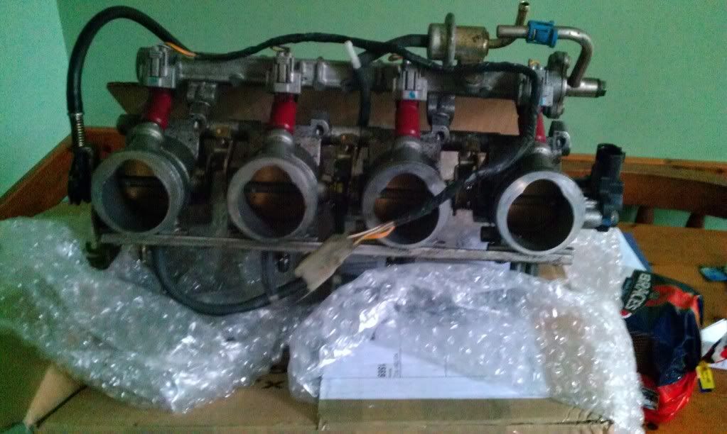

As promised.....
Think i'll make a new manifold, and keep the one for the carbs for future projects
very nice :cool:

I had to stop watching that video after a few minutes. All I can see happening is that in the unfortunate event of a crash, the 'harness bar' that he made (very badly) is going to either snap where the hole for the camera mount is or the welds are going to break on the b-pillar. Either way he'll get a lump of 25mm box section wrapped around his head. You already know that bolting the rear part of your harness straight to the floor behind the seat is a bad idea, (the harness has no forward stopping power) so why not put a half cage in and do it properly, then you can use them with confidence.
Im purely using them for show since I got the harnesses for free. I would love a half cage or a cage but I can't afford one.
