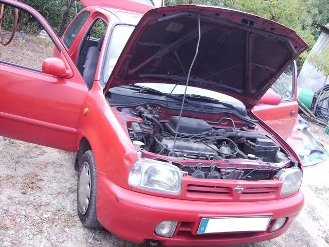

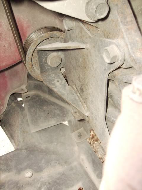

Removed some stuff from the SuperS to preparing it for the March conversion and for the bodywork/paint job. Discovered that it was a pre-loom for A/C, and a different bracket with a pulley replacing the compressor.

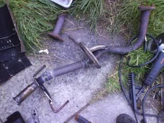

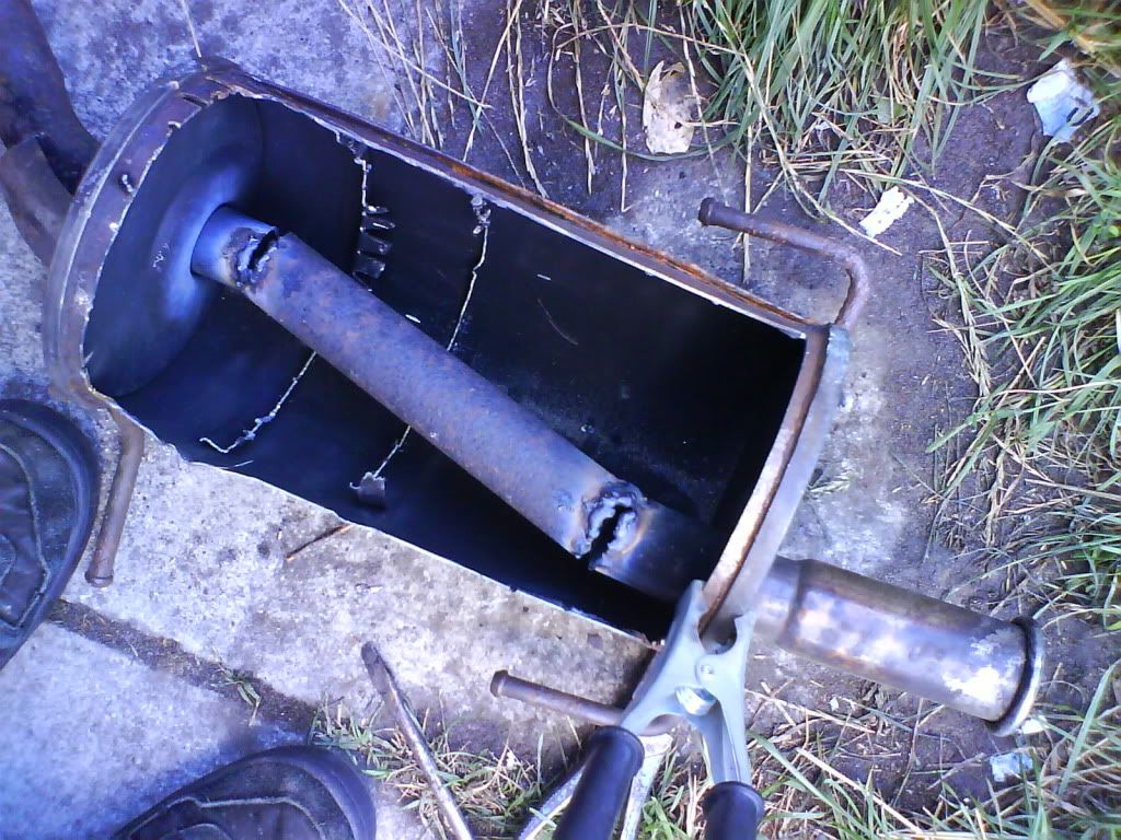

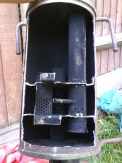

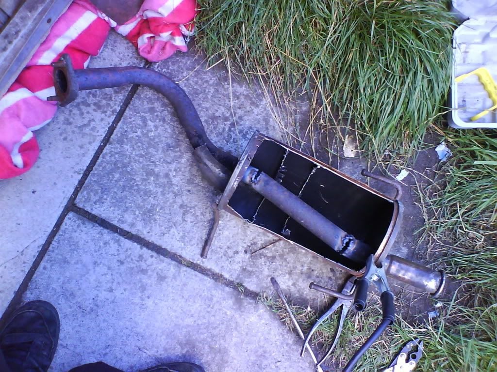

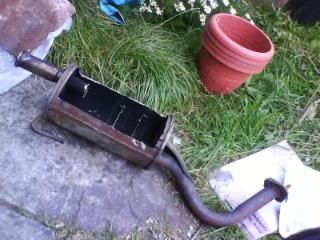

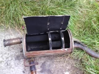

had a go at this 1.3 back box, probly from factory.
look'd strange to me from inside :grinning:

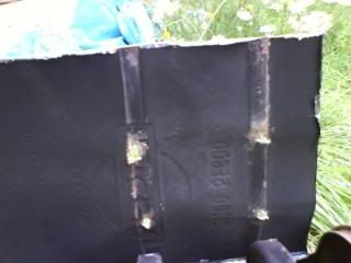

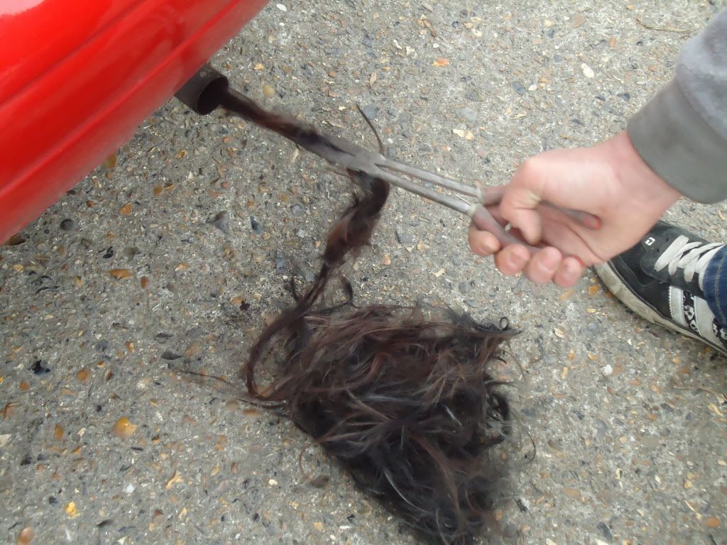

had no baffle cloth inside

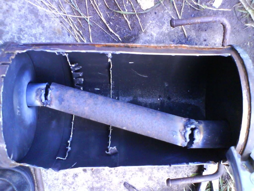

so may have to do a straight threw and just keep the hanger brackets, grinder ftw, until molten metal starts landing in the wrong places :grinning:
patent pending :grinning:
No soundproofing R-Reg? That is weird fwn. Definitely need to just weld a straight bit of pipe onto the midsection :laugh:
yeah kinda ended up pulling it out as it was hanging about a foot out my exhaust looked stupid!
must admit though didnt make the exhaust any louder at all without it! the back box rattles a goodun
from the rust in it

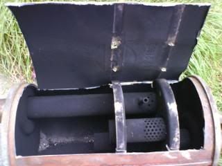

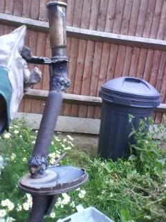

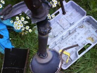

back box jobby, pipes attach'd so now i need more cutting discs to cut everything not necessary apart from hangers and get good access to the pipe to weld , got plenty scrap pieces to fill holes and that
top man :grinning: if i knew this back box hadnt any baffle fluff stuff inside i'd have just put it on straight:laugh:

this stick welder i am getting used to, the stick doesnt actually touch the work piece. it sort of pastes (ark's on) on the weld making it real good at filling holes,more practice should have me doing the thin body panels soon
have to cut off the rest of the unneeded back box pieces tomoro ,gun gum and done
first time welder so it aint too tidy but does the job !
:grinning:
Nice exhaust R-Reg :laugh:. Need a sound vid when it's fitted (Y). Then a cat bypass pipe and a 4-2-1 manifold :grinning:

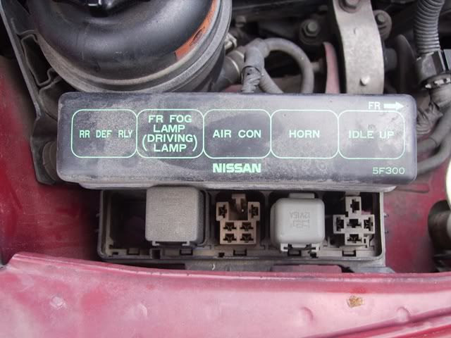

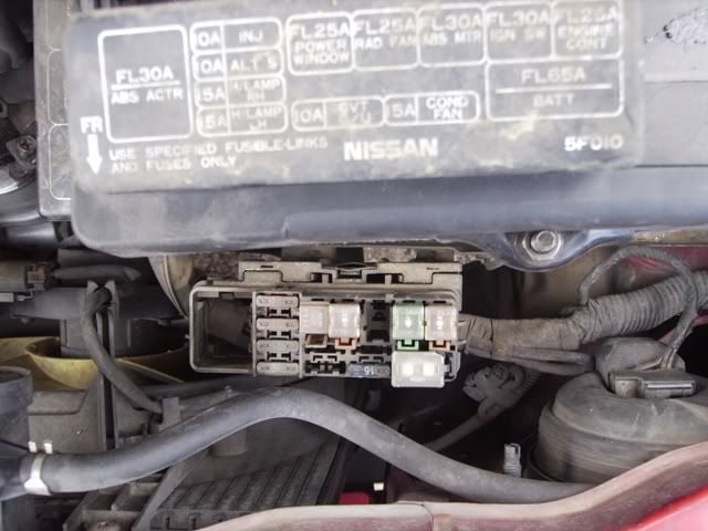

Ok, manage to make some progress about the March wiring loom, already found the CVT start inhibitor and reverse/neutral switches.
This two connectors are the ones you need to "work":
To bypass the CVT inhibitor, its just a matter of joining the two wires on this connector, make sure its thick enough:
To enable the reverse/neutral switches, use this connector:
Use this diagram to make the right connections:
That wiring diagram is from the gearbox connector, on my pic is, front left to right on the upper line to lower line:
6 - D
5 - Ds
X
3 - Positive
X
9 - N
8 - R
7 - P
So, you just need to join the pin #3 to both switches on the manual gearbox and join each of the other wires to pin #8 and pin #9 on the auto loom, in correct order.
Hope this can be helpful.

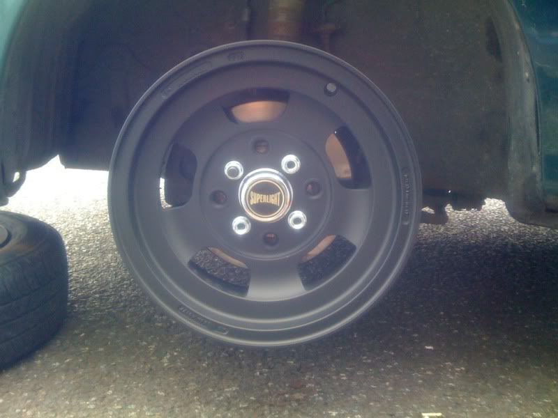

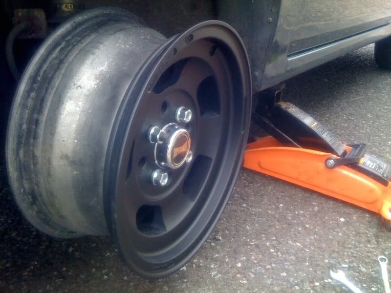

Managed to install one yes ONE extended stud today. getting them out wasn't the problem. winding the new ones in is very time consuming took me almost two hours to do just one!!
Wheels looking tasty now though and there is gonna be some thread left for spacers too! (Y)
Sorry for the Cheapy iPhone pictures...

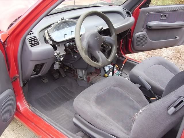

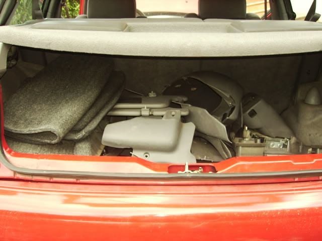

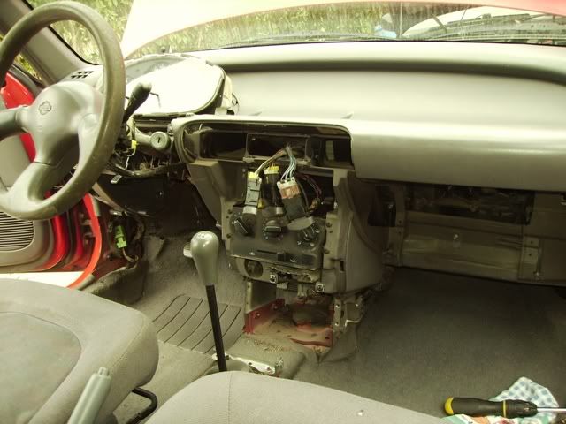

went to remove the new afr gauge that stopped working already and decided to remove remains of aierial and alarm system ready for new one!
ended up removing the dash and all the surrounding parts heating system and everything!
removed the sound deadening and bits behind there and done the dim dip bypass that joe had made a very simple guide for!
