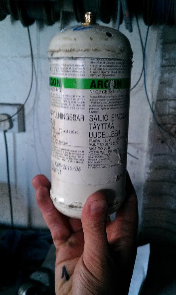

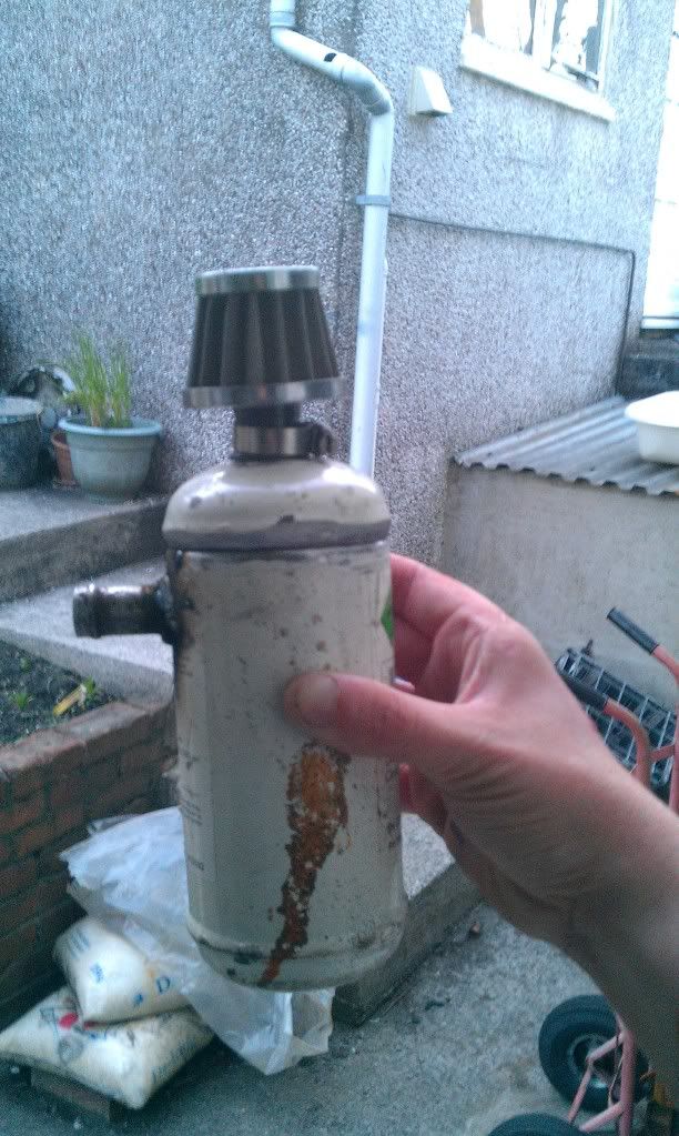

Had half hour spare earlier and I've got a bit fed up of oil vapor from the breather on the rocker cover which collects inside the filter and drips down the back of the engine, so I decided to make an oil catch tank.....
Take one old argon gas bottle and chop the end off
Chop it down to size
Weld on a inlet and vent
Will have to sort through my fittings to find appropriate elbows for a view/level glass then I can weld the top back on.

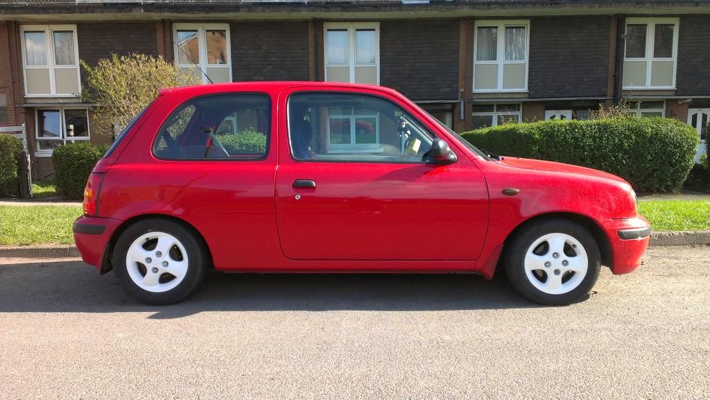

Sorry, got carried away with the picsLovely day in Sheffield, I didn't even have to spray the wheels in the living room
Thanks JenBlimey Ade...They are properly white!...it's like that Bleach advert BLINDING! LOL
...in a good way though...they look great![]()
