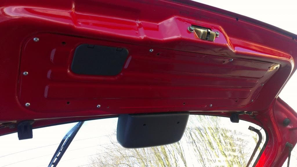

Wdid? Got rid of the bloody incessant annoying rattles from the rear of the car. First job was to drill the internal rear hatch cover and secure with self tappers and then I adjusted the boot latch to pull boot lid down tighter.......result, no more rattles :D

I need to this, my boot rattle is getting louder & louder! Don't suppose you'll be putting a guide or pics or anything up will you?

Didn't really think a guide would be necessary to be honest but have some pics odd ball :D
Here you can see the useless plastic clips have been binned and cover is now secured with self tapping screws......
And below shows the striker in the boot, loosen the two 10mm bolts and gently tap striker towards boot floor, tighten up and try bootlid. If you tap striker down too far you will have to really bang boot down hard to get it to latch, or it may not even latch at all so you may have to adjust a few times to get the best compromise.
Hope thats some help to you odd ball ;)

Cheers for that, it was the bit about using self tappers I didn't understand... Didn't realise you were on about that access panel... Mine came off long ago so I can skip that!
Will have a go at the latch in the week...
