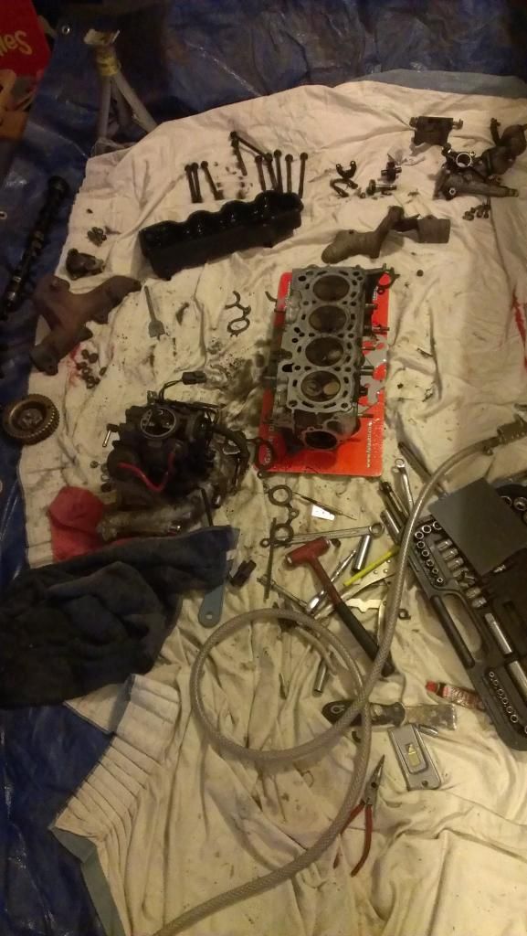

i thought this might of cleared but it got worse and the garage confirmed head gasket and not to drive it anymore until its done. so its being looked at today stripped down etc. Cylinder Head will be sent off to a engine workshop and get it skimmed and a new uprated head gasket will be fitted!

Well, yesterday actually I stripped head off car to ascertain damage prior to making a decision on whether to repair or scrap

you can fix it ade ;) is the gasket bad ?
Thanks for the vote of confidence Frank :) . Didn't look too bad on first inspection but when removed it left a couple of fire rings behind :oops:. Tbh I think the problem was:-
a: Not renewing head bolts, which I knew were suspect last time
b: Not thread chasing/tapping head bolt holes
These things WILL be done if I decide to repair it
Need to test head for trueness(??) when I get a decent straight edge and some feeler gauges before deciding which way things are gonna go
