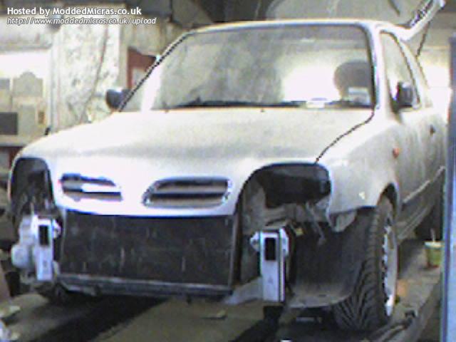

Right basically i need better brakes. My car is a 99 1.0 micra now with bigger engine fitted. It's fitted with 15" wheels so i've got room for bigger brakes. I've tried primera GT discs but the stud pattern is different so i would have to redrill them. Then make brackets for the calipers. Abit of work i know, so i was wondering if there is another nissan with the same stud pattern as a micra but bigger brakes that should go on? Any help would be really appreciated.
How do i put pics on here? I've took a few of the car and would like to show it on here.
http://www.moddedmicras.co.uk/upload/files/30-Photo-0174.jpg.
http://www.moddedmicras.co.uk/upload/files/26-1New wheels.jpg
