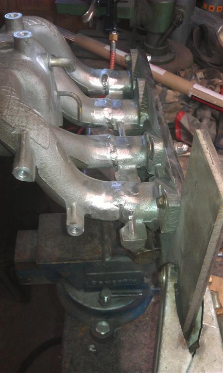

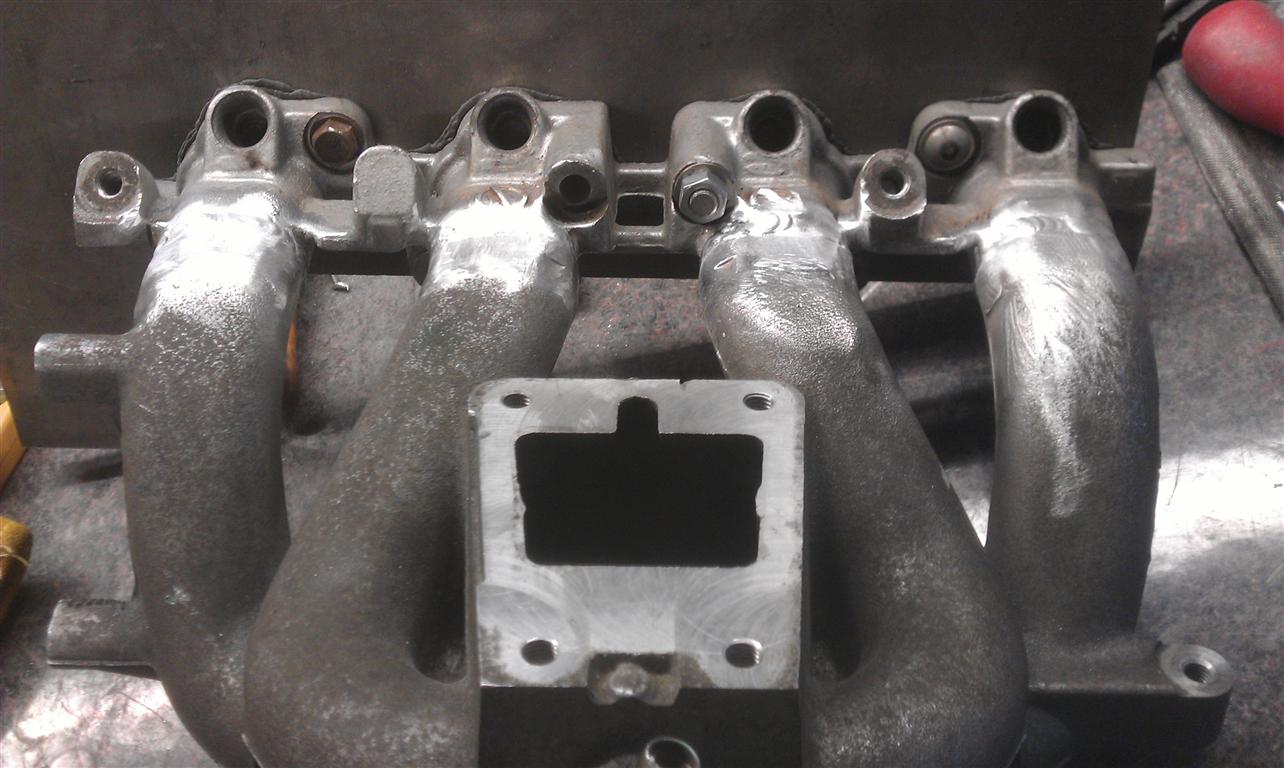

I cut and shut the CG and CGA inlet mani to retain the CG throttle body in stock position.
came out as everyone suggests. a piece of red hot steel with welding rod attached. pile of aluminium on the floor!and how did weld come out like ?
