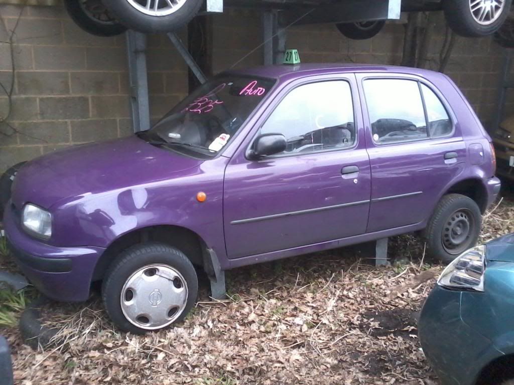

I've just bought this 'splendid' example of a 1.0 Shape Auto for my uncle.
He wanted a five door automatic - and they are very hard to come by!
It's going to need a few bits to put it back on the road - so doubtless I'll be hassling the group with dumb newbie questions over the next few weeks.
Out of interest, what would you say were the most common problems on elderly, high mileage K11s?
Top of the list is probably rust?... Main area of concern would be the front cross member, they rust quite badly & can be an MOT failure...
Cheers guys, It looked pretty solid underneath, but I'll know more when I jack it up at the weekend.
Yep, it's a scrapyard. The vehicle is Cat C (although the damage is very slight) so it will need a VIC before going back on the road.
Please call it Helmet?
I've wanted someone to call their purple car "Helmet" for years now :(
