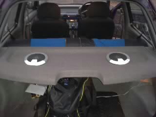

installed these
sound is much better now,not the most powerfull,but going from 2 speakers to 4 is a big improvement in my opinion.

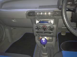

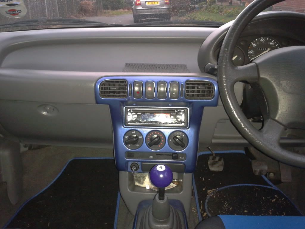

gone from this...
to this...

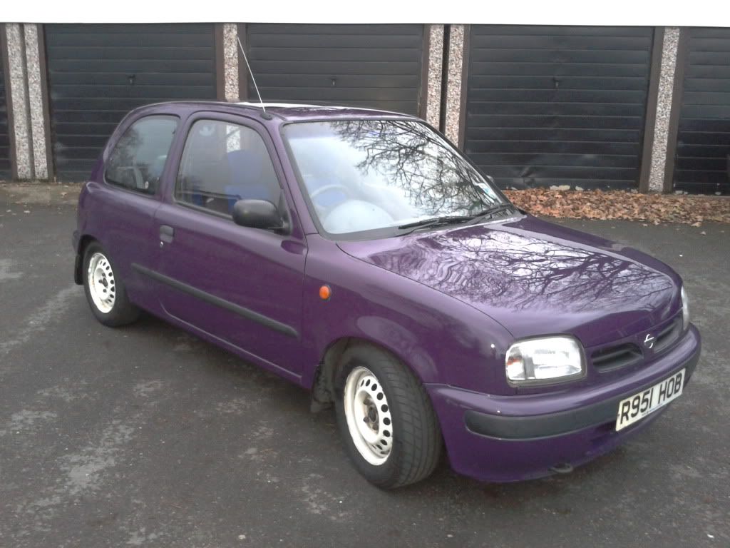

it did pass the mot with cut springs,cant remember exactly how many coils were cut of but think it was 3 or there abouts,the springs dont fall out of the cups hence it was safe,rear ones are a little iffy when jacking the car up,but no problems since, standard shocks,just the washer thing was moved lower and welded into place to allow them to go higher into the top/brace,with the excess rod going through the top of the brace a tubular piece of steel was put on it then the nut on top, to stop the rod falling too low,hence when the car is jacked up the wheel cant fall too low and the spring fall out, hope this makes sence and helps a little

another lil update, purple hobbit passed another m.o.t last week,advisory on sills though,think next year they'll need doing:(, a service and new bosch plugs and purple hobbit is feeling good:D, also some deep dish on the rear,front not do-able due to arches and lows,still need stiffening/raising the rear due to rubbing,pics coming soon

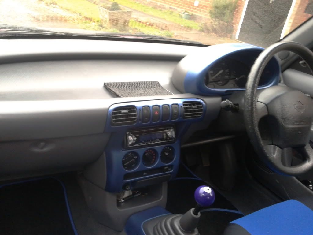

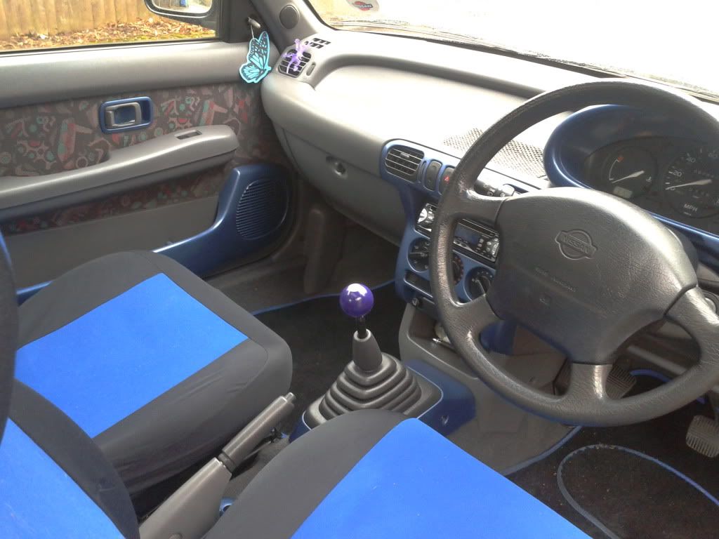

Good work! I'm liking the color coding inside, as well. Just how hard is it to remove the speedo and heater controls plastic covers? I would like to do the same with my mate's Micra..........
So, just how do the covers come off, then? Are some of the screws covered up on the heater controls? (I can't remember seeing any on my Mate's K11.......)
Theres plenty of info about removing interior parts but here we go.....
To remove center console..
Two screws above head unit
Remove ashtray and there's another two screws
Pry fascia off :)
To remove speedo surround..
Drop the steering wheel to the lowest setting and youll see a couple of screws, I'm pretty sure you know where the rest are :)
