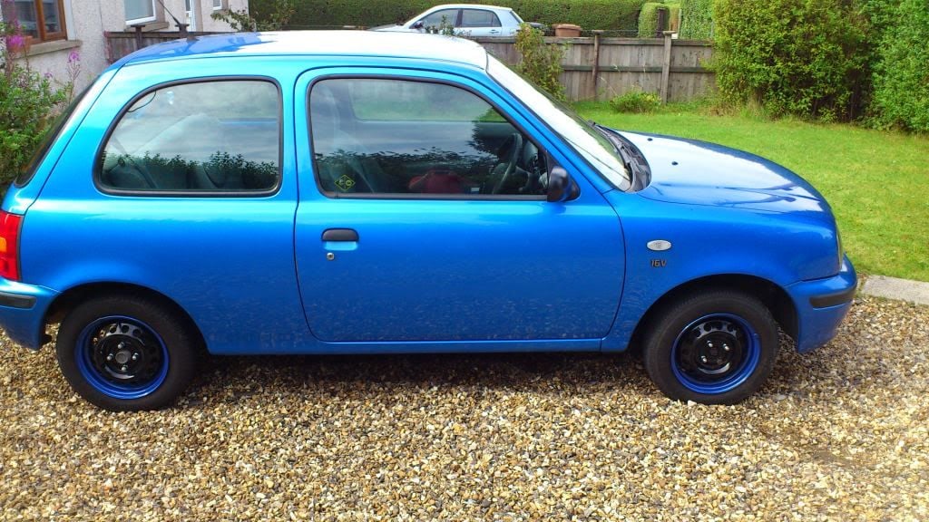

Looks alot better now I think! Just weird looking at it now without them... seems so strange after spending so long putting up with them!

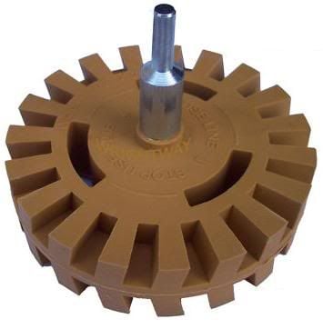

This is the toffee wheel I used, the new vented kind. So much bigger than I expected but then it's suprising how quickly it wears down!

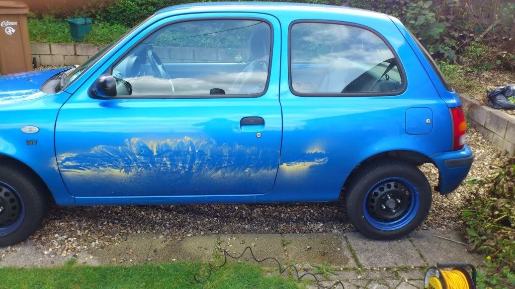

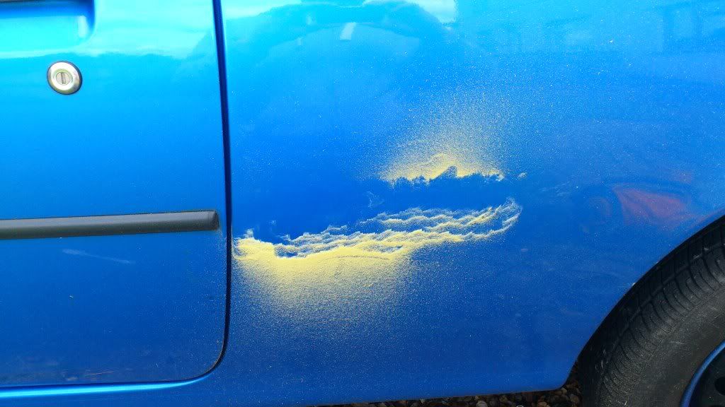

Took maybe half an hour to do both sides... but comes off amazingly quickly once you pluck up the courage! Still tough going though, wouldn't fancy attempting it with a credit card and petrol like some have... So some progress shots:

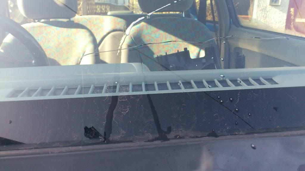

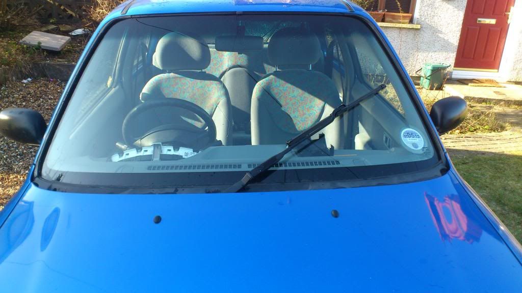

First one off to test:

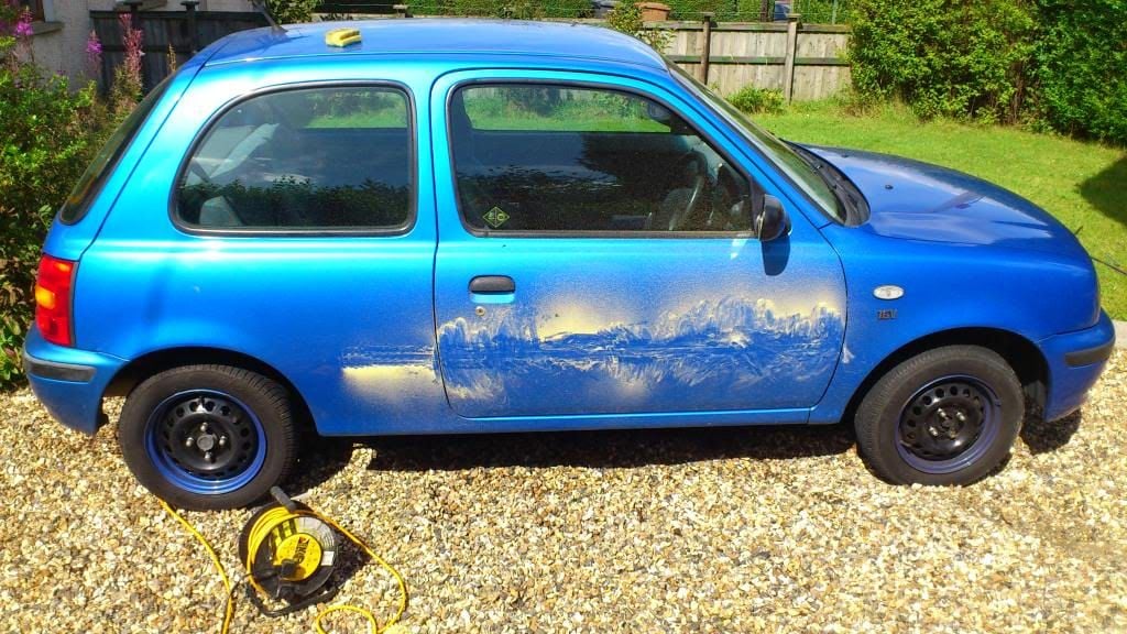

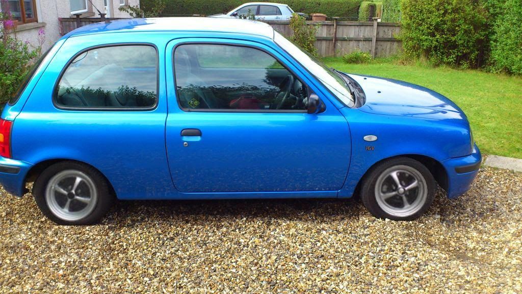

Then all off!:
Makes quite a mess! I used the boiling water method to get the strips off... Boiled the kettle and poured down the side of the car onto the strips. For the first section I thought I'd use a butter knife to begin to pry the strip away from the body... bad idea! Left a small chip in the paint underneath... But I'll not beat myself up over it. Just used my nails to pull the rest off.

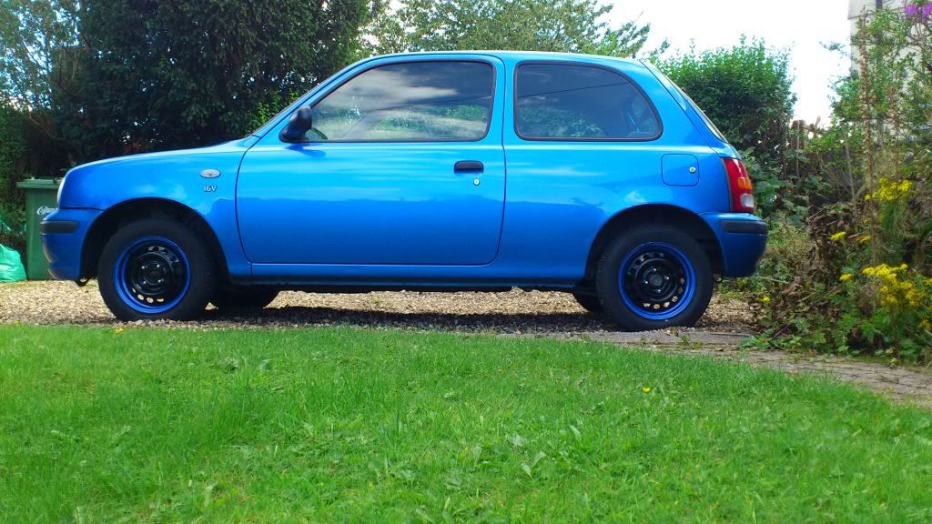

Not sure if you can see it too well in the pictures below but the strips have left a slight mark in the paint that I can't get out (yet!) but no noticable unless you're right up close. Also the glue seems to have left some residue on the paint, which is more apparent on the driver's side (2nd pic)... I'll hae a go of wiping this off with petrol at some point but hopefully everything will look btter with a proper wax etc?...
Was sunny as hell to today and the car looked shiney and shexy as fup without her bump strips... Did notice though that there are some scratch marks in the rear drivers side panel. Not sure if I did this while cleaning the car afterwards? Bit gutting but again, hopefully it'll polish out!?
Then all off!:
