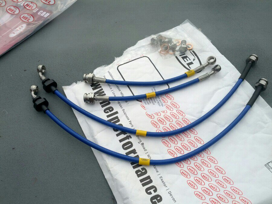

Never had them before i shall give you a heads up how they ride.I've never been interested in those pre made stainless hoses.... opinions Chris?

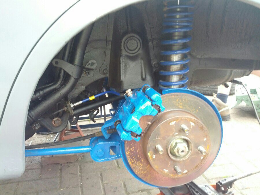

I am indeed my friend.U gonna make protective covers for ur coilovers to keep the threads n coils all clean n dry like on mine?

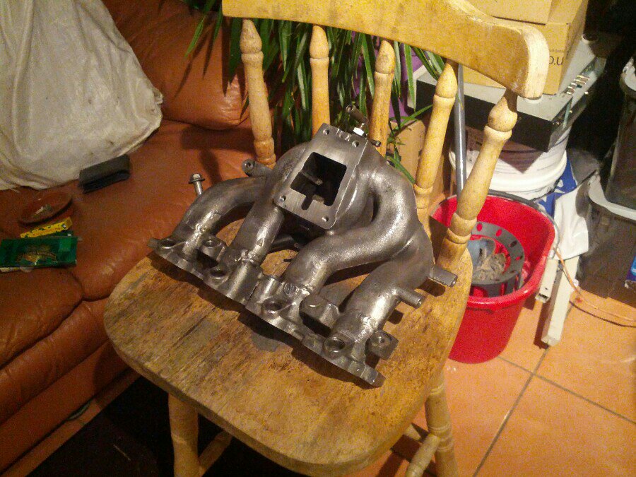

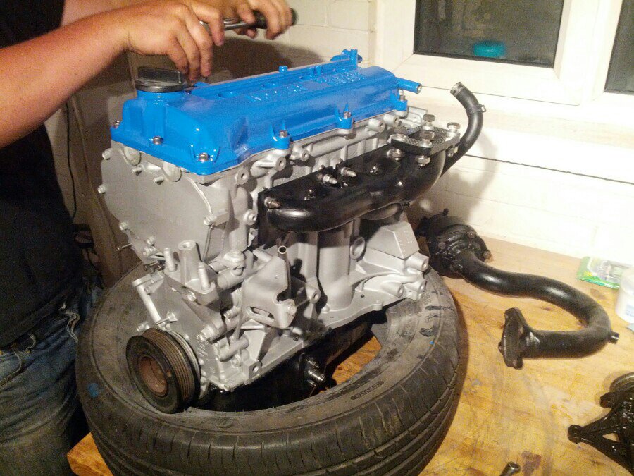

@enuo also I figured would tighten up the manifold and the two gaskets to let them settle. I will then tighten again tomorrow. The Mani is quite warped as is so I figured to let that settle in and then re tighten
Piss... Grub screw is stuck in the head arghhhhhh no turbo oil feed
I debated just that but it's severely warped I would have near to no flange leftI lapped/sanded mine flat on mirror with wet dry
I have decided to go for a sandwich plate Paul. The ports on it. I would have turbo feed, pressure and temp as well then.I carefully undid mine with a bolt extractor tool.
alternatively you could dremel a slot across the exposed head of the grub and undo it with a flat head impact driver?
