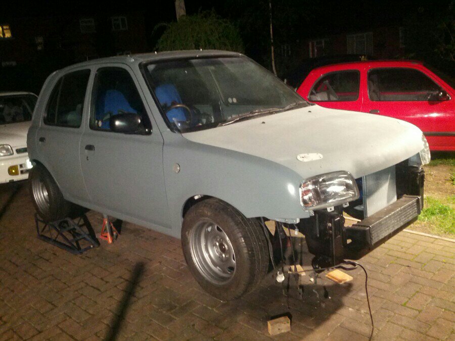

Not according to ChrisThat's why wheel arches are going on. #hater!

You watch me lol. The mot man will let me go back and forth till it passes so he will no doubt let me change wheels.Wont pass an mot with tyres stuck out past the arch :/
Who said I was putting arches on?That's why wheel arches are going on. #hater!

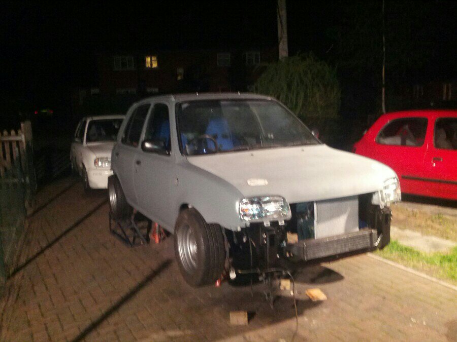

those wheels n tyres look very beefy & meaty

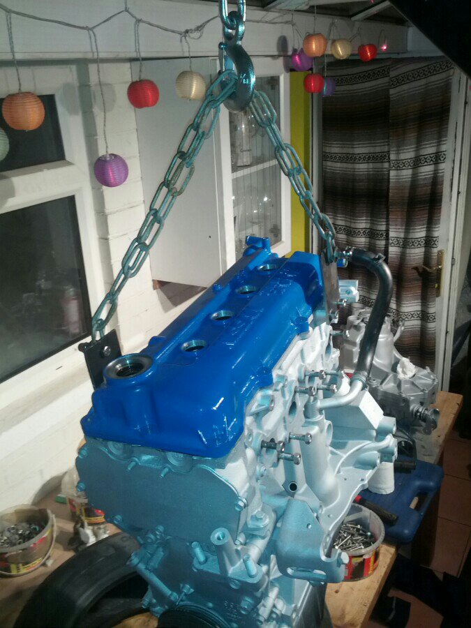

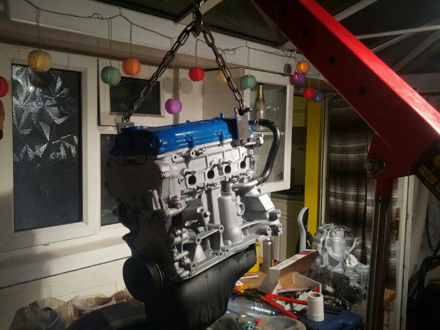

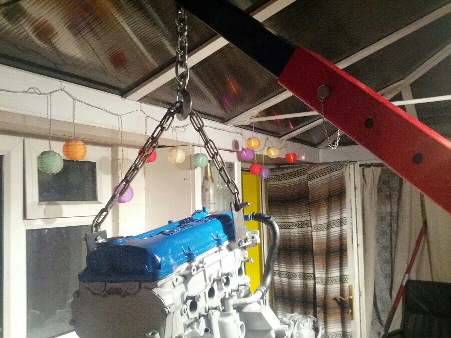

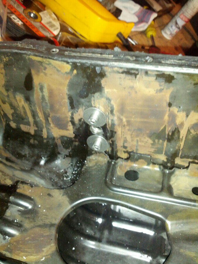

Made some brackets for lifting the engine.![]()

Why thank you . I think they were good thinking .Them engine brackets are spot on mate![]()

Yeah literally a rectangle of metal and three holes on each. Two m8 bolts attach to the head on the bottom and a bolt through the top with penny washers to hold the chain. Bloody cracking bit of kit.Easy enough to do ?
