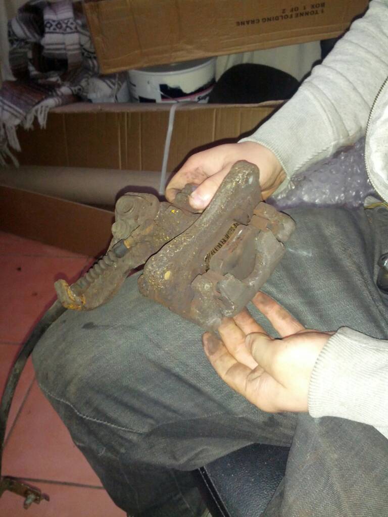

http://www.ebay.co.uk/itm/Nissan-Micra-K11-Rear-Brake-Caliper-Repair-Kit-3018-/281092166552?
Just bought these
Should turn up Wednesday

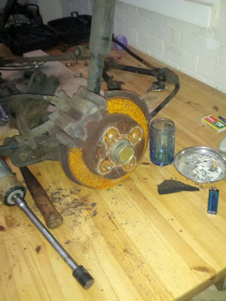

also finding it hard getting seals for the front calipers...Used a kit from them on my front calipers, good quality
haha ta matethese any use to you mate:
http://www.ebay.co.uk/itm/NISSAN-MI...PER-REPAIR-SERVICE-KIT-BCK4862A-/330909190856
I should have said im not running micra calipers up front![]()
haha ta mate
Whilst you are here, what type of grease do I need for the various locations on the calipers front and rear?
Errr well you come up with a design and I will think about it. I will stencil it up and paint it on. I want the idea of a tank to the car, battleship works well.. Like the idea of battleship galactica. Or frigates corvettes and what not. Just military stuff.I dare you to get a sticker along the lines of "You can't sink my turbo battleship"![]()
Yeah and for behind the rear disk calliper handbrake arm... Stuff like that.For the slide pins that sort if thing? I've just used copperslip to be honest mate, I'm sure others have just used regular good quality grease, so long as u don't slap too much on there shouldn't be a problem with it melting and getting where it shouldn't
usually silicone grease on the sliders dude, as copper slip doesnt like heat too much, wheres as silicone grease takes high temps so shouldnt stick so quickly
where dya get silicone grease/paste from will?
auto factors do it, the suspension silicone grease you get it good, the little tubes you get with suspension bushes lol
this would do the trick! http://www.ebay.co.uk/itm/SILICONE-...ssories_Car_Care_Cleaning&hash=item2ec7a7aa53
the amount of times ive changed disks and pads where the sliders are stuck solid is unreal, just pull them out clean it, remove the rust and silicone grease and its like new!
