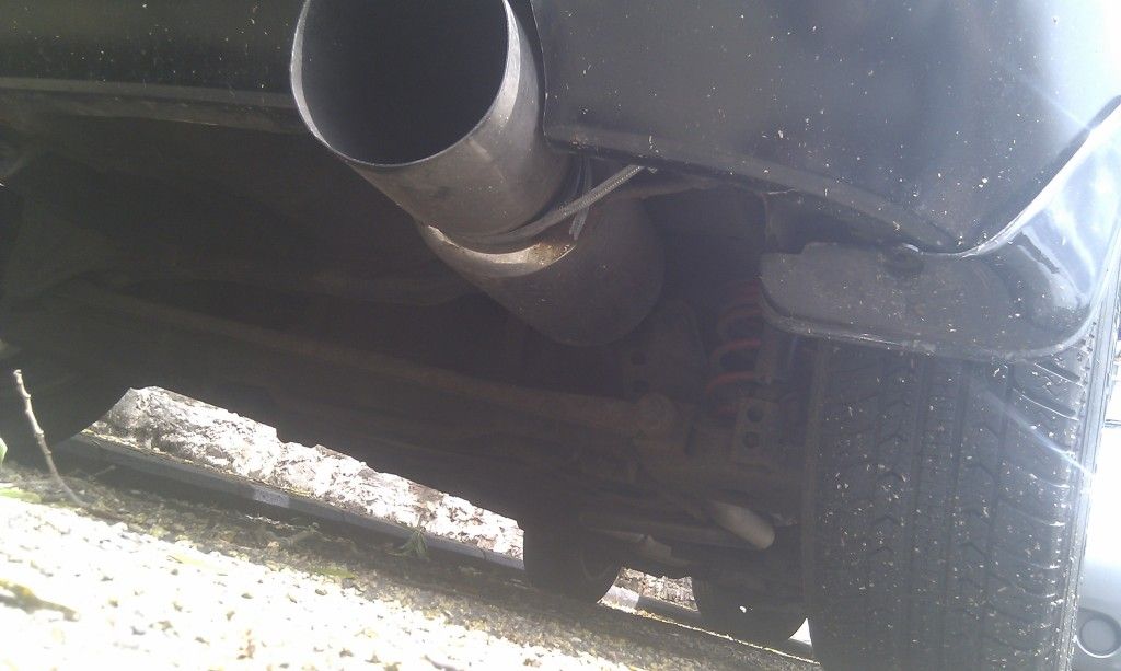

Ahh why thank you Guy, the exhaust is what gets me noticed ;) it wouldnt be my micra without it. Will upload pics of the beast. mwaahhahahahaa :p

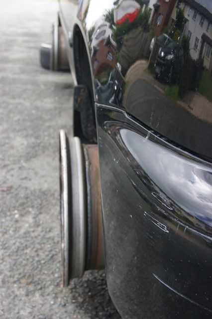

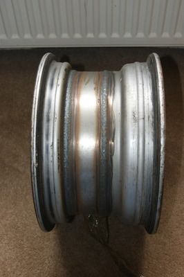

cheers guys. 7.5" front 8.5" rear. got poke tho :D http://www.alonzecustom.co.uk/ i'd really recommend this guy, based in north yorkshire, got my wheels back in a week of sending them. The wheels are faultless, just need to spray them now. Also remebering to spray over the welds with etch primer to prevent rust. I payed £225, sent my steels off £50 per wheel any width any size, this includes leak test, £25 to send wheels back. The also do sand blasting and maybe primer!

You can go as wide as you'd like. Standard steel width is 5.5". A member on here has gone 8.5 and 9" :eek:
I dont think 6.5" would be much difference.Youll be gaining an inch (wont have much dish)
7.5 and 8.5 would be good, but will more than likely need arch rolling if lowering. Anything above these you'd need arch rolling, negative camber etc to fit in the arch. Ps You would need stretch tyres for bandeds ohterwise tyre tread would outside and police wont like you lol :D
