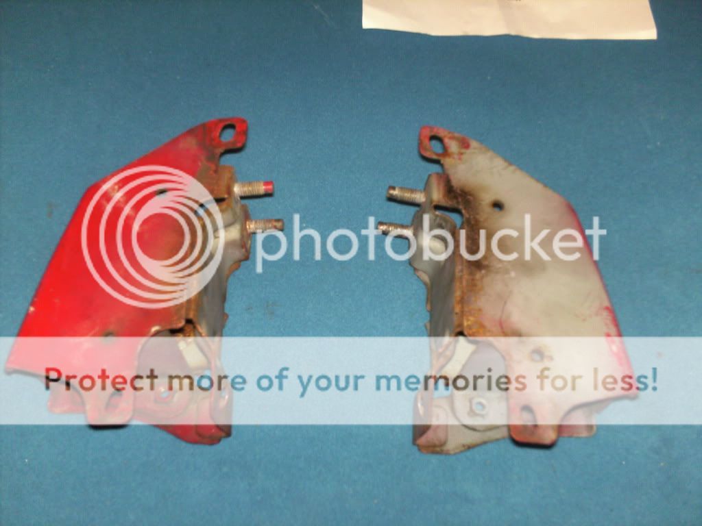

Regular pods won't be able to host foglight, you need to have the pod like the one on the right of the picture (even if there is written SR on the left one, those are regular):
Kennie I think you already had the Super S pods on you car, they are able to host regular bumpers and Super S bumpers, but regular pods can only host regular bumpers.
I've noticed that some K11 with painted regular bumpers and lot of options already had Super S brackets, but K11 with plastic bumpers and no options only had regular pods, maybe Nissan thought that people buying low cost Micra would never fit a Super S bumpers, like they did for the poor loom wiring of low cost models.

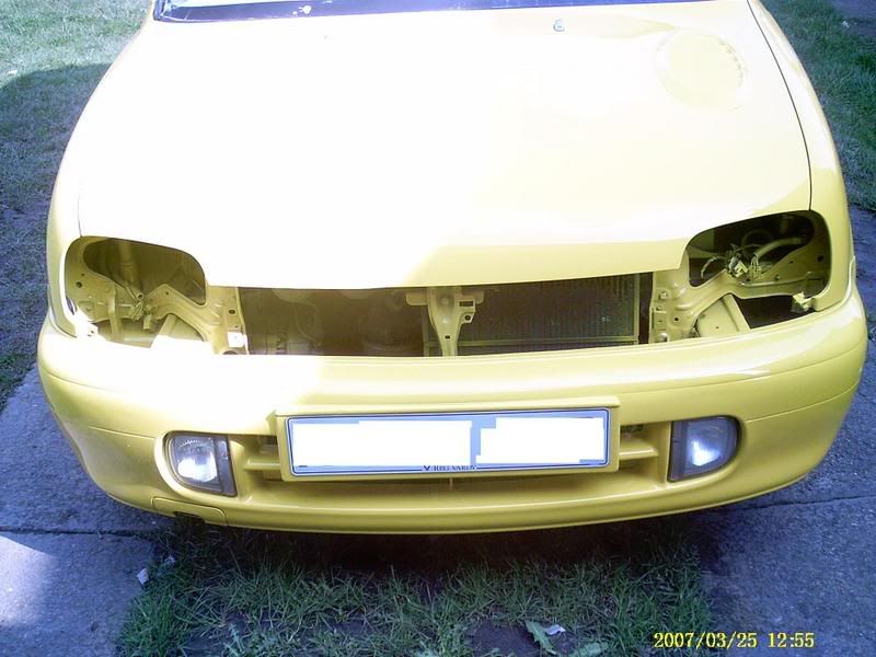

brackets arnt near spots there above so why the hole as I said I fitted bumper with black plastic bumper brackets overlap pics and see for your self, you can see in first pic the mounting holes and there above spots

Check your Super S bumpers, if you don't have those brackets, ask someone to chop regular brackets so they look like the one on the right on my picture
Hi seb, there are no brackets on my super s bumpers, the regular brackets would look like the one on the picture left hand side? what do i need to chop off? i can do it myself ive got the tools etc!

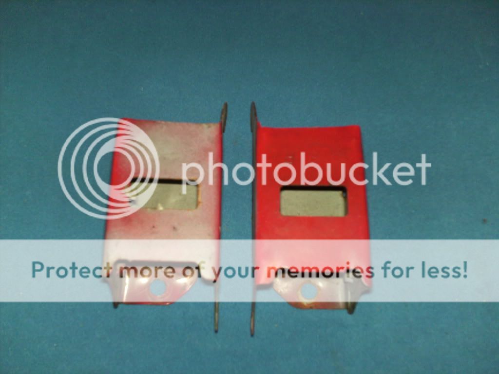

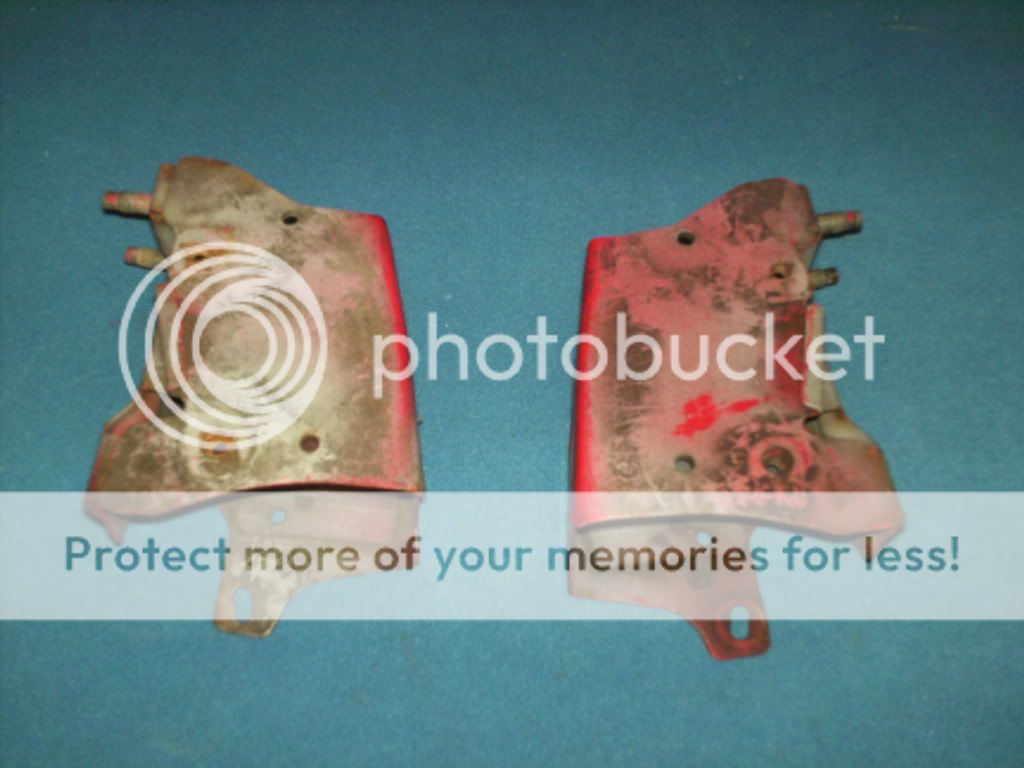

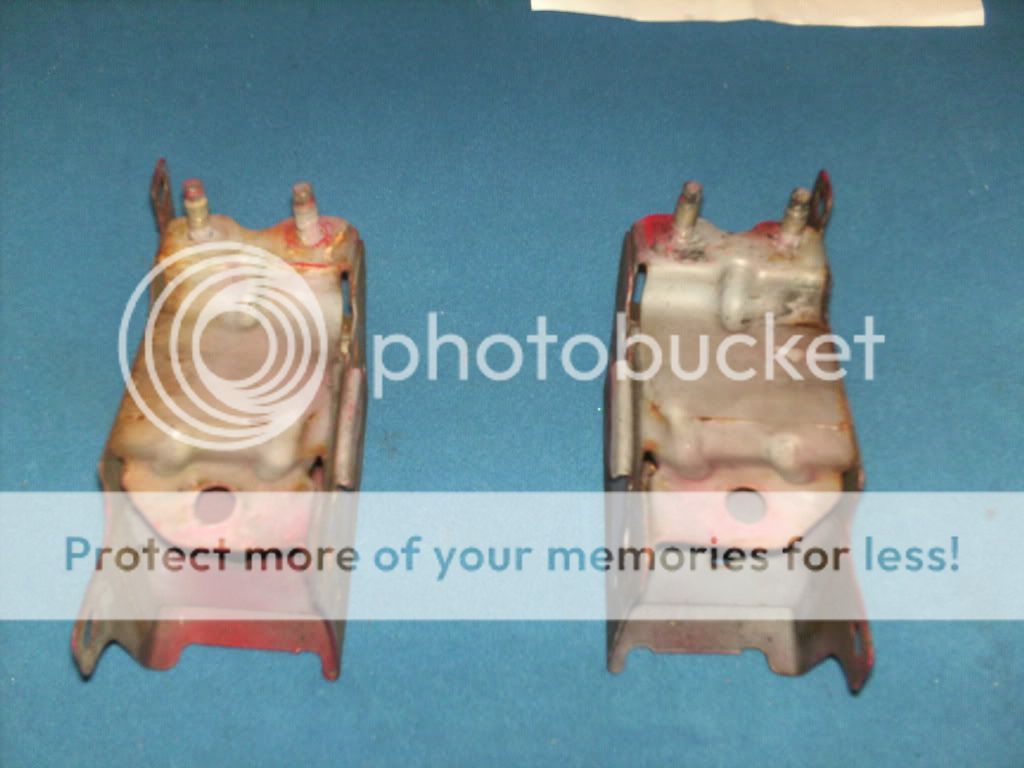

Below are X2 picture i tool today, if anyone could verify what brackets they are if that helps! - thanks
J

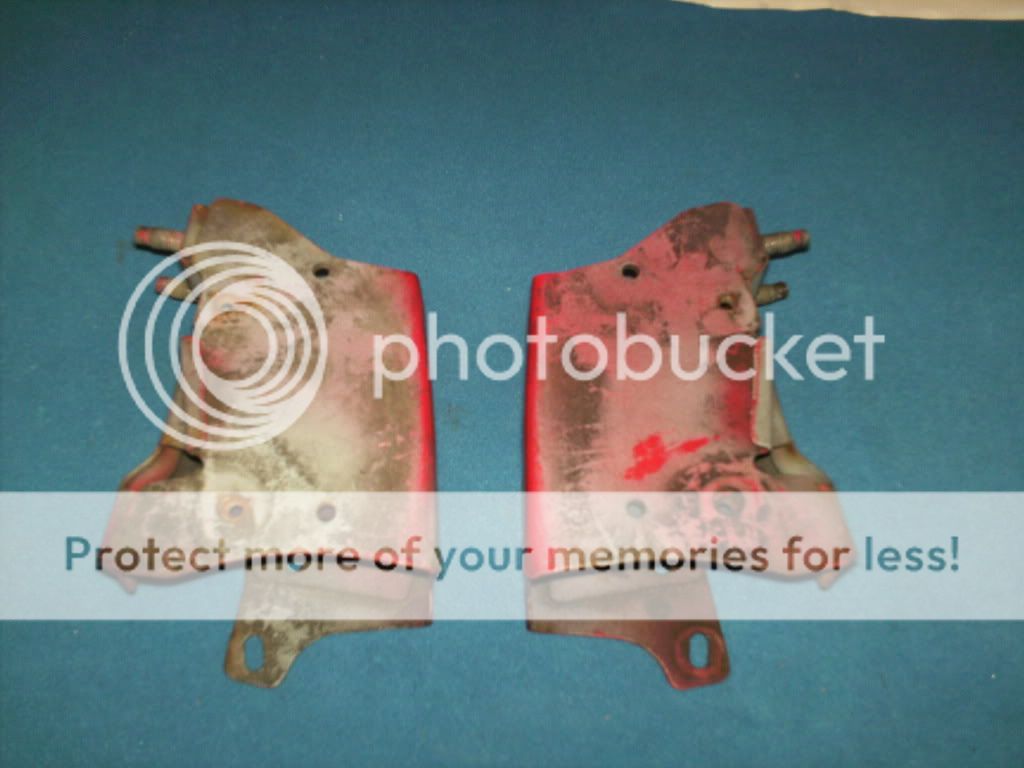

Just need to check before I sell you them, Are these super S brackets? they came off my 94 ss after my crash, when replacing the bumper. (they look rusty but I asure you its just discolouration.)
They look more like regular pods :
This is a big mistery, so as Kenny said, you fitted Super S front bumper with regular brackets... I can assure you in my case it was bloody impossible when I first tried, the bumper' plastic surrounding the back of fog lights were blocked by regular pods and bumper coudn't be pushed deeper.
thats weird eh? These are the original that came off my car, the new super s bumper from the scrappies came with a set already attached so i used them, much easier.
Eliot, after inspecting my Super S bumper last night and the shape of the brackets, i cant see the ones you have fitting! the ones in the picture Seb posted with the small cut out slightly half moon shape type is what fits around the foglight to fit snug and the one you have wont fit arounf the foglight so it will be hitting againts the foglight etc.... and my guess that its the same brackets i have on my car currently which is the ones ive posted aswell on this thread....
