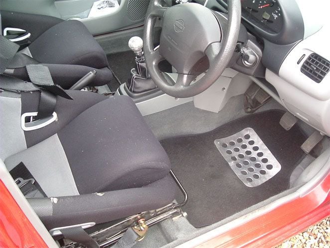

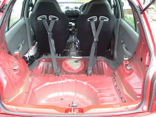

Heres my interior to compare it with:
I would leave the front carpet in. had it out in mine and it didn't make any difference ontop of having the back out. You can barely hear yourself think with nothing in!

@pjg1979: No the boot/back end is staying empty
