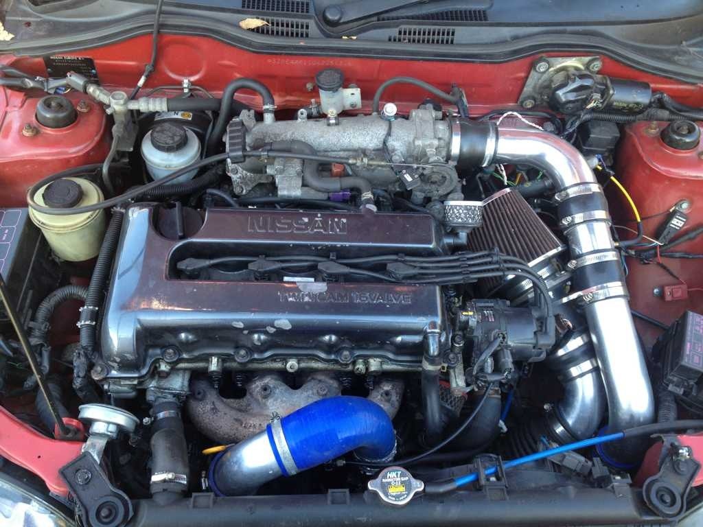

U can keep power steering my micra 2002 facelift has it with the sr20de engine turboed as well. Fits in snug! Check my thread for pics!

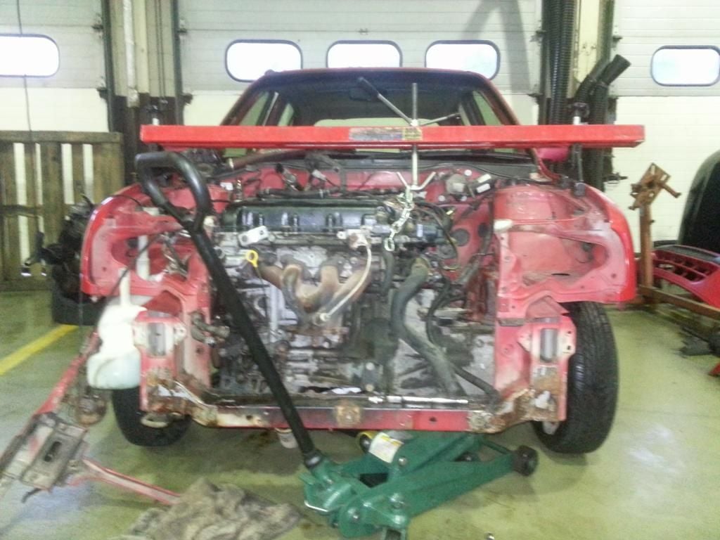

Good evening... well nearly.
I have the Sr lump positioned in the micra bay, ready to weld up the mounts tomorrow.
MY GOD IT'S TIGHT. I reckon I'll have 3mm clearance between chassis and pas pump. Any chance any of u guys could check the clearance on your so I canccheck. Also how much If any does the gearbox hang out of the chassis rail.
I will add photos tonight.
Ta Andy

When we fitted an sr20 the gearbox was near enough inline with the outer edge of the chassis leg, we also countersunk new bolts into the water pump pulley to give an extra 3-4mm clearance

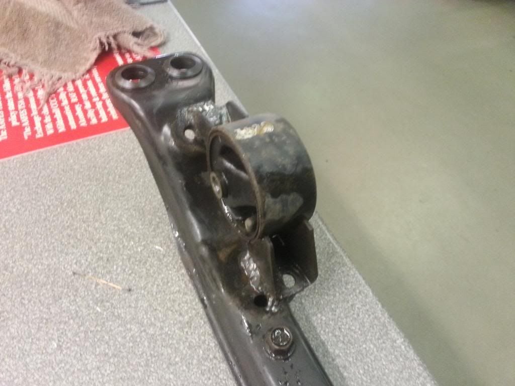

glen has some pic,s in his blog eh stani :) and here,s another of a g/box mount
I didn't do my engine conversion so couldn't comment but ill take a pic tomorrow of the mounts etc for u

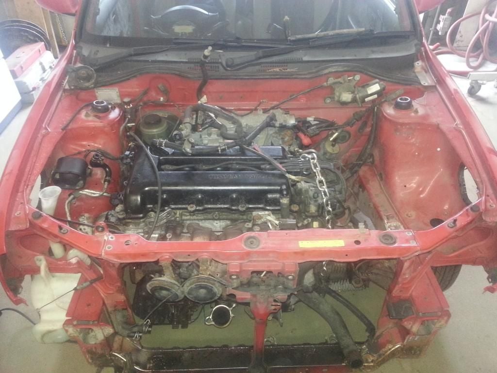

This is where I left it yesterday afternoon. Gonna do do a few hrs, my aim is to have the engine mounted and there x-member welded.

This is the rear engine mount, micra brace with almera mount welded on, this also allows the gear linkage to bolt up relatively easily by the looks of things.

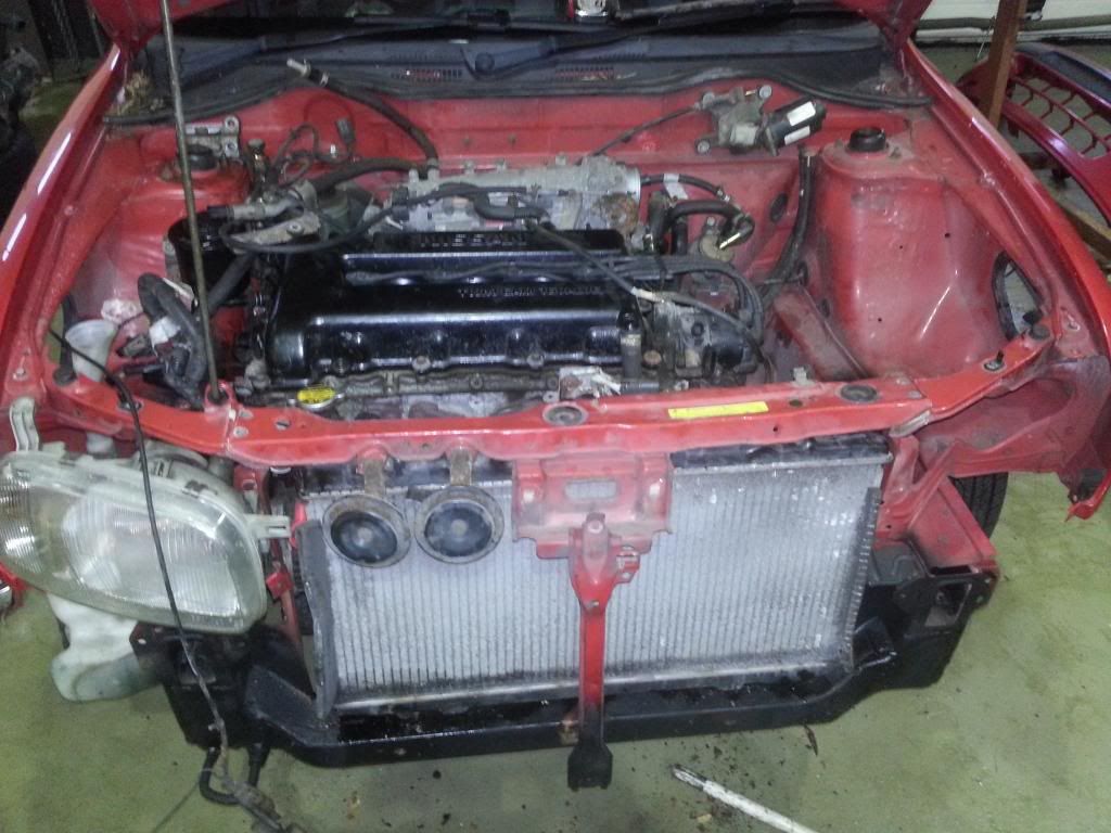

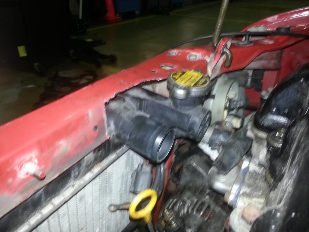

For the almera rad to fit I've put mounting holes in the crossmember and chopped a bit out of the slam panel. It fits snug with a bit of rubber matt for protection.
There is just enough room to fit the almera cooling fans on the outside, I'll just reverse the wiring.

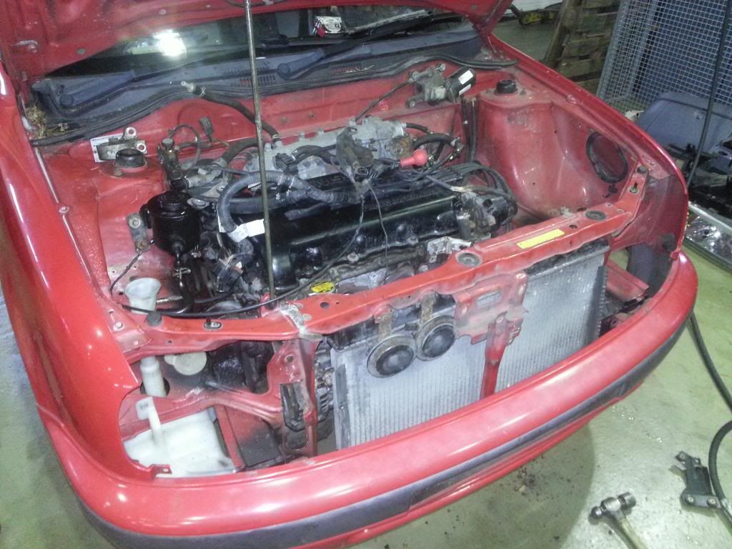

What rad is in yours? Mine has different mounts so not practical to mount any other way.

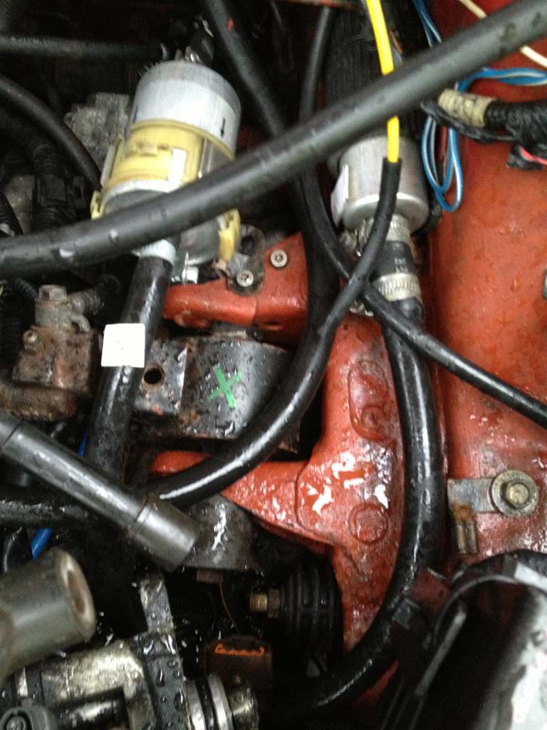

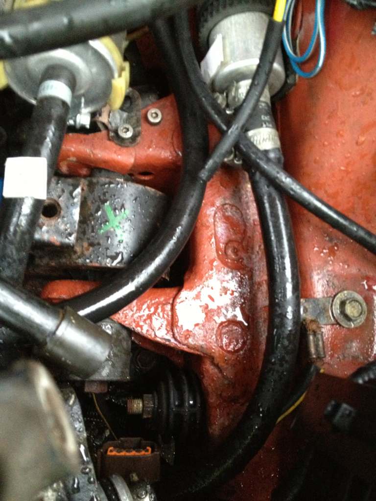

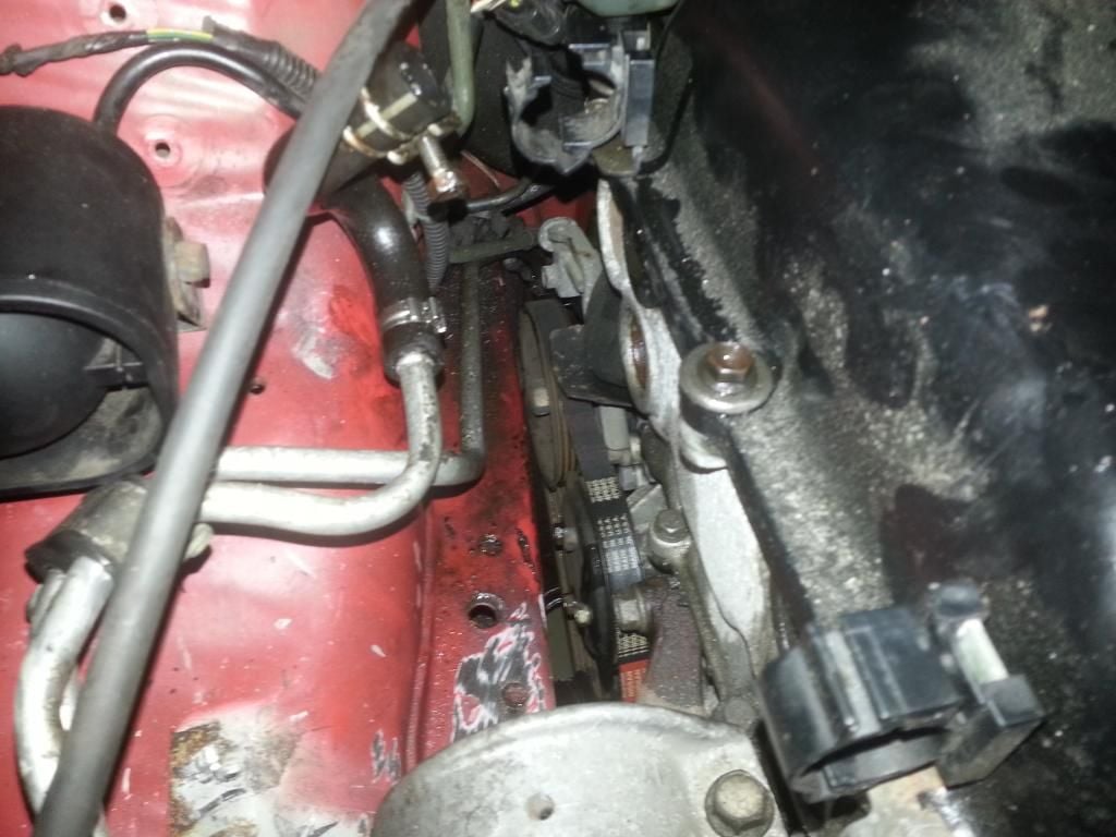

Could u take a pic of the power steering pipework connections/sensor above the brake servo please. I'm wondering what's micra/almera/custom.
Thanks.
Can get pics when I've been to the car again which will be New Year's Day. But I have this pic.
It's the yellow looking thing on left of engine bay.
As far as I know the radiator is a Almera Gti one
A little progress today... got the pas all hooked up, I cut the female connector from the high pressure line, swapped to an almera male fitting, flared the pipework and connected up perfect.
Also found a suitable tight belt for the alternator 4pk838.
Andy_s ive looked into it im pretty sure u have a primera rad.
Ok brill I wasn't sure u see. Ill measure it next time I with the car

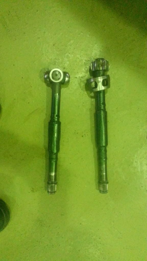

Yep gonna lathe a peg on 1 half, and hole in other em so I can press the shafts together (interference fit) and know they will be straight. Then weld and sleeve them.
Id like proper shafts but as ive invested peanuts into this project I dont wanna spend £€$. Trying to do as cheap as poss by doing everthing myself.
should be fine for N/A eh :) i do something similar with our stub axles at work, and i grind a slot down the sleeve and fill that with weld too
[quote"frank, post: 562848, member: 4874"]should be fine for N/A eh :) i do something similar with our stub axles at work, and i grind a slot down the sleeve and fill that with weld too[/quote]
Good Idea I was thinking maybe a slot or drill some holes and pool some weld in there. I may get a mate to weld that for me as his welder is industrial... mine isnt :-(

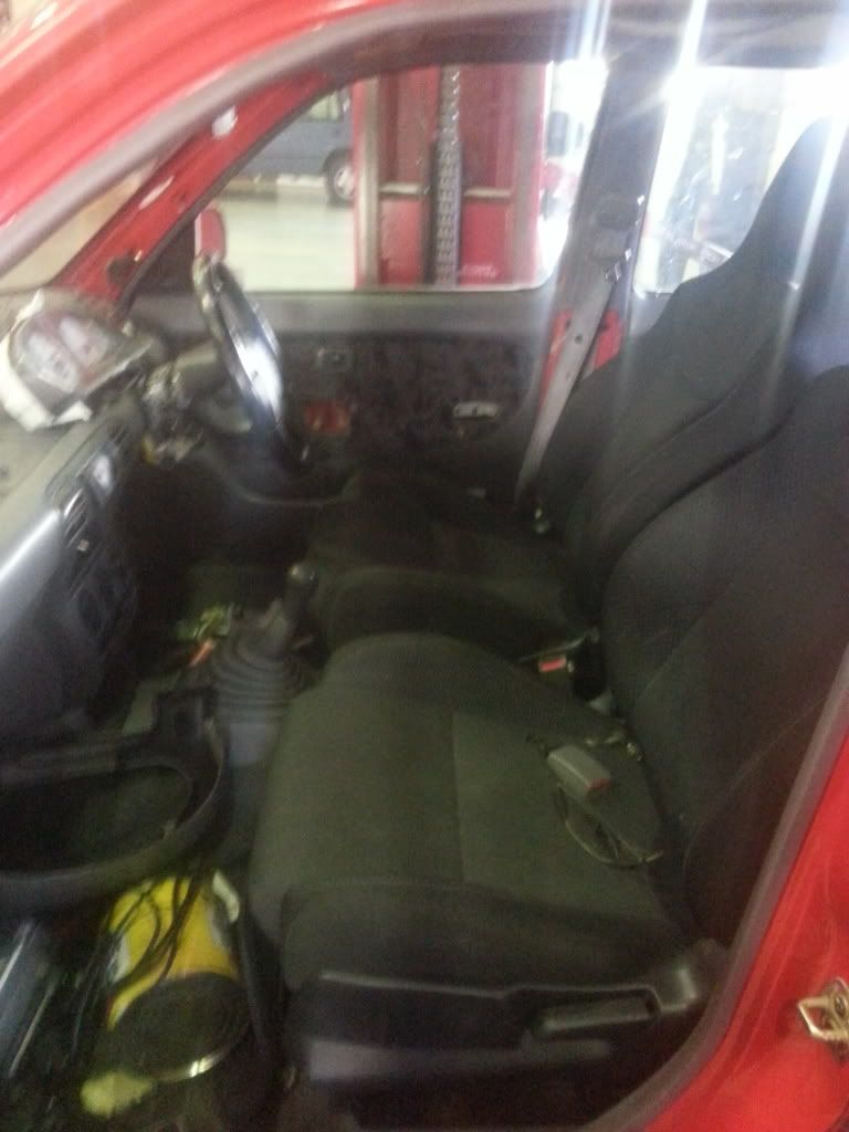

5, 03 imprza seats moddes, welded to subframes and fitted to car, a little higher than stock but all good.

I dont see how those shafts will last as when i drove mine it seems really torqy surly they would rip in two
To be honest..... I dont know yet, will have to see. I sleeved them with hardened steel tube then slotted the tube and filled the groove with weld. Im confident welding. I intend to make a spare set in case any problems. I had a little drive again today done a couple of standing starts to test..... so far so good.
If they work then great... I can say that I done everything myself and it cost peanuts.
