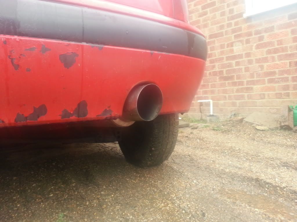

Invidia N1 exhaust silencer, and car mascot. I know I need a grille and repaint my bumpers.
