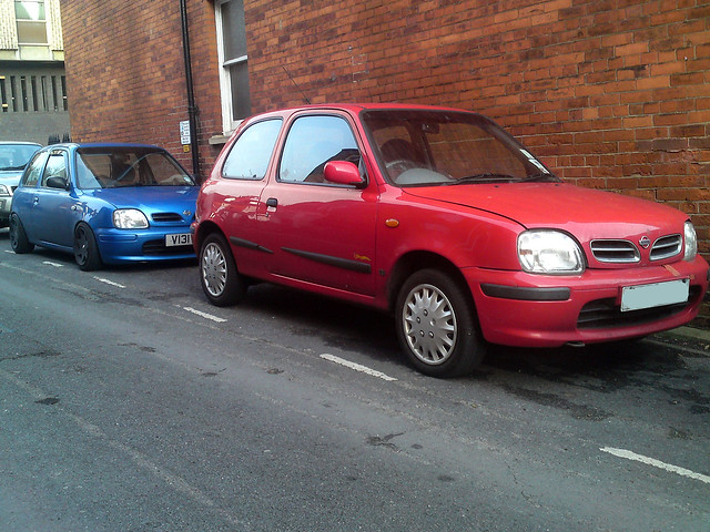

With cheap and nasty Corsa coilovers, 1" from highest setting, cut springs on rear.
F: 20.7" 185/50/13 on Franks Steels 13x6.5
R: 21" 165/65/13 on Franks Steels 13x6.5
Use to be like this:
Same Corsa coilovers, 1" from lowest setting, cut springs on rear.
F: 18" 165/55/13 on Ford Capri Brooklands 13x7
R: 18.5" 165.55/13 on Ford Capri Brooklands 13x7

Finally got round to putting something in here. I'm pleased that I'm not too far out of the "game".
520mm (20 1/2") front.
510mm (20") rear
7x13 Et0 165/55 R13
I still has some of the stock springs left, and OEM shocks. Rears have a frank spec reduced travel mod to ensure that the rears stay seated. Fronts are wired.
