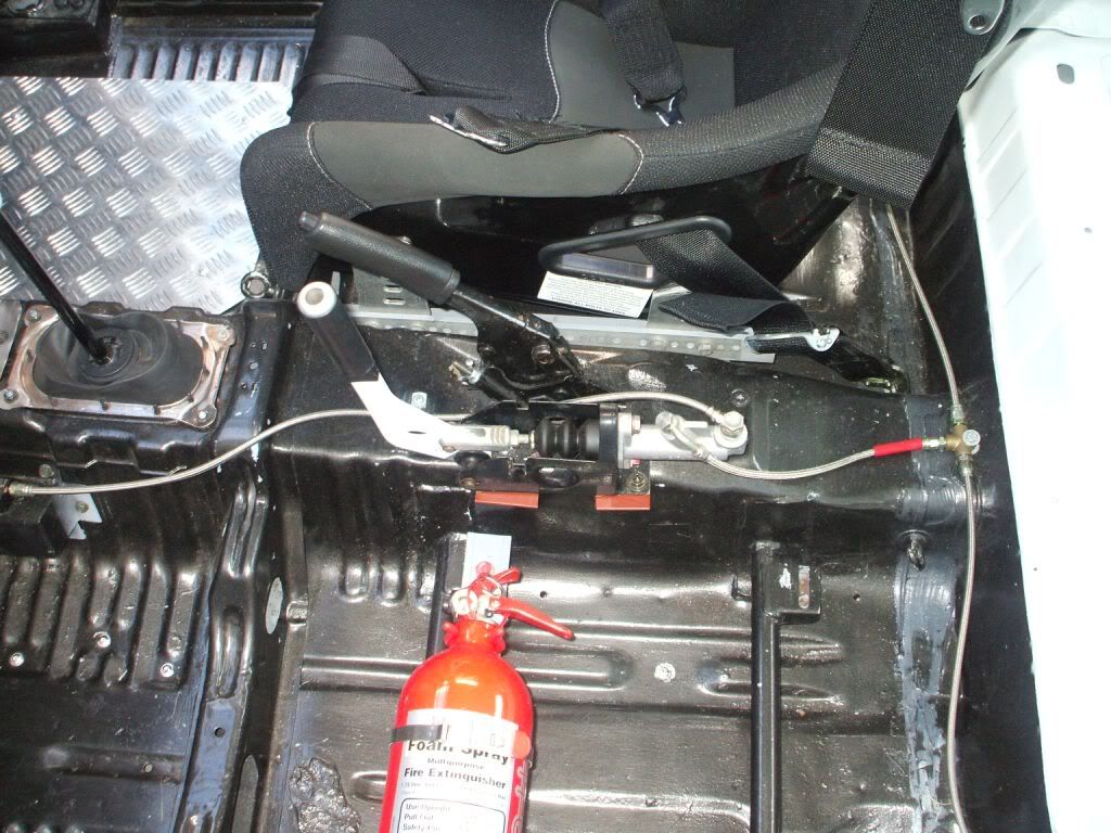

New disc handbrake cables arrived today :) Next up taking the old drum beam off & painting & fitting the stregthend disc beam and pressing in nismo bushes to the trailing arms............
More than likely in the rain!

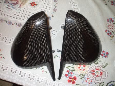

Just been to pick up some carbon mirrors :) only 2 or 3 pairs ever made to date (Y)
*cough-cough........Rallytech ;)

You got it in one Low :) http://rallytech.co.uk/index.php/products/formula-1000-parts/120
One of their guys is doing a rally here tomorrow so i got them off him today... xmas prezzie from the gf!

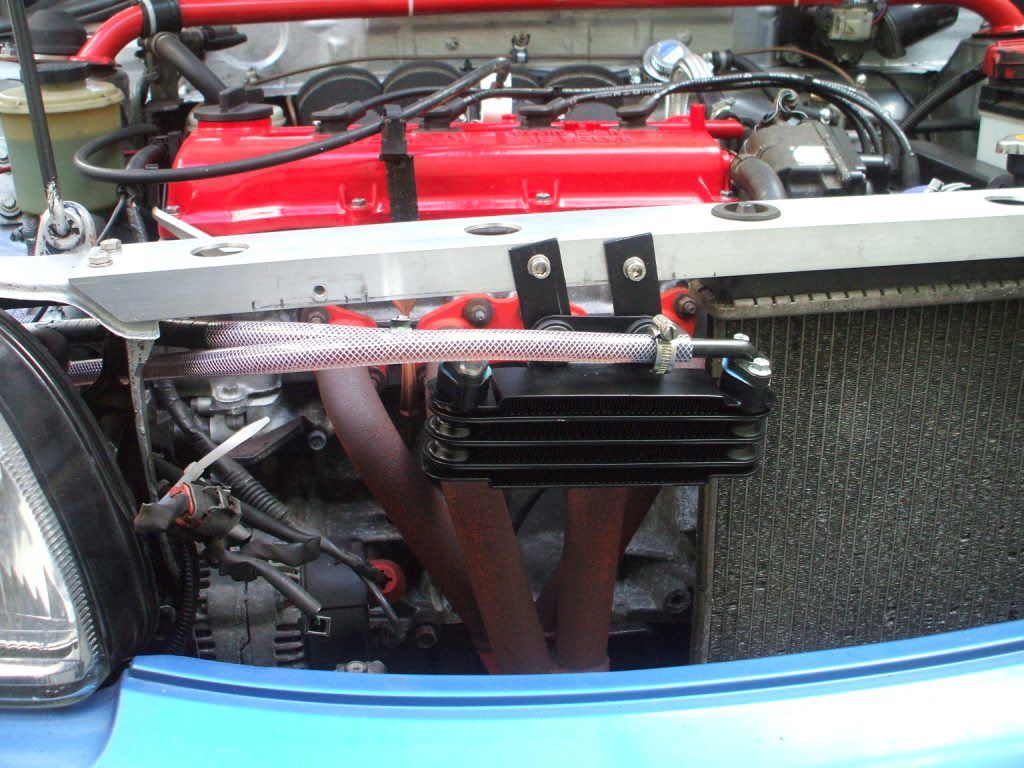

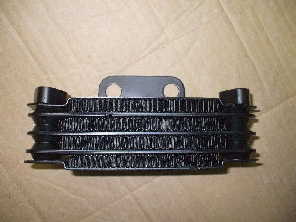

Also as the powersteering cooler pipes have seen better days iv got hold of a suzuki bandit oil cooler to use instead... plan is just to run two fittings from the top to the P/S tank & the rail itself...

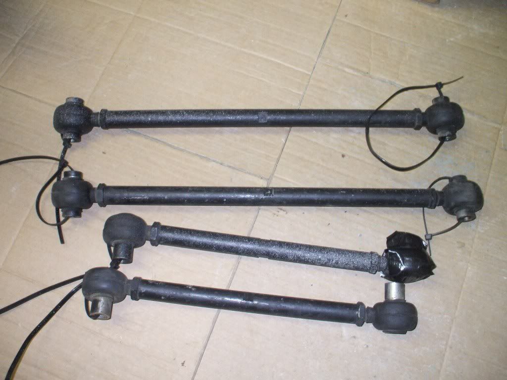

hopefully the rosejointed links have a bit of "give" eh ? iirc one of the rally guys fitted some and the rear suspension locked up :eek:
Thats just it Frank need a bit of movement, they have tapered cups either side that have a shamfer down to the joint itself to allow as much rotation as it can get so hopefully that & some copper grease will keep all well (Y)
(Y) its just the geometry of the arms eh, they said that the rear would lower down so far then the links got to a point where they were pushing against each other and locked any further movement
(i think theirs were solid rosejoints tho)

Thats a bit drastic eh! Wouldnt want that happening on the manx lanes!! I had an idea to use a strap on the rear axel to stop the rear springs coming out of the cups if the car ever gets airborne so maybe i could kill two birds with the one stone & guard against the link arms locking out... thanks for letting me know Frank (Y)

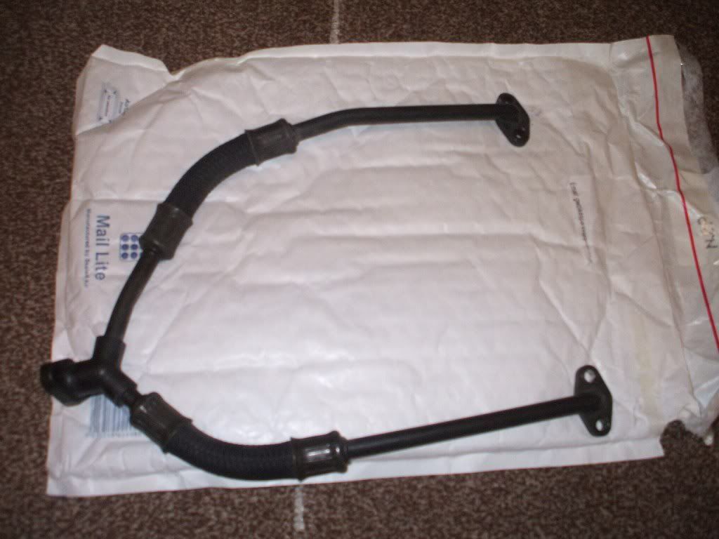

After an awesome visit to the Autosport show i arrived back to find the Suzuki oil (soon to be powersteering) pipes after a lil chopping and changing:

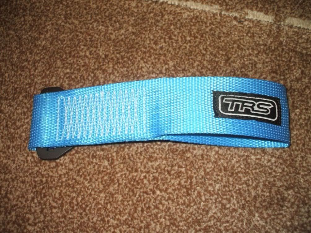

Pickedup up a new to hook at the show as well (nearly matches the car):

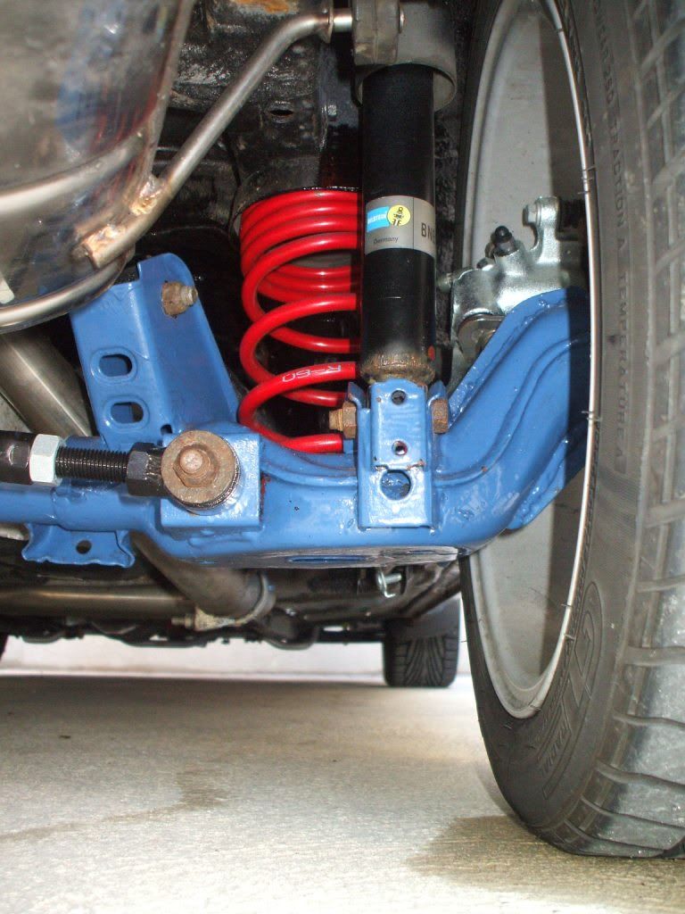

Finally got the back disc beam all assembled, all pads & discs bedding in nicely now :)
Swapped to braided brake lines over the new year whilst the back end was appart. Once you have the nac making the lines is is quite enjoyable! Plumbed the handbrake this way as well
Round the front end the standard powersteering cooler was tired & corroded so the Suzuki oil lines were cut, cleaned & new braided pipe was installed (went with clear so i could see and trapped bubble's) all seem to be working well
Also a small oil catch tank has gone in mounted to the original fuel filter point. Fuel filter has been relocated to behind the battery & the piping for the carbs re done as i wasnt happy with the first attempt!

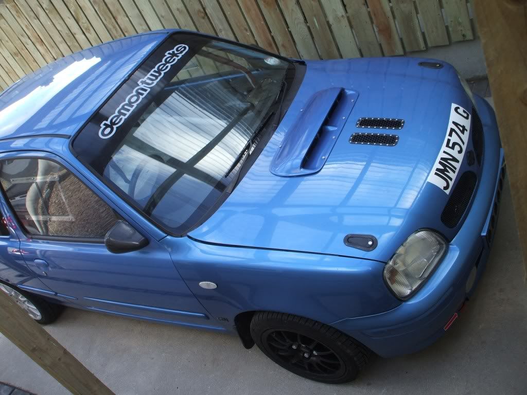

Finally a scoop has gone onto to get some cooler air into the path of those carbs though iv read they can be more effective the other way around :)
