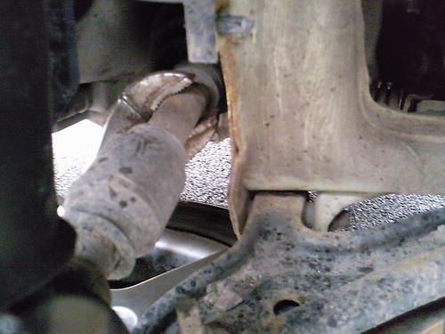

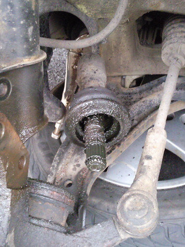

After reading a few posts on popping the driveshaft out of the CV cage I decided on clamping some grips up against the shoulder on the shaft, putting a length of wood against them and hitting it with the hammer. If i'd had a steel bar i'd have used that but anyway on the second strike it popped out of its groove. Just about the easiest part of the whole job!
Undoing the hub nut was frustrating because I decided earlier I didn't need a breaker bar (see, lack of planning) and all I had was a socket set with a small t-bar. I had no steel yube I could put over it for more leverage. I set my torque wrench to 300nm and hoped the nut would give before the wrench clicked..I didn't want to damage it, it's brand new. The nut gave just as the wrench clicked thankfully.
So the joint came out easily after that and I took it off to the motor factors to exchange for the replacement. And that's where i'm at now. Tomorrow morning i'll put the new one in and hopefully that'll be simple. Hopefully. (Y)

I filled the new CV with the grease supplied and had the driveshaft cleaned up and the new circlip fitted. By the time i'd tried lining the shaft up with the cage a few times there was so much grease on the shaft I couldn't even tell if the circlip was still there (it was)!
Once I'd lined them up as best I could and could feel the splines meshing I pulled the driveshaft towards the CV as hard as I could while hitting the old nut which I'd screwed onto the CV just above the threads. Again it took a couple of knocks and it popped in.
Also, I had to cover the CV while manhandling the hub/strut back together so as not to let any crap fall into the new grease. This was before I could line up the above so I had to work from below. God it sounds so complicated now but I was paranoid about getting crap in the new joint.
