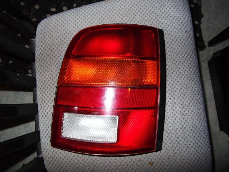

Took a trip over to Mark's house today, picked up my LHD rear light for some symmetry and a go in his car and wow. I am gonna be cutting my springs soon i think,
Very nice and firm but definately not uncomfortable. Completely sold me on the idea of cutting now so we shall see how that goes and fingers crossed will have my new rear light sorted out soon too!

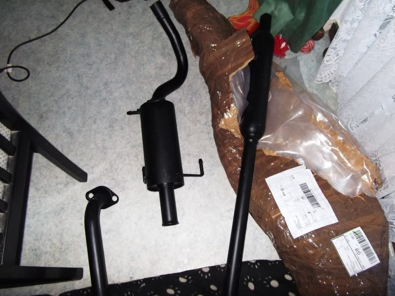

Well Well Well...
Look what turned up just now on a Sunday morning!
After a lot of fighting with the packaging:
Well now, that gives me something to do today as well as my rear light (Y)
Just need gaskets and possibly some bolts :(

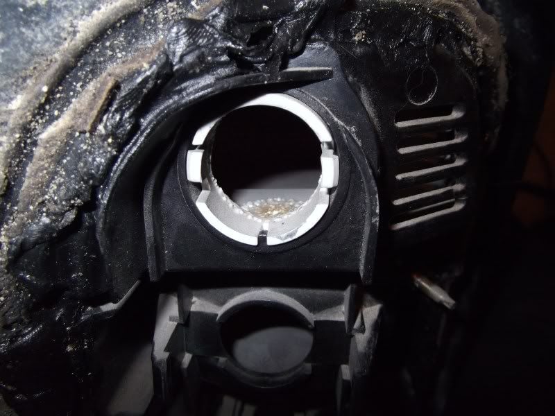

Didnt noticed on those melted parts, i have another light, but has a crack, and the ones installed on the SR are even worst...
Not to worry baguete the light is fine i tested it and all the bulbs work fine. I just don't understand how it melted the plastic.
i will try the method of heating it up and pushing it back to normal from the inside otherise i won't bother. the reverse light section works with the fog light wiring no problem so just need to find a replacement red bulb.

the head/mani gaskets often survive shaun, if not i always use paste instead tbh :grinning:
haha took me almost an hour to fight through that packing but your's looks worse than mine, bet you had fun
hey wait i just noticed you jammy sod mine didn't come in a plastic bag grr grr
Errr.... Sorry? lol it has a few scrathes down it in places (expected) and one of the ends resembles more of a square than a circle, but should be fine.
yeah it should be good although you may need to trim the metal down a little to stop it knocking and hopefully it'll be as snug a fit as mine was so no horrible looking exhaust paste
Yeah no exhaust paste needed as it's clamps :) you remember what size you needed so i can pop to halfords and get some without having to use a tape measure (lazy)
Would i have to trim it Frank/Karl? and maybes for a size is just not good enough :p

:laugh: i don't think i've never known him to be wrong. Well fingers crossed for clamps today then it can go on!
shaun i'd say yes but test fit it first... i should of realized that it'd need trimming when we fought with it to get it on

it was only 25mm off the backend of the midpipe shaun, but i would try yours up first, maybe there was something snagging karls downpipe to midpipe joint and it had,nt gone fully in ?
True. Well i will test fit everything and then once i'm finished with that 'Frankspeed' mani i'll get that on too!
personally, i would hacksaw the downpipe then take the easy headnuts off and lift the whole mani/cat/offcut out shaun (then you can get to, and lube the rusted cat bolts and nuts)
then the rest should be straight forward :grinning:
Good thinking batman i took the downpipe off recently though when we changed the oil sump. So it shouldn't be too difficult, only time will tell :D

ahh, no probs then :grinning: the 2nd cat nuts usually rust up the worse than any other, but just cut one of the pipes and bin it eh
Well my exhaust snapped after the cat before the backbox. So also should be able to take it all off in one go after i undo the downpipe :p
just the front a/r/b that hinders you eh shaun (one of the reasons mine has none)
