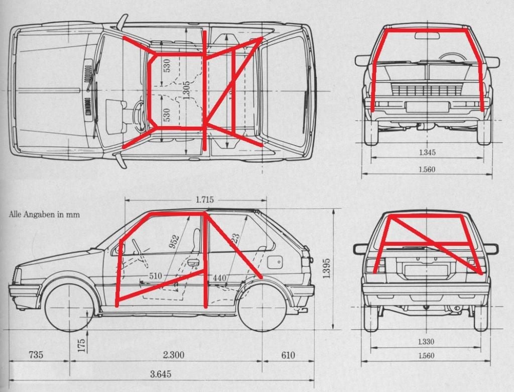

Hey Andy its been awhile but its finally time for me to think about that cage. I've notice I get a bit of chassis twist maybe from how stiff the coilovers are (interior light keeps turning on around corner etc) and I think its time the chassis could do with some stiffening. What do you say?
Game on?
Something along these lines. Let me know if I've done something wrong or it needs extra
I didn't want the x-bar at the door as this will be a daily car, and I thought it would be easier if the cage went around the dash, rather than through it. But you have more experience with this stuff, so I'd let you tell me whats best :D
Also you got any pictures of the cages you've already done?
