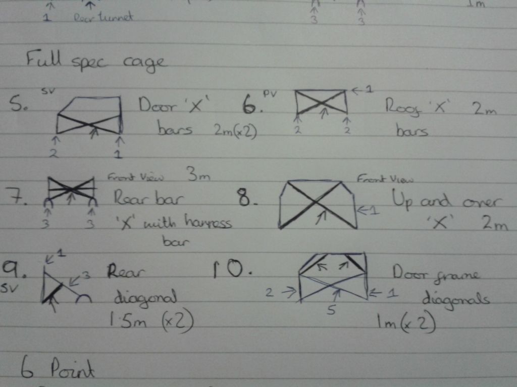

Full spec is the above plus:
5. Door x bars
6. Roof x bar
7. Rear leg x bar with harness bars (what you're showing me)
8. Up and over hoop x bar
9. Diagonal between up and over and rear turret bar
10. Two diagonals in 'door frame'.. 1 joining first bend to top of x bars 2 to join up and over hoop lower down to a bar further along

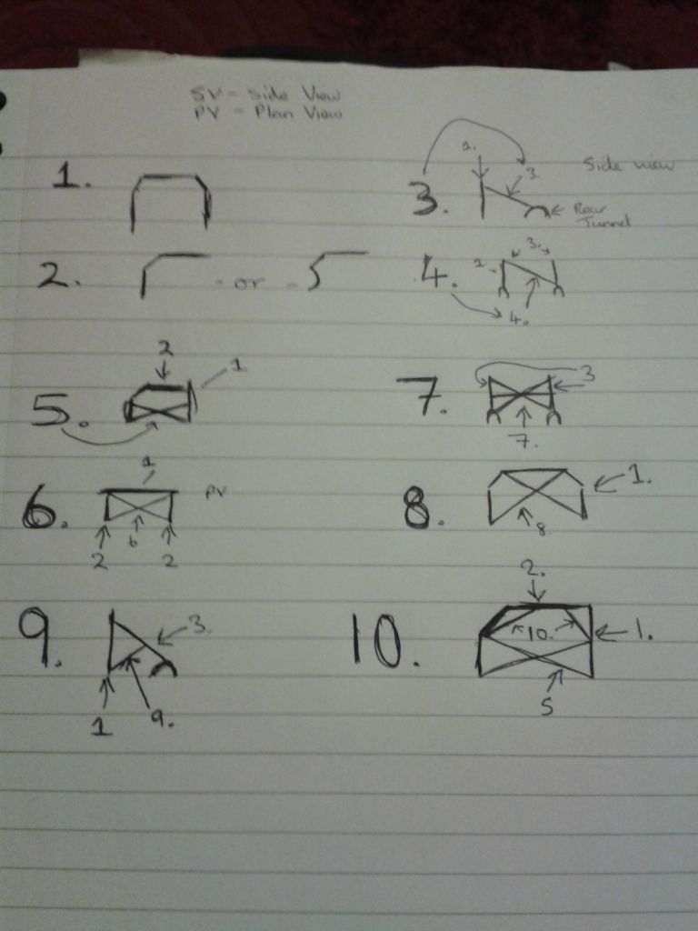

Done a quick sketch
Will do a proper one soon
That's fair enough mateu but that's all standard blue book stuff /fia spec. I mock all cages for people out of cardboard first :)
Ah right ok. Yeah I think theres only one thing is the x-bar at the door. would be a pain to get in and out daily. I was thinking for a single angled bar like 30degrees or something, if you get what i mean

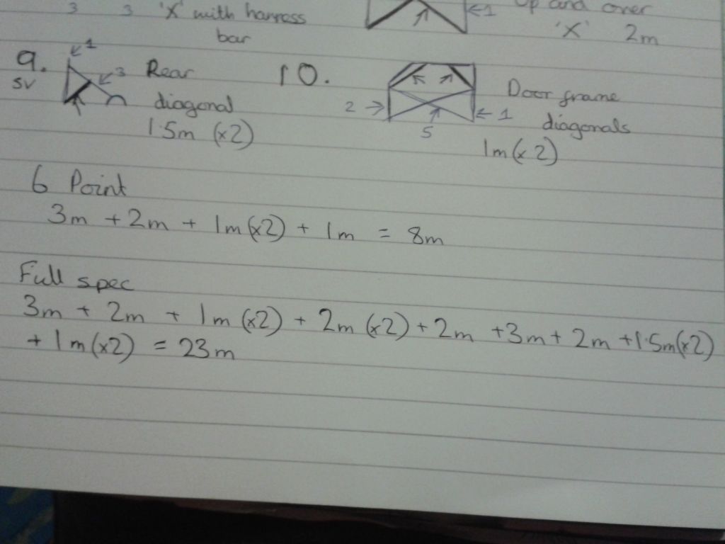

Sketches for 6 point, full spec and measurements. Estimated measurements on each part :)
Got an itemised price list. Works out a bit more expensive but at least you only get what you want. (x2) means you need two :) dont forget to add material costs too

I welcome your opinions on these. Based it on difficulty to make and do
Always open to custom suggestions :)
