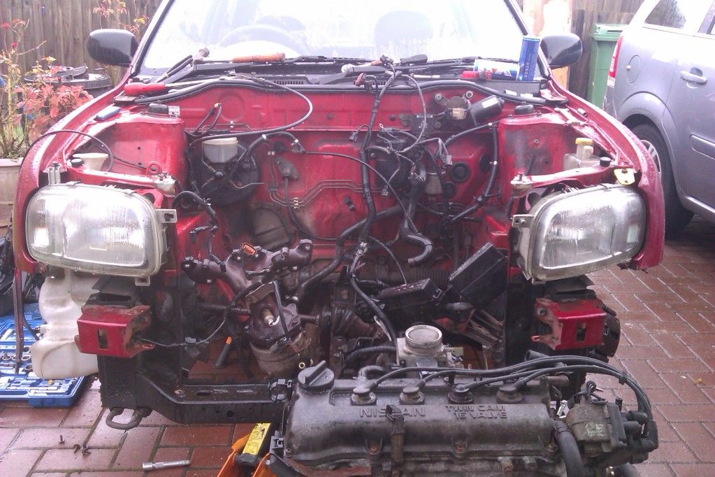

right guys i no im a pain in the ass but please please please help me with my engine :(
i did a cg13cvt transplant to day and its all going wrong :/
engines in gear box is on :) but its stuck in ither 4th or 2nd :/ really can not get it out! :/

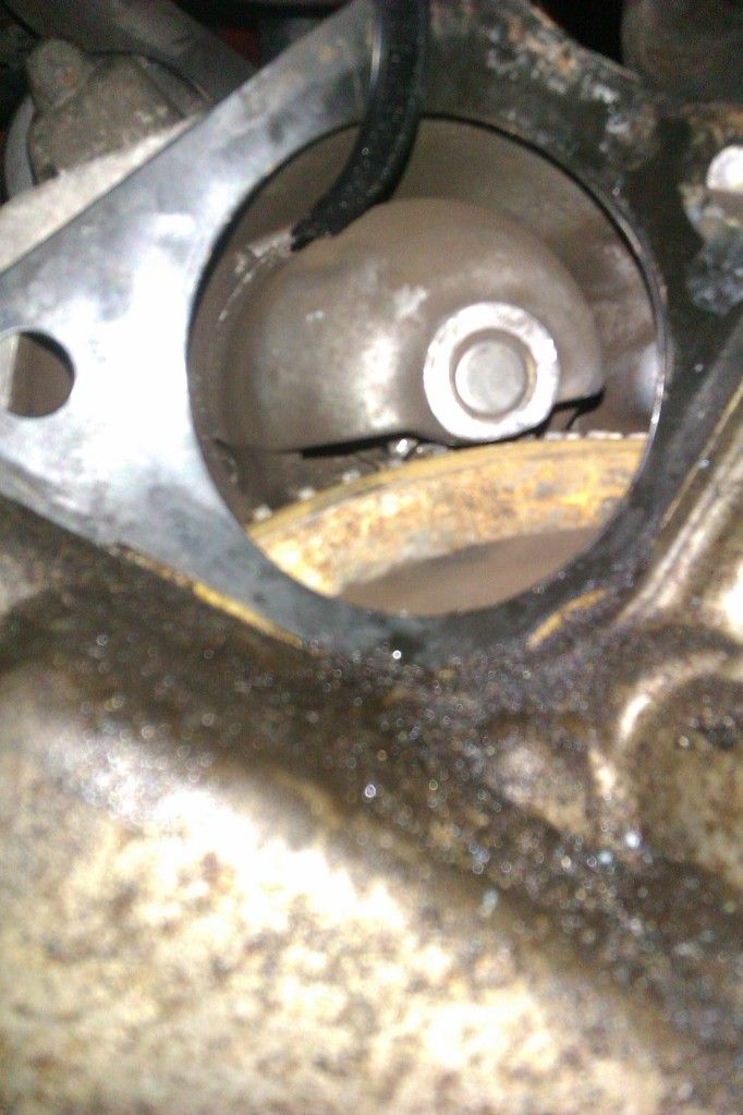

theres no backing to the flywheel/startmotor just a hole :/
have no idea what gose where :/ im stressing to hell! i NEED my car friday ive had to book off work coz its not done =[
nothing seems to line up :/ i thought it was just a strate swap :/
please please please help me =[
i live near cardiff if someone wants to offer there help who knows what there doing :/
its just the rear g/box bracket leon ,pain in the arse :D sounds like the 3 bolts hav,nt gone though the bracket properly (jack the diff up to tilt the engine)

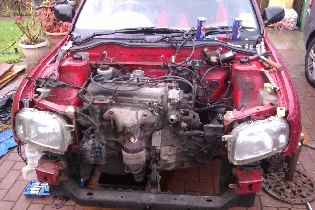

the last pic shows the rad tophose upper left, and heater hose upper right, and lower rad hose lower right.
and the only 2 plugs you can confuse is the smaller dizzy one and the coolant sensor one (all the others will only fit 1 connector)

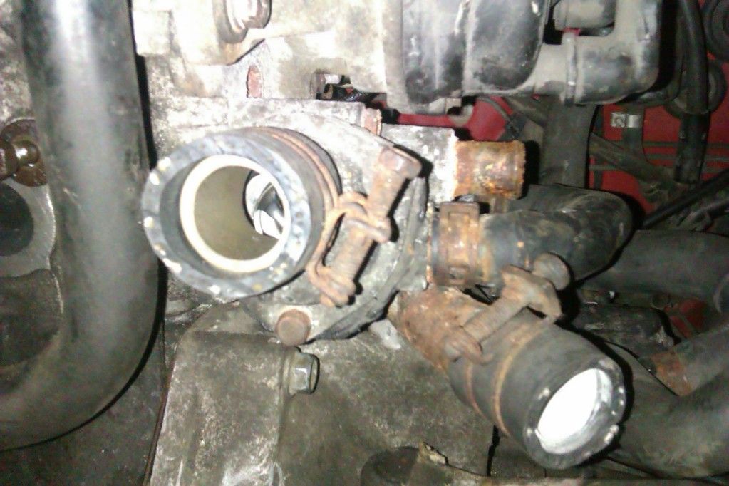

Picture 3- there the injectors/throttle body/dizzy/coolant temp/earths

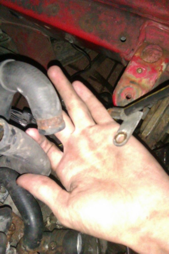

Picture 4- From what i can make out the 2 pipes are for the heater matrix which connect up to the left hand of the carbon cannister, the pipe that come from the back of the engine goes to the bottom and the other the top. The wire in the pic is the earth strap it bolts right where you can see above it and the other end bolts onto one of the starter bolt on the gearbox
Picture 5- the upper pipe is an S shaped one and goes to the top of the radiator, the other is a longer S shaped pipe and connects to the bottom of the radiator

that rear bracket is bolted by 2 short lower bolts and 1 of the 4 bellhousing bolts leon, you need ALL 3 bolts in
bbbbboooooooooosssshhhhh!!!!!its aliveeee!!!!:)and my oh my its quick!!!!!:)i love it hehe and the metal plate behind the flywheel i swapped it over then gear box wouldnt go on mate :/soon as i swapped back sliped strate on :/, ganna make up some blanking plates :),
