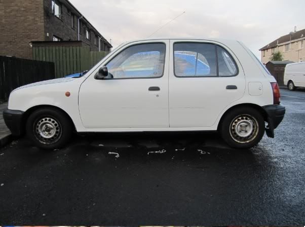

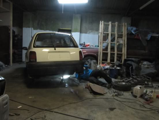

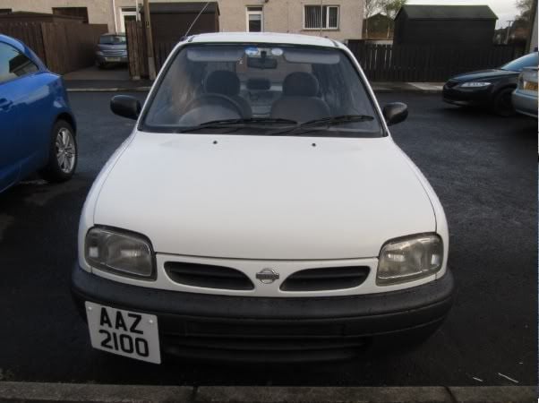

So…October 2011 I purchased my lovely Micra. A nice off white (no idea what colour code, looked like a 1980’s fridge though).

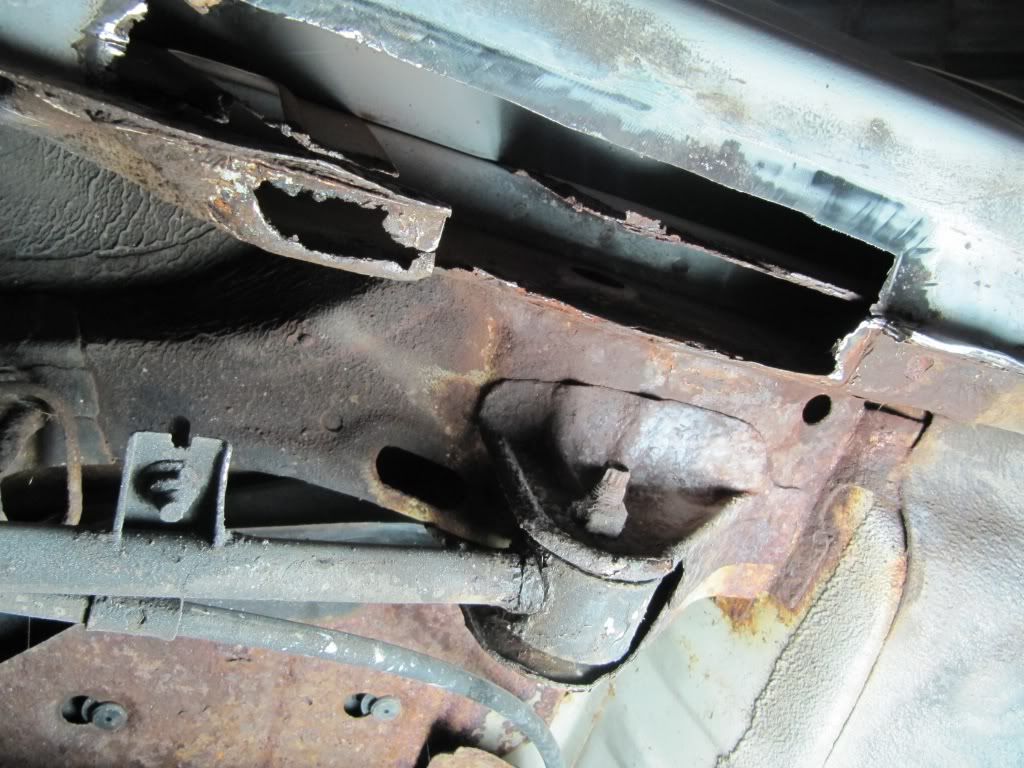

Upon general inspection it wouldn’t start or run (did take a jump start though). It had a hole so big in the sill I was considering installing stairs through it into the cabin. Also needed 2 CV joints, unless something had got in through that massive hole and was knocking furiously at my harsh cornering. On the plus side - new crossmember though, so I was happy at that.
Step 1: Buy Micra. Nissan Micra Shape. (Poverty Pack by the looks of it!) Total Cost: £80

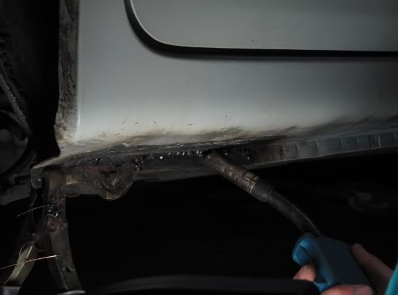

Step 3: Rust. :(

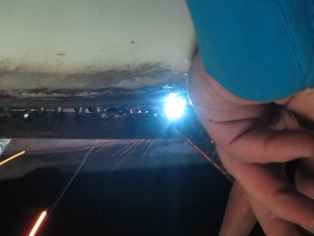

Step 3a: Cut the rust out. Ouch!

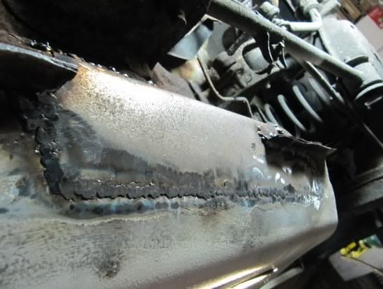

Step 3b: Cut some pieces of plate, roughly the same size is fine. :D

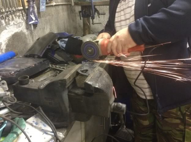

Step 3c: Weld & Grind - Repeat.
Step 3d: Isopon and Paint!

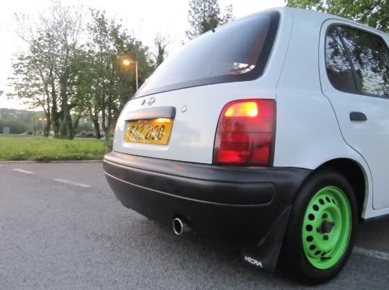

Step 5: Lowered - Daewoo Matiz Rears and Corsa B Shocks. [Thanks go to Frank] Total Cost: £40
Step 6: MOT'd Total Cost: £37.50 (Ridiculous!)
Step 7: Number Plate Relocated to OffSide. (My Black Mazda 6 hiding there too!) Total Cost: £10
Step 8: Backbox Removed - Slightly larger tail piece. Total Cost: £20
Step 9: Green Wheels! Kawasaki Green and a Brush! :D

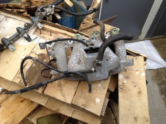

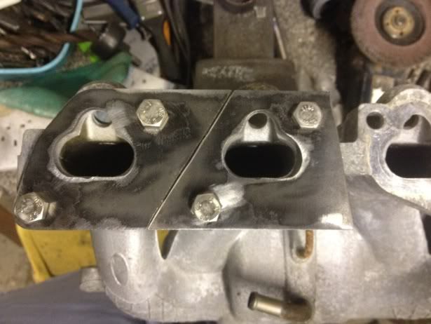

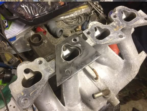

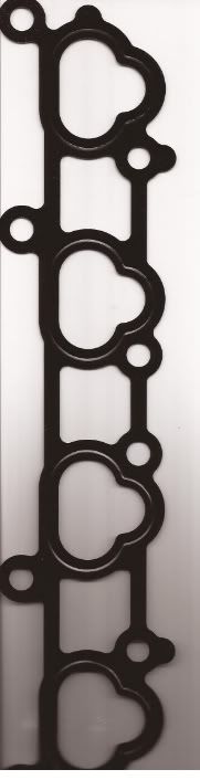

Step 10b: Buy and Scan Inlet Manifold Gasket. Total Cost: £1

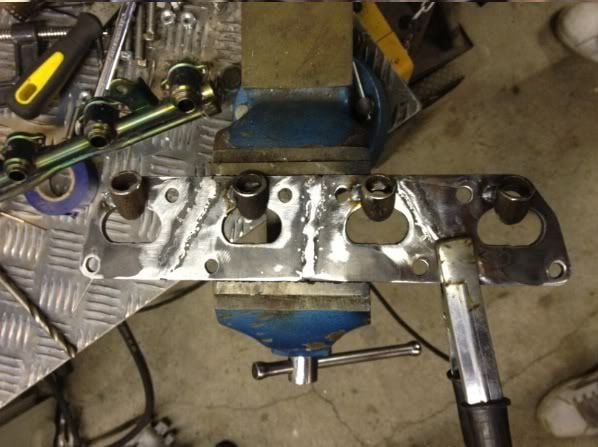

Step 10c: Convert to DXF in Adobe.
Step 10d: Laser Cut flange. Total Cost: £10
Step 10e: Make "minor" adjustments due to ID10T error lol.

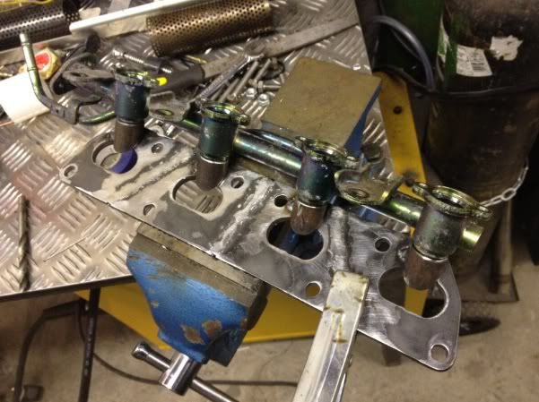

Step 10f: Respace, cut and weld. Boo. :( Not too concerned about inner lip as pipe will fit in here and be filled with nice smooth weld.
Step 10g: Tack 10mm holes for injectors, checking spacing issues caused by any warping. Nice fit though!

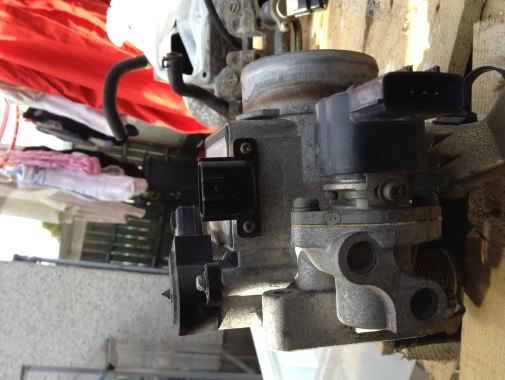

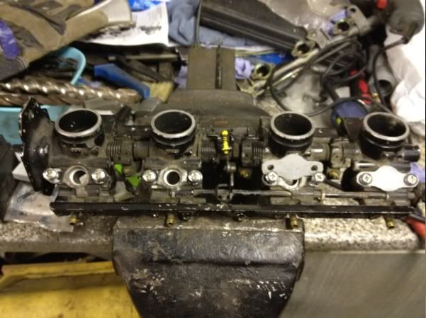

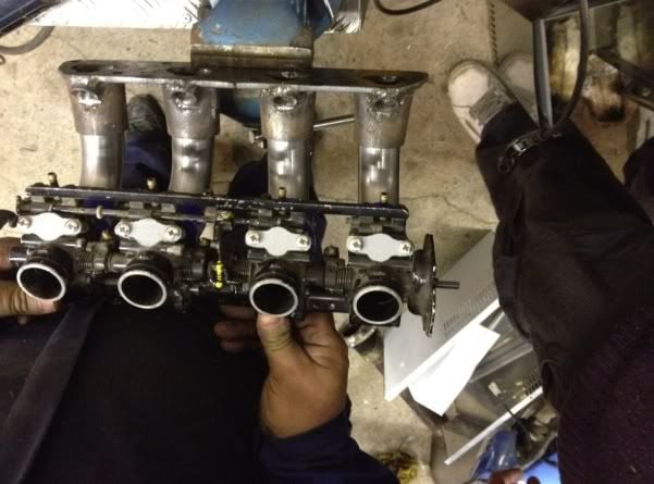

Step 10h: Purchase Throttle Bodies. GPz1100's - Total Cost: £10 (eBay - delivered.)

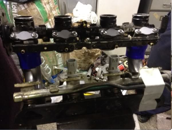

Step 10i: Blank off injector holes. Turns out these are ideal for vacuums later.

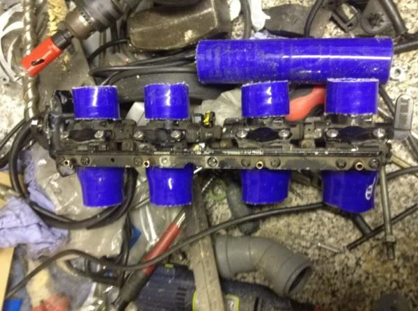

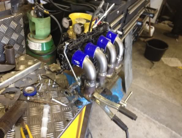

Step 10j: Compress pipe in vice to make oval. Tack and mock up with throttle bodies.

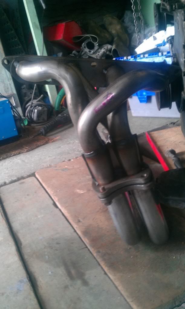

LOL! Excellent. Do you just sit an offer up random car manifolds until one fits?! Genius like.

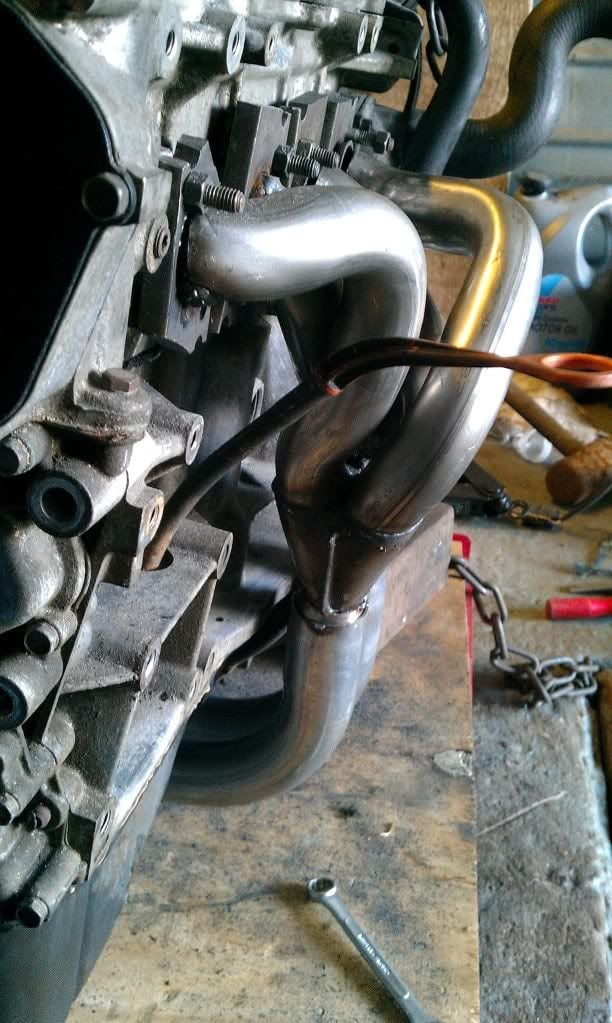

4-1 though? Then where to take that flange? Gearbox in the way? I was thinking about some tight mandrel bends and another CNC'd flange lol. I was gutted when my inlet mani didn't fit right lol, seriously need to measure like 60 times, cut once. Can the exhaust be done on separate flanges? Would allow slightly more room for my excellent ability to make a hash of things.
equal length 4 into 1 for top-end eh, and the flange is where you fit the turbo onto :D
you could cut-n-shut the headers i suppose
Don't even start me...you know i want to do a backyard turbo build! Maybe if i had a spare engine and crane i'd do a full rebuild.

See...since my throttle bodies go into a common plenum, with the MAF...I could just specify the correct diameter or plenum for the same results? Just hack a bit off the lower end of the air flow channel on the MAF then? Lol.
