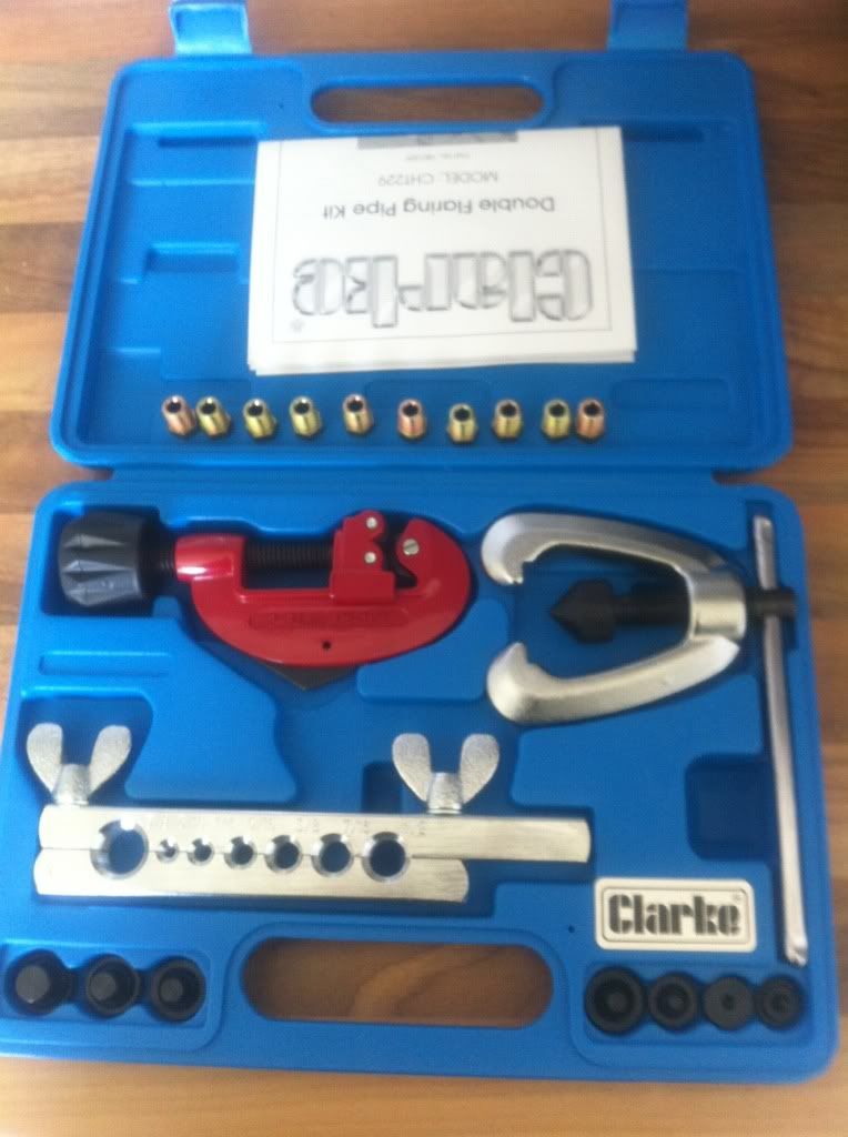

but id just go for a working kit from a known company and see if there are any reviews

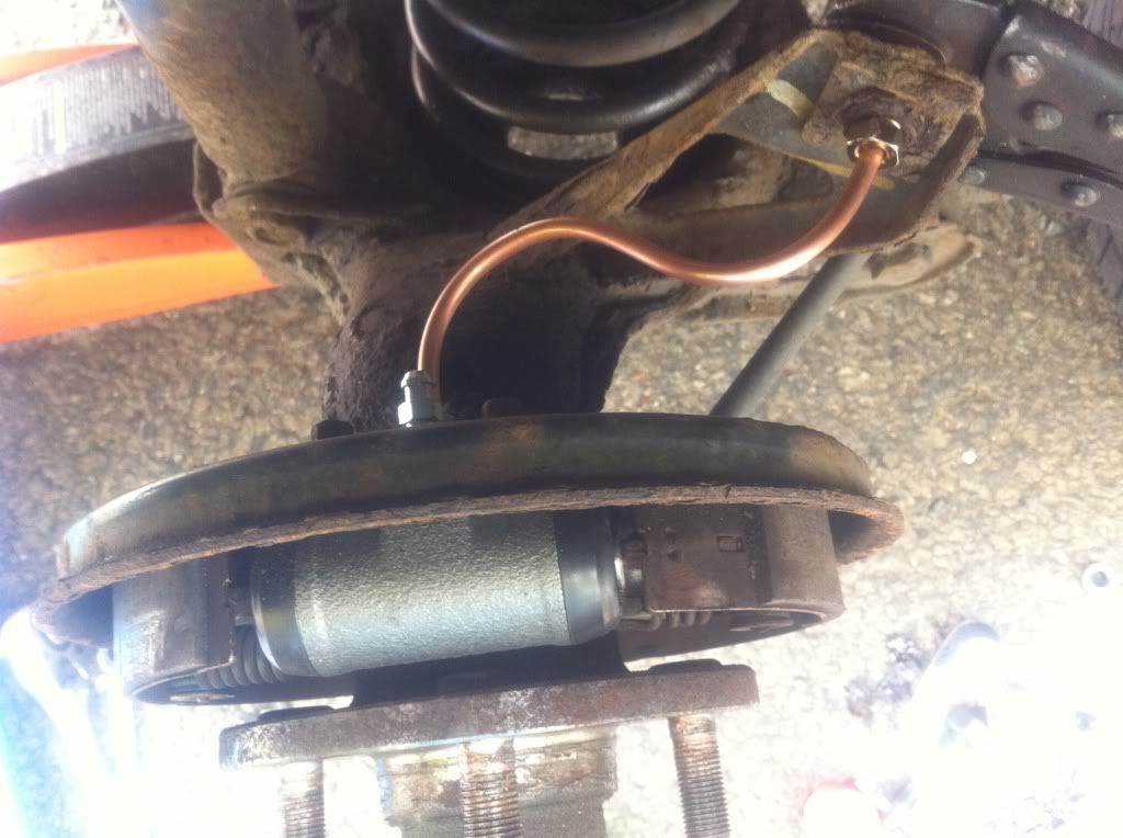

Well attempted some brake pipe replacement today. Bought a cheap kit and some unions and 50ft pipe. Total cost £47 lol this wasnt my car i done the pipes on though i think ill be replacing all of mines, looked at some videos and im sure the one i thought was best left me with a minor leak on one out of the 4 flares i done. So going to redo both sides again with a new technique on the bubble flare.
Looks good Stani! I replaced all the lines on a Series III landrover with one of those kits. They're a right pain in the 'arris to use and really make you want to take out a bank loan and buy a proper setup. They do work though if you're persistent :).
I was going to buy the £180 kit but im a joiner not a mechanic, proper money is spent on my work tools lol as for that kit it seemed ok for the job, one question??? When clamping the pipe ready for flaring do i have to crank the wingnut right around? I really dont want to crush the pipe.....

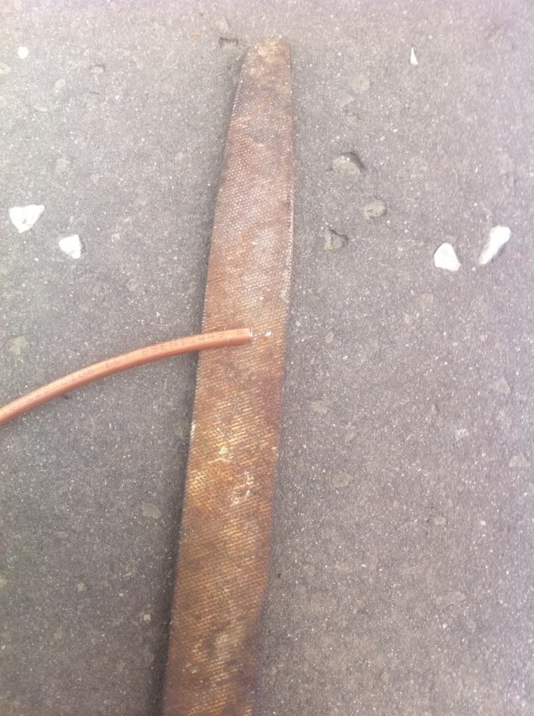

Then file off the remaining parts

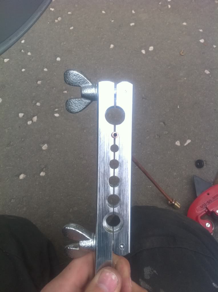

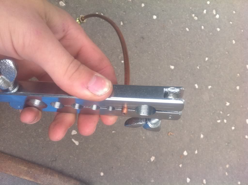

Put the pipe into the correct sized slot and make sure you use the correct end of the tool wether its a double/bubble flare that you wish to do

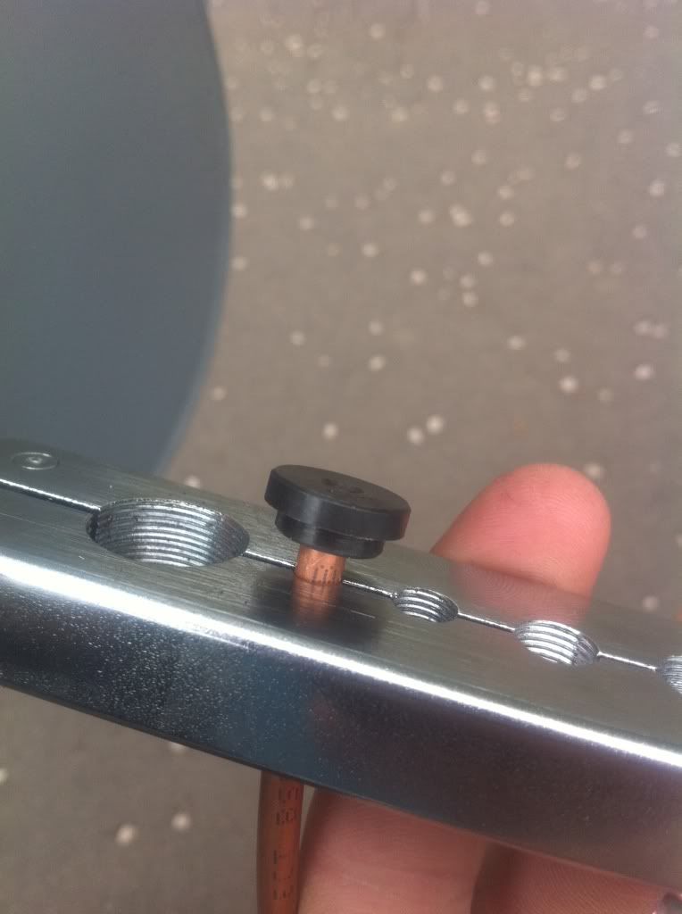

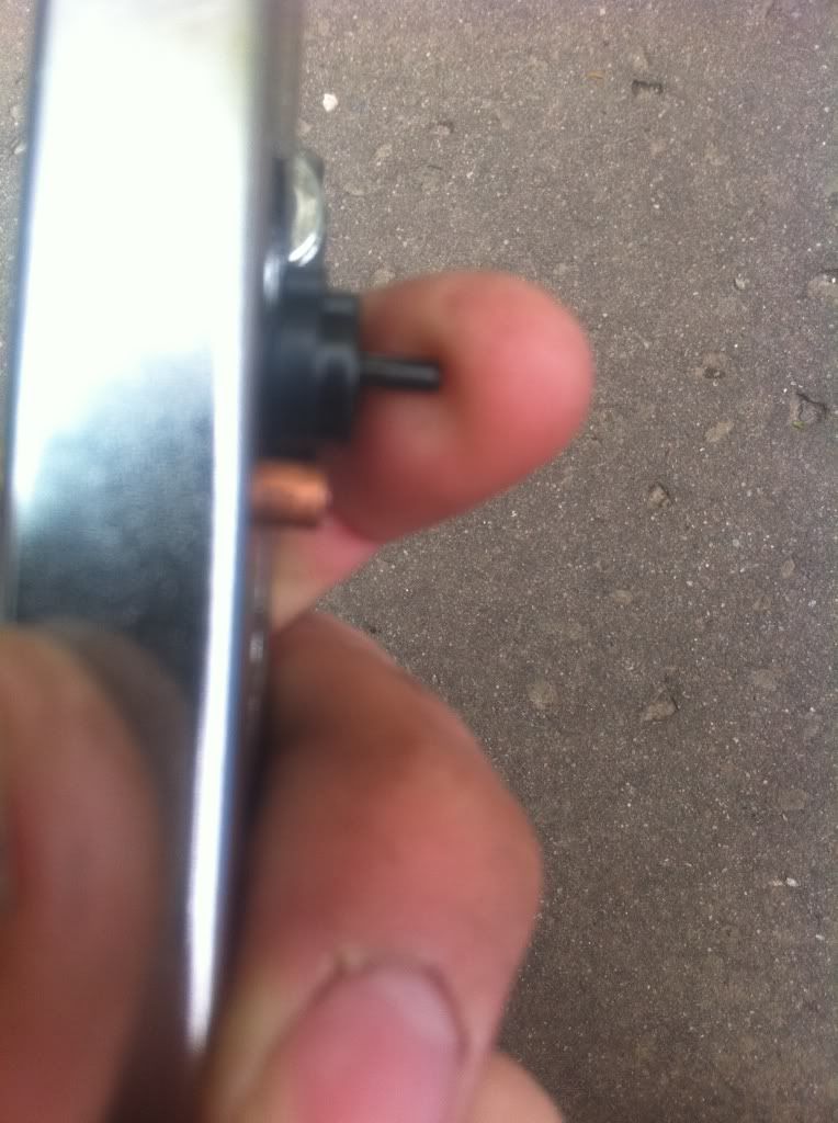

Not a great picture here, the black button with the pin sticking out i read that the first step is the length of pipe you leave sticking out the tool but this didnt work so i added another 1-2 mm
Then tighten both wingnuts up (i done as hand tight as possible)

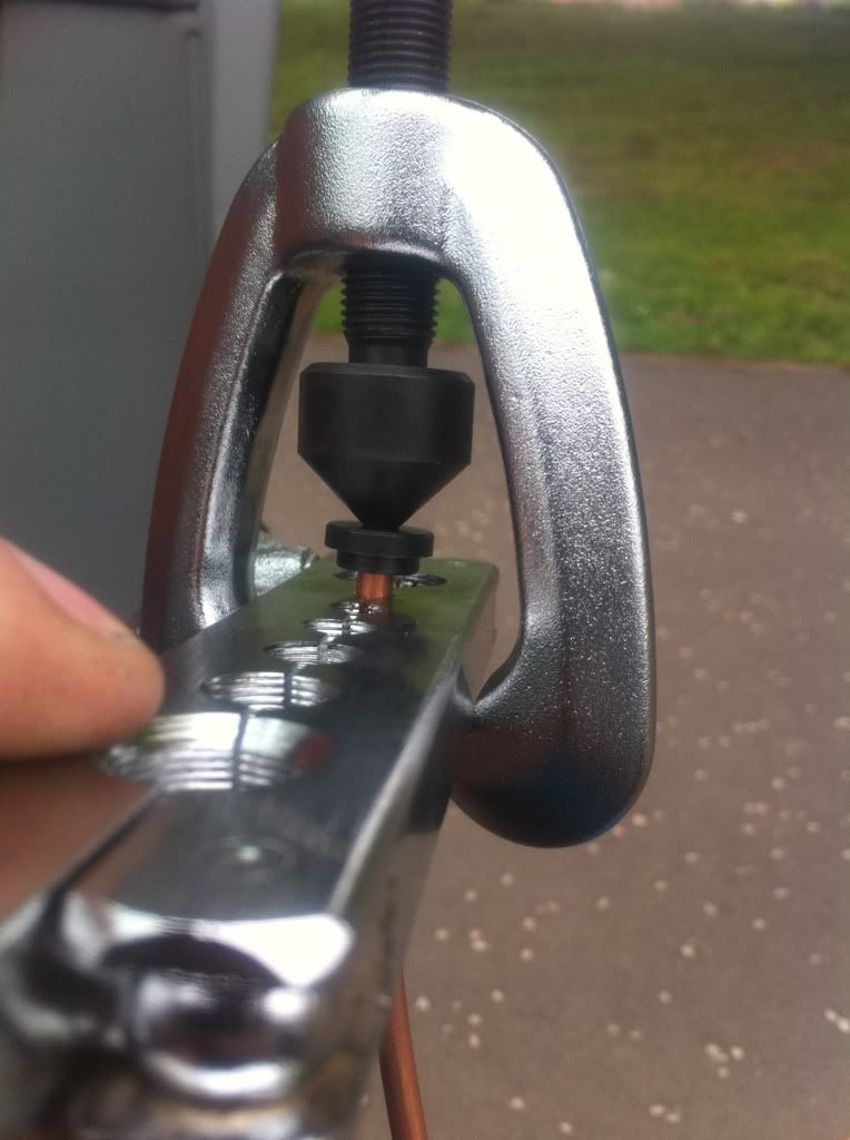

Put the black button with the pin inside the brake pipe on top
Fit the clamp and tighten down. (i never done it as far as i can go)

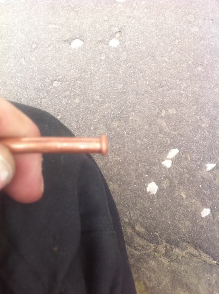

You end up with this

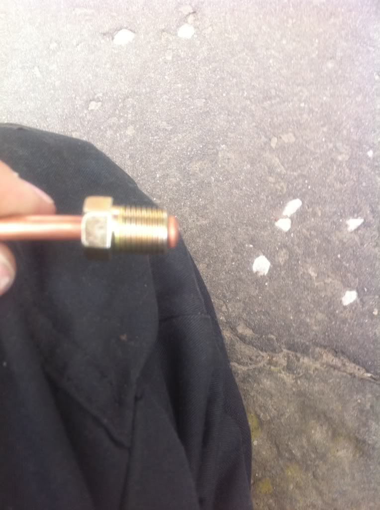

Push on a union
DONE
I then screwed in the union, shaped the pipe. Pushed on another union and repeated tge flare process again
Excellent result Stani, I don't remember getting flares that well shaped :).
stani i think i remember ur supposed to use the other side of the pipe clamp where its chamfered (pictured on post #7) rather than the side thats flat. when i made that mistake it was very hard trying to form the head and almost breaking the tool bit. when i realised bout the chamfered side it was much easier effort to form.
polly at first i used the chamfered side but when i removed the old brake pipe they had not been done with the chamfered side so i copied what was already there (Y)

In the photo, the brake unions are fully threaded. For DIN, you need unions with a lead, not the fully threaded ones. Are your brakes leaking?
