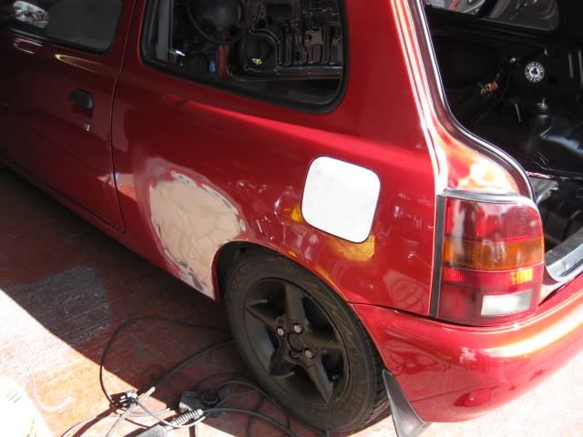

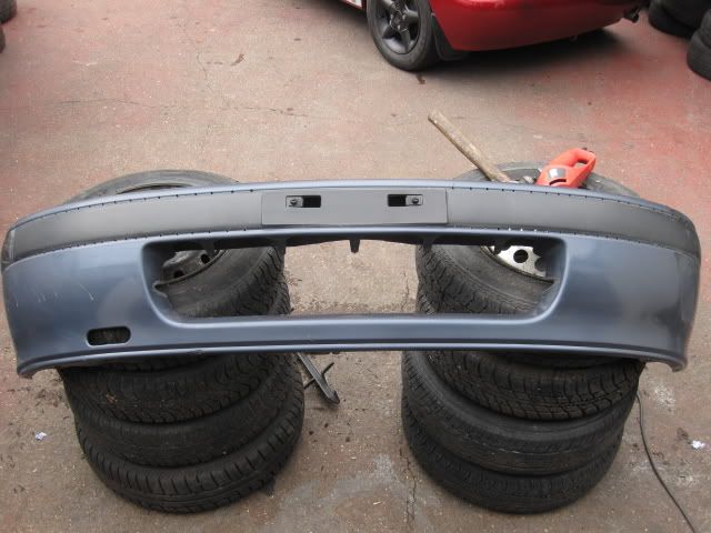

Nice bumper, what did you use to do it? Just normal car body filler?
Also what are you using to paint it? I presume that isn't an aerosol job?
It was a coat of fibreglass paste then normal body filler.
This was done with a gun but you can get the same finish using aerosols.

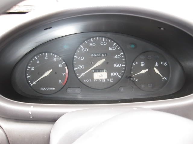

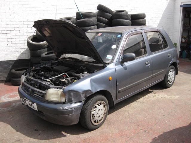

30000 Mile 1275cc Engine donor..
Found this the weekend.

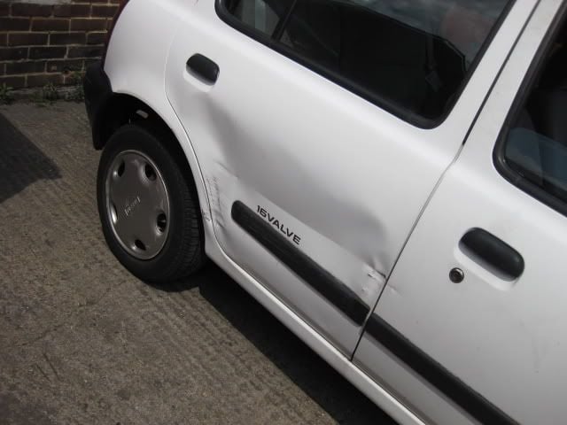

30K miles,2 owners.Grandad bought new,then passed it to his grandaughter,who sadly got written off by someone.

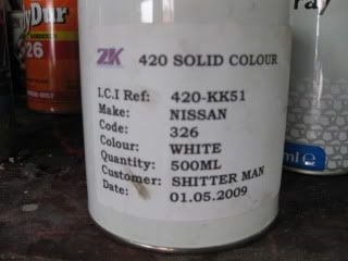

Yea, question about the paint, whats it called / paint code? Ive got the same colour.
And if you got a white K11 this will most likely be the code...

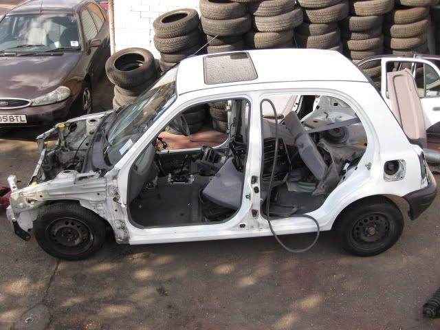

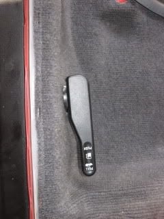

Stripped the victim today,few more bits to get while on the truck before she's off..

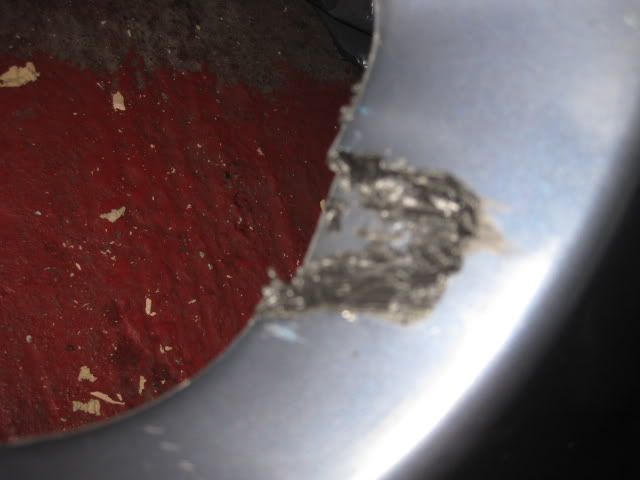

Robbed the boot/petrol flap opener from the donor & fitted it to the RaT so now I can de-lock the tailgate & petrol flap.
Was fairly easy to fit but it's a stripped out rear which saved time.
Worst bit was having to make hole in inner sill to accomodate the release handle back,but easy with the drivers seat out.The hole is already pressed into the metal to guide you,you just got to cut/drill round it & use 10mm self drilling bolts to fix as you have not got the captive threads to use original fixings from the donor.I'll cut the fixing section from the victim & weld it in when the sills are repaired.

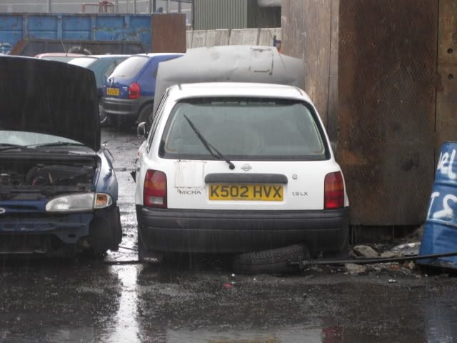

That was a waste of the K reg,I had a quick look round & it was good.

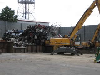

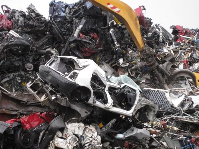

I've seen all sorts destroyed by people who don't know/care what they've got.MK1 CRX,Sunny ZR,FTO's & loads of new cars sent from DVLA for no tax,all go in the crusher.
So much for the environment they keep banging on about!
More crunching noises

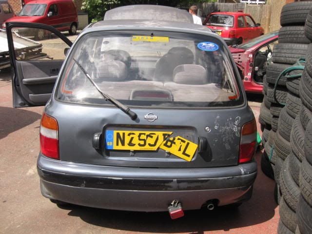

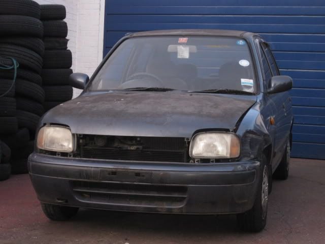

This arrived today,March Auto with air con,electric windows,rear head rests etc.
It's got rot, a stoved in drivers door,tailgate is battered & holes drilled where they moved the number plate lights & the gear linkage is mangled but it still drives :devil:
Engine is sweet (Maybe for our Super S with the AC) & the gearbox is sold & the front bumper is going on RaT with some smoothing.Also got a rev counter pod I can use but has auto gear selection lights at the bottom.Has electric mirror switch but no wiring/mirrors sadly..

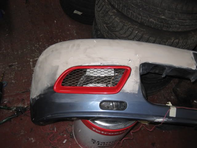

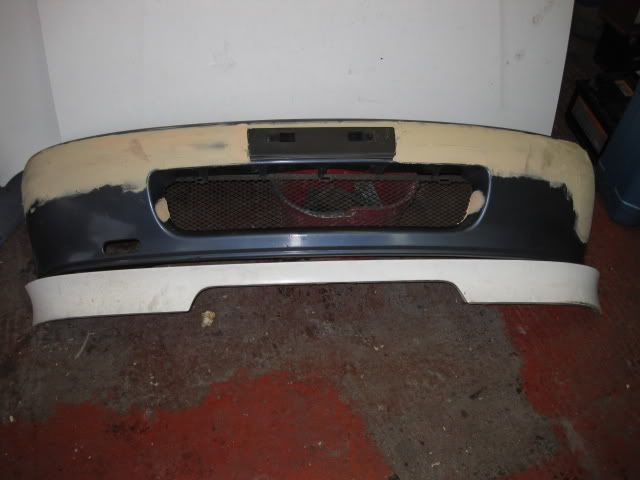

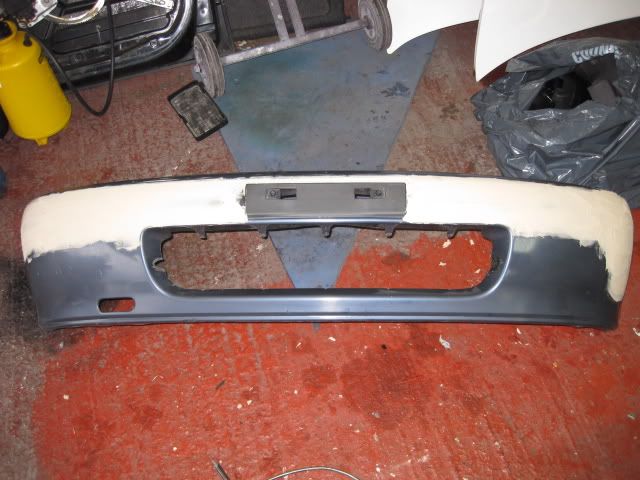

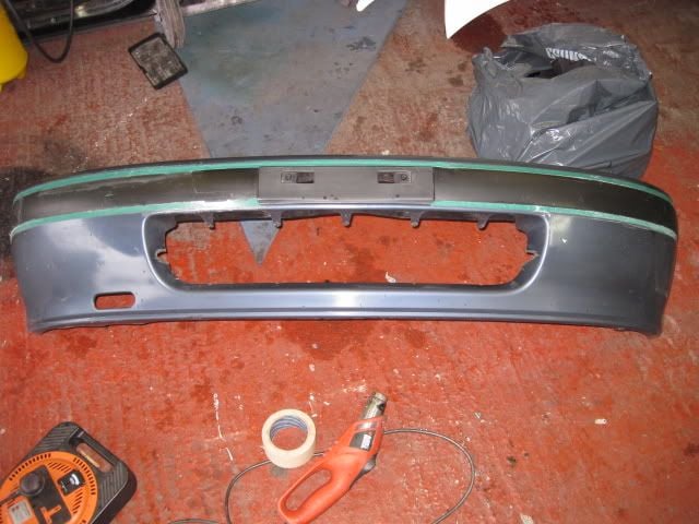

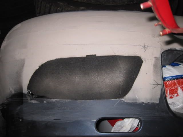

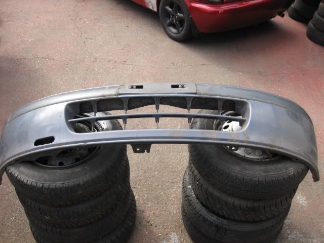

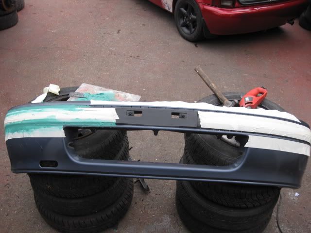

Removed the March bumper today & got the mods underway..
Cut out the unwanted plasic & drilled holes ready for first coat of glass.

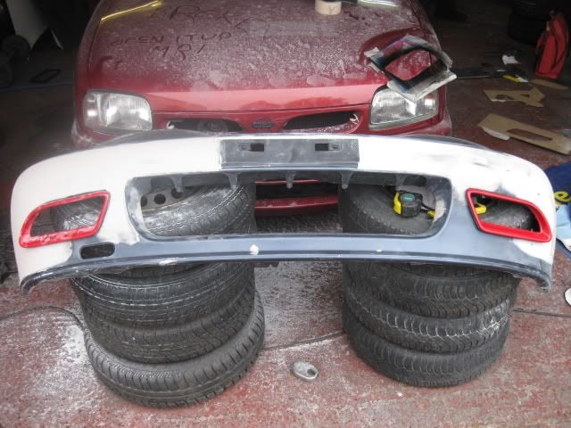

Masked & glassed.
Glass finished.
First fill.
Used squares of the excess plastic cut out from mouth to "weld" in infills left after removing the platic bars.I merged the 2 plastics together both sides using a soldering iron,makes a very strong repair that you can glass & fill over.
First fill.

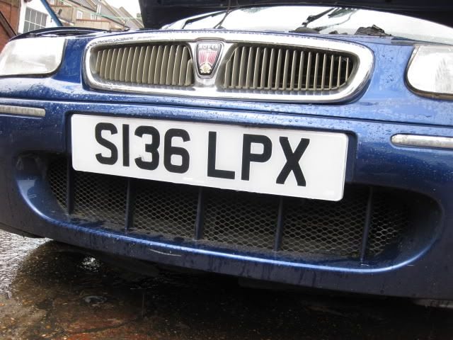

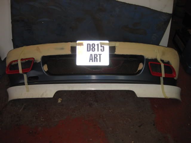

Found the mesh donated from a Rover & the grills from a Primera GT.The splitter came from a Celica..Number plate borrowed from my Civic,I'm going to buy 2 import plates..
Rover mesh.

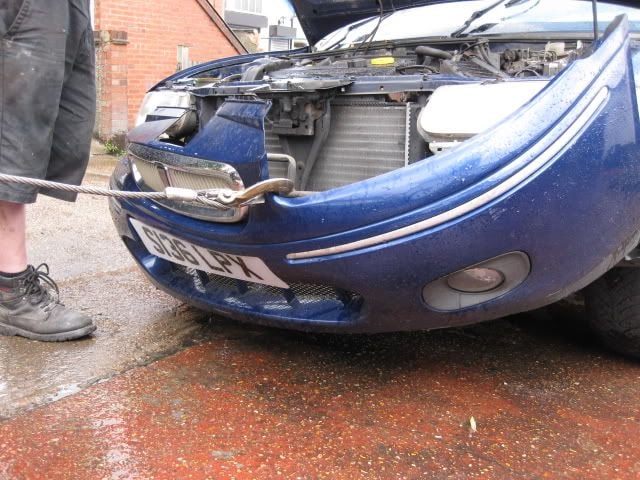

This teqnique for bumper removal not found in a Haynes manual.Fast & effective,they need a firm hand :devil:
Hopefully get some time to get the filler work seriously underway tomorrow & the holes cut out for the Primera grills..
Both grill holes done.

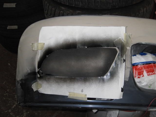

The Primera grills are straight so I've had to build the corners of the bumper up with fibreglass to fill the gap.
Nearly there with the filler now but it's took some time to get it right,smoothing the moulding shape is not too bad it's the grills that take the time.
Very much looking forward to primer now,seen enough dust for a while..

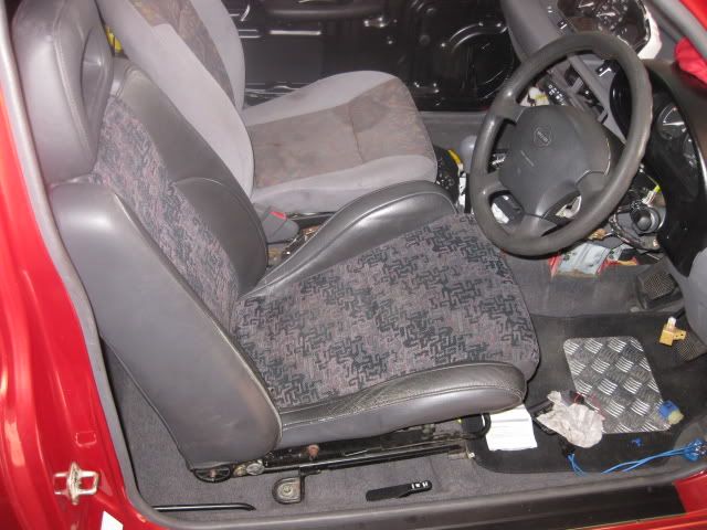

Only good new is that Ferrit swapped Micra seat bases with Primera GT seats & fitted drivers side.
2 fixings line up to join base & seat so a little welding/nut & bolting will be needed on the back 2.
Hold you in very well though :devil: backs may need to be raised a little.

Not happy with the seats- wish i hadn't of taken the primera sub frames off and instead modded them to the micra. Lots of measuring and drilling rivets and holes. But its all part of the fun still the passengers seat to do, no rush seeing as sleeper is ####ing about with the bumper and the car isn't even running!

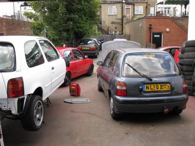

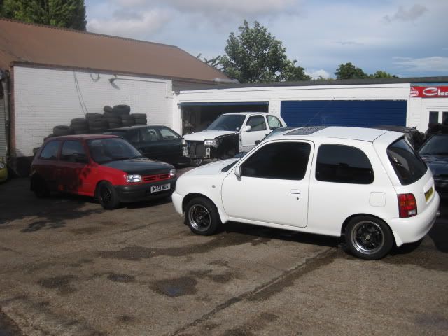

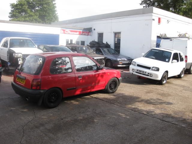

Front of workshop is mainly projects,Sad looking 16V Integra (engine donor for an '87 Civic)The white super S on axle stands (but nasty work done)& the March is being slowly picked at,must get it dealt with & an Audi A4 with electrical issues that's really outstayed its welcome.Oh & the rat is a dusty non runner & the only car in the workshop due to the amount of clutter I keep but I've been doing a few jobs while it's there....

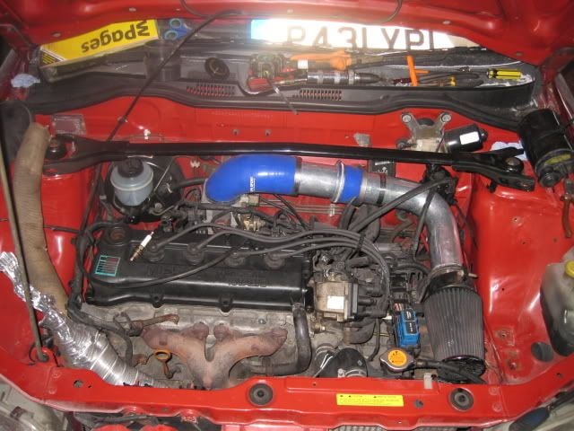

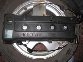

B]Me & JC removed the restrictive Pug 206 induction elbow & fitted the 70mm blue sillicone hose.
We had problems finding somewhere for the carbon box to fit,I had it tie wrapped to the induction pipe by distributor (bodge)so we used the box from the scrap March which is much smaller & fits in the corner of the bulkhead,just got to rob some longer hoses.
Nicked the rocker cover off the March too (Sorry stani :wasntme:) cleaned it up & fitted it.
Really must paint the bay black next that red really sucks
