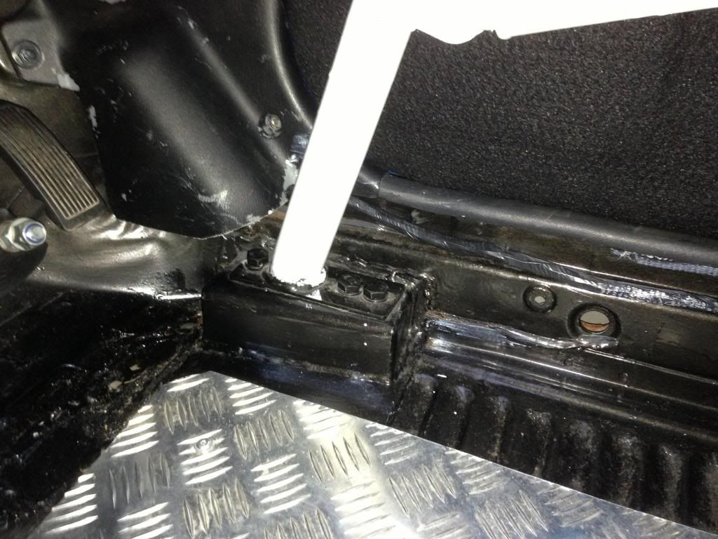

It may be me but at first the cage looks ok until you look at the feet positions and think "If it is purpose made to suit a Micra k11 why is that middle foot where it is. Most feet are back by a couple of inches so you can make a nice box on the upper seat area for strength. If I try and take it back further then the top rail above the front window ends up about three inches from the roof.
This is going to be a pig to fabricate!
As you can see the top bar at the moment is in a good position any lower on the front feet which would allow the middle feet to go back would move the bar in front of the mirror!
PLEASE, PLEASE if anyone out there has fitted this cage or its previous model could they take some pics so I can see if the feet can be placed better. I would hate to fabricate and then find a better position.
Welcome to the trying to get an OMP cage to fit game Sharman, i can take pic's of the box section / modified areas of my cage if you like.

Yes please the pic's would be great. I have already started the fabrication, but it would still be good to see how yours was fitted, plus I hope this blog helps others with the similar problems in the future. By the way I did need to remove the dash as you pointed out before it must be because mine haven't got the extra bend. OMP were useless when they finally got back to me after my second email all they said was "Yes you will have to remove it". I am practising my mig welding at the moment, not done any for about twenty five years since I prepared my MK2 Escort.
I will upload my fabrication pics when I have finished.
looking forward to seeing the build come together! No problem bud il get a few snaps as soon as i can.. i think it may be a case of each cage they made was a ruddy different size! good luck in the mean time :)

Hope these help mate
Thanks Skinner for the photo's. The cage has changed quite a bit. I see yours has a flexible connection from the front section to the back which has allowed your mid feet to be positioned on the upper seat deck. If I try and do that to mine the front comes down the screen too much, as far as I am concerned OMP have welded the spigots which stick out from the rear cage to join the front, at too much of a down ward angle.
Thanks again brilliant pics.
No problem hope they help a bit, I noticed your main centre hoop was at an angle when the front feet were flat!
Think OMP need a serious look at there jig's!

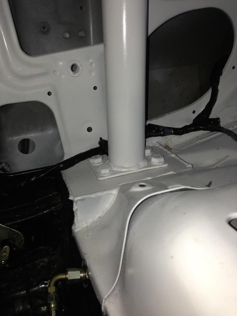

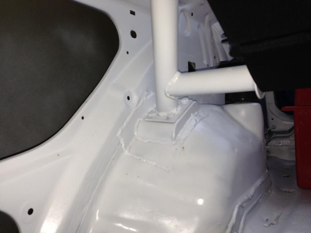

Making reinforcement plates for cage
Made cardboard templates out of cardboard and then purchased a £5.00 off cut of 3mm steel and set to work cutting and then bending the steel to suit.
Mig welded all sections together, not happy with quality of welding, but it has been around 25 years since I last welded my previous rally car!
Welding got even worse, but what do you expect from a cabinet maker with one eye! I am OK in right hand corners but left hand I am working blind.
Ran out of gas on this one but didn't realize till too late.

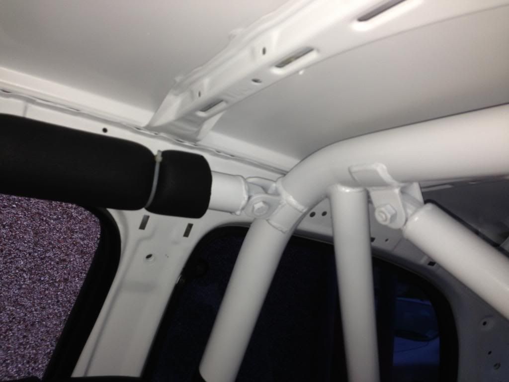

Painted inside and cage with white hammerite smooth (sprayed). Everything now covered in over spray, even my wife's new Dyson, whoops!!
