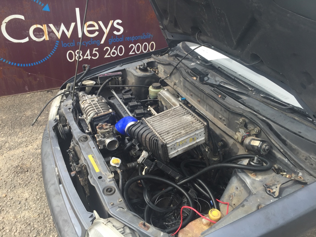

Porks supercharged k11 project

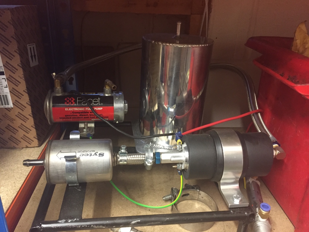

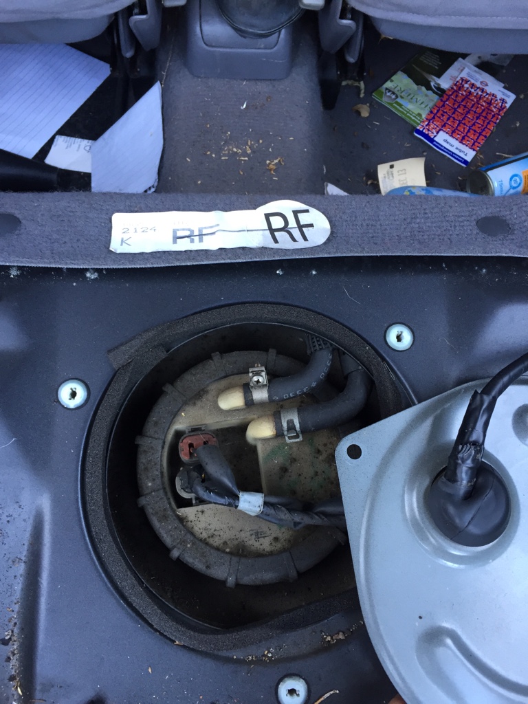

I wanna put my swirl pot/bigger pump and filter somewhere......this thing...
.....if I can get away with it, if like to it in the engine bay, were the battery was, that way I don't have to remove the back seats to plumb this in the back if the car
Is there any reason why I couldn't/shouldn't do this?

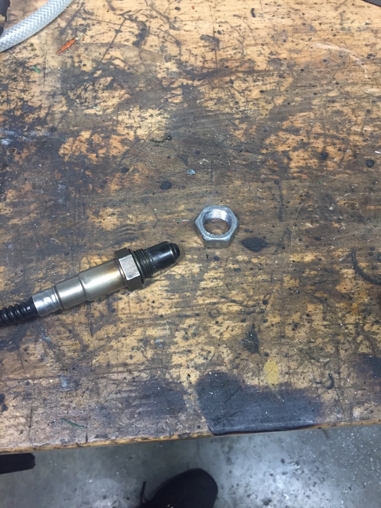

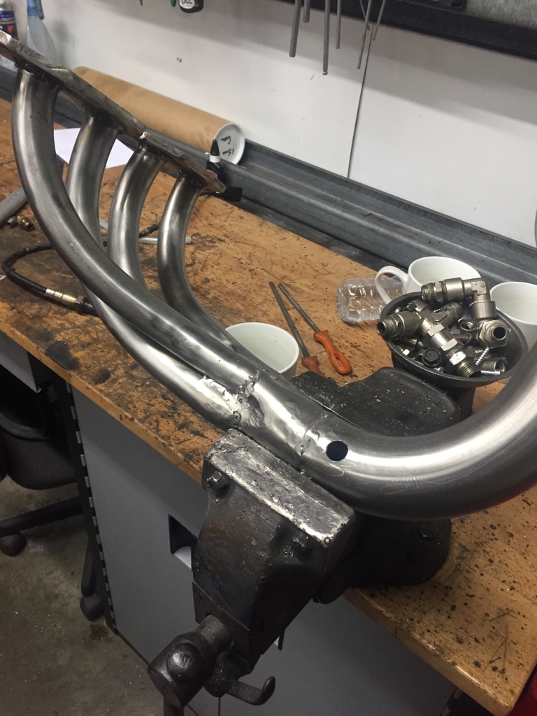

Forgot to weld on the boss for the lambda
Lost the old boss, so tapped a big stainless nut that was laying about to m18
The boss on eBay were £10 Sid that!

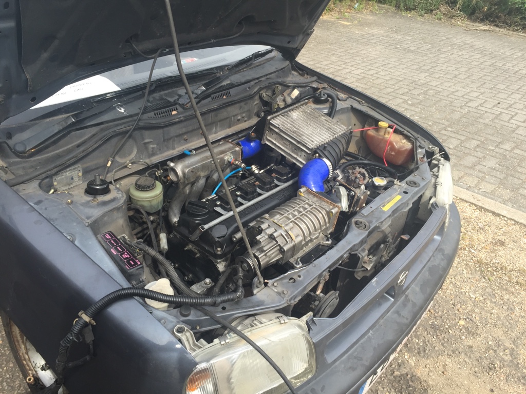

It's just usually fitted at the rear near the tank as its cooler and safer. It doesn't really matter though unless you're bothered about a higher fuel temperature. Do you really need the swirl pot? You're not really ever going to be sucking air are you? Looks good though. I suppose when things look this good, then why not fit it eh :)
Had it spare from last car.
I need a bigger pump, and the one I've got is external, and beings this car is being made from stuff I have laying about, and not spending anymore cash, I have to use it

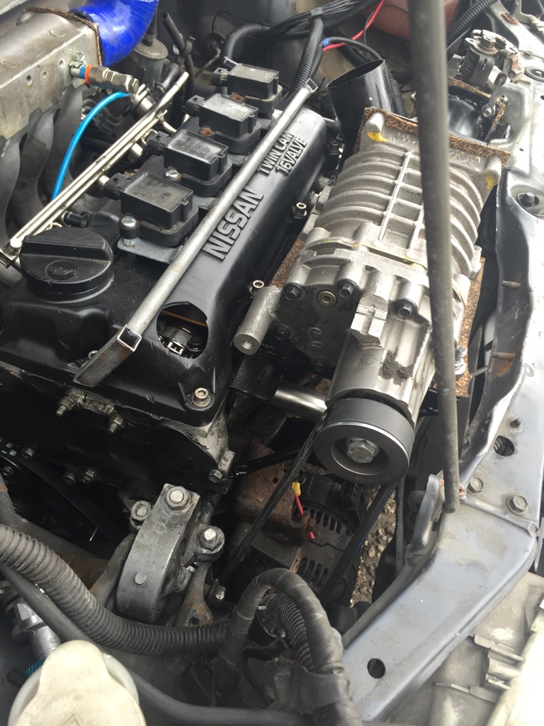

Gaskets belts and throttle done this afternoon .....broke my rocker cover!!!
Not sure if any plastic has got into the chain

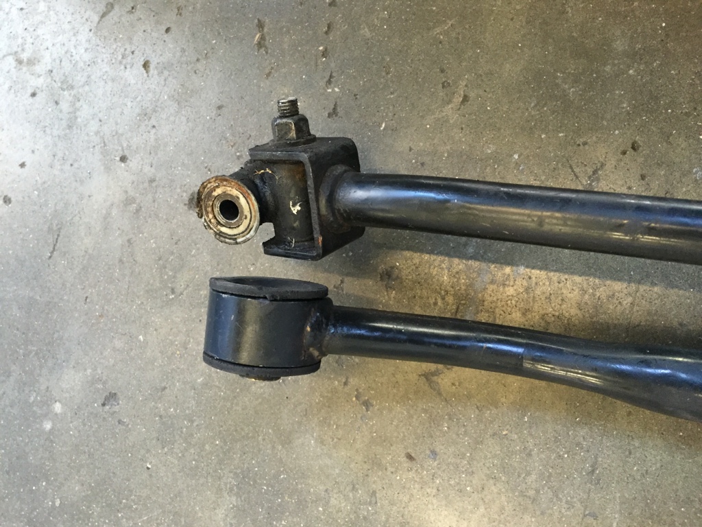

Having trouble fitting this gear linkage,
Could someone send me pics of the way the stick is connected to the body, and a pic of how the steady bar fits, swear there's bits missung
Cheers,,
The steady bar bush seems to talk and skinny
looks like it should be wider and shorter if that mages sense lol

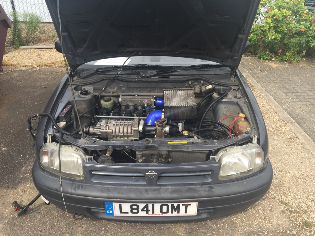

Started wiring up the connectors to the ecu
Don't panic, this is just to make sure they. In right place, then il solder and cover the bare wires

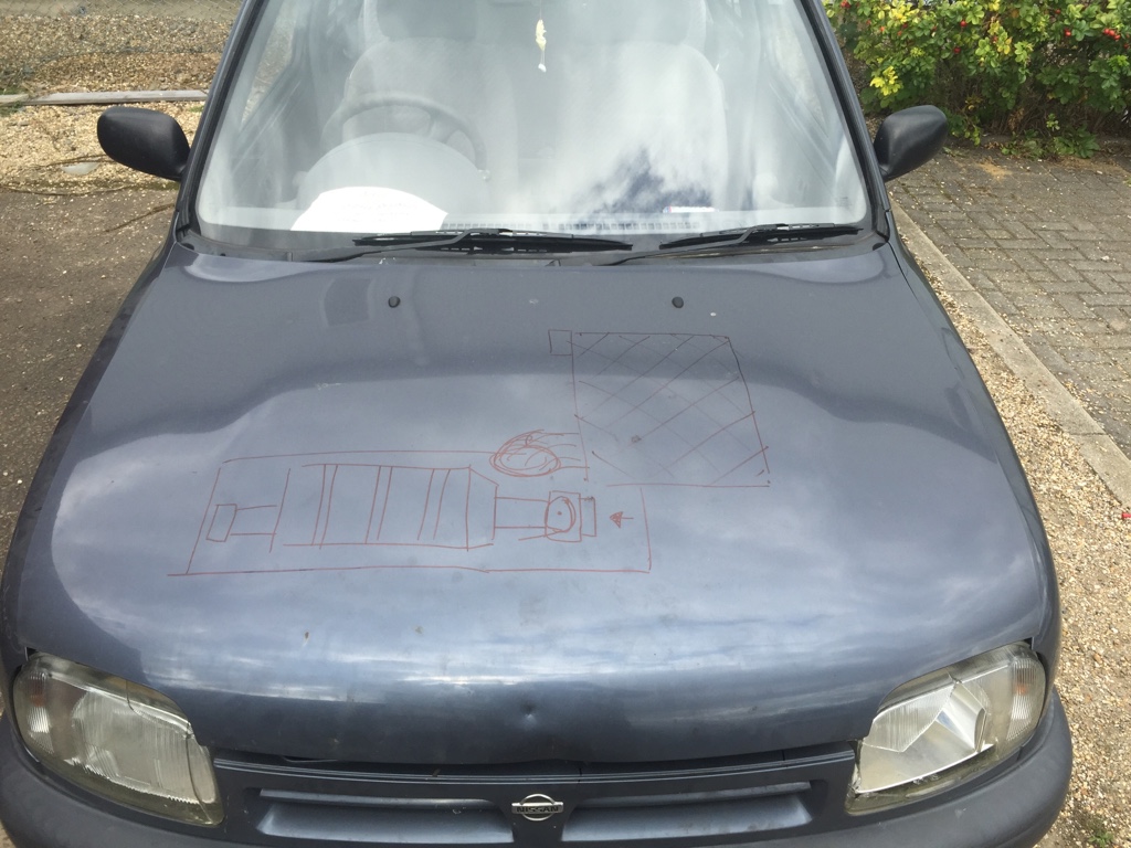

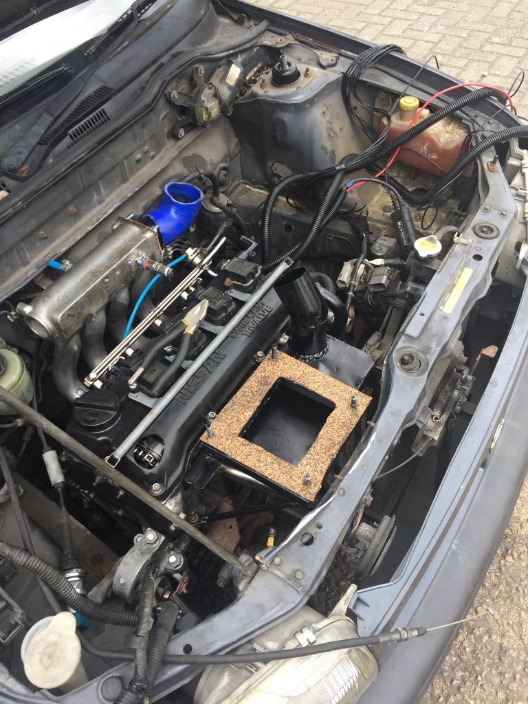

Also done a very accurate technical drawing of the section of bonnet I need to modify to accommodate the top mount inter cooler and supercharger
All black wires not make it confusing?? I say cut the bumper along the slight elevation thats already there and raise the whole center section wouldnt be too noticable
Black is all I had lol.
It's not that hard really to wire up, done this a few times now,
Just do 1 wire at a time and it's pretty hard to mess it up
Would take some suggestions on a bonnet scoop though for the intercooler, don't want anything to 'bad boy)
I take it removing the bonnet support pieces from inside won't give you the clearance? Just before you saw a hole in the bonnet :D
Bit of a shame...if only for all the extra work. :)
Though i suppose you'd be cutting it anyway for the intercooler so a little extra isn't that much of a headache.
Yeah you'd probably need to raise the whole thing along it's current shape, if you still want it kinda stock looking.
Nissan should have really foreseen this tbh :D

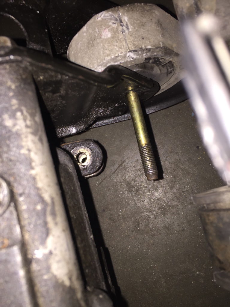

The gear linkage I've got doesn't fit right, I need this part solved before i start anything else really.
Here's my mount....
And here's my steady bar, that doesn't fit into the stud once the gear linkage is on ?!
Am I missing some parts, or is this part wrong??
Anyone help with the above?
Don't wanna start a whole thread about it
God damnit!!
Thought they were all the same (I did ask lol)
Anybody got the correct gear linkage
Preface lift cg10
Gas anyone got a preface lift dizzy engined cg10 gear linkage?!?
