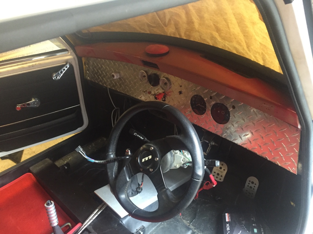

Dash in

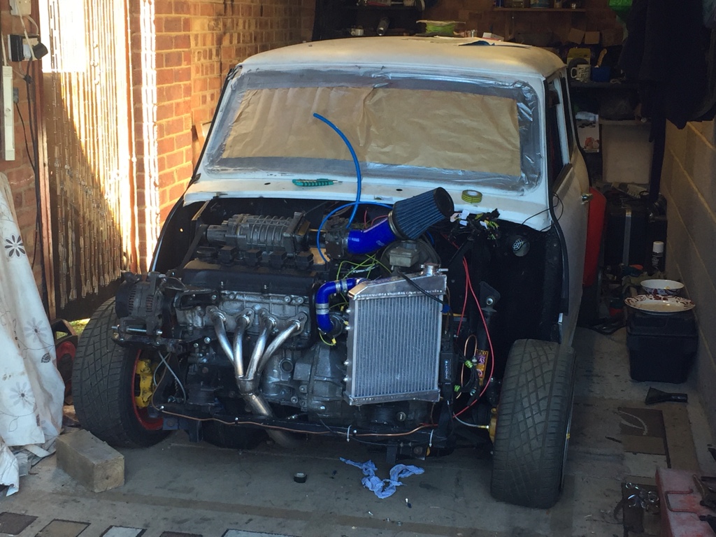

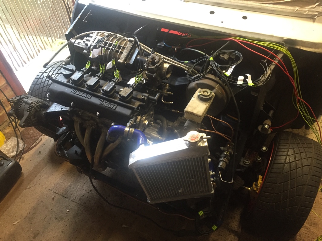

Wiring progress
Was meant to be first start this weekend, but fuel rail leaks and ecu ignition drivers died !
Got a few things I can try to save the ecu
Think I've cured the ecu problem, coils don't blow there fuses anymore, fixed fuel rail too
Ran out of time due to work, so can't get to try it out until Tuesday!!!
Don't think so, ran out of time, so check another time
Just glad to get it running

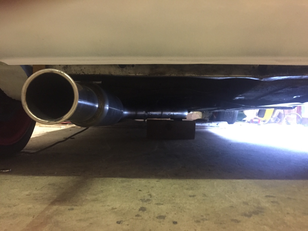

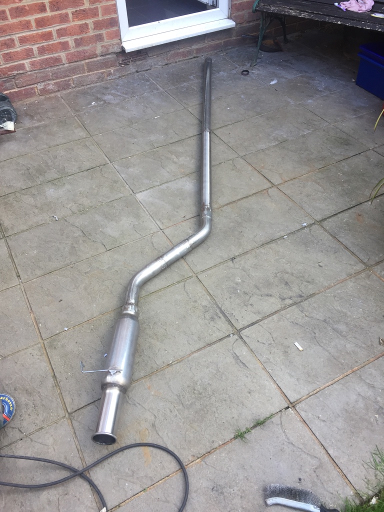

Got all final pieces for exhaust
Battery cables and battery sorted, jus need. Drive shafts and we can go for a test drive!!
Zorst all welded up
Need to figure out wiring for alternator,
I know it's a very basic thing I should know, but where do the wires go lol
the 5w half amp telltale bulb draws just enough current to kick the field coils into action neil, without that the alternator will simply spin without any output
Got ya, once I know where to put all the wires, I can the tidy it up, it's s right mess at the moment , no point having it neat only to have to rip it all apart if I have a fault, which there will be....I've built the thing
