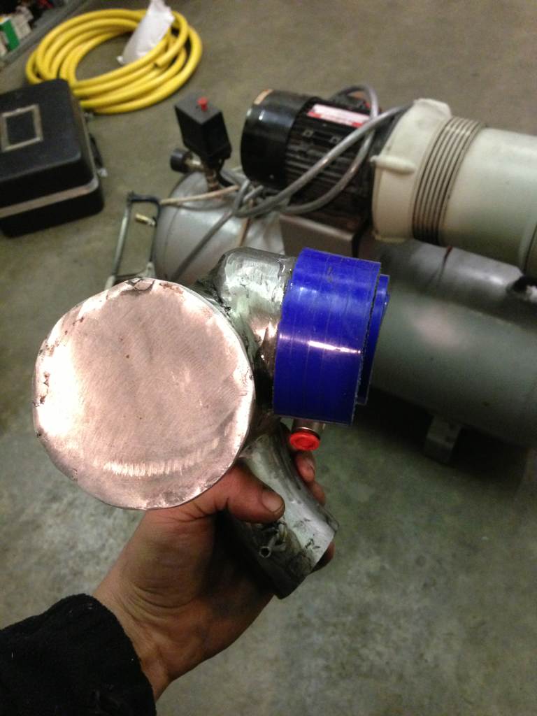

yeah mine wasn't silicone but it was fairly hard pipe it worked for me with the clamp tightened a bit extra. that araldite is bloody insanely sticky stuff tho.
as long as you key the surface, you can 2 pack glue anything neil :) (80 grit paper)
I might give that a go to then, the hose grips the carbs ok, it's the steel part that pops off, so if I glue and clamp, should work for now.

Had an hour spare today so poped to workshop.
Got some 2part glue and glued hose to plenum
Gonna leave it overnight to set properly.

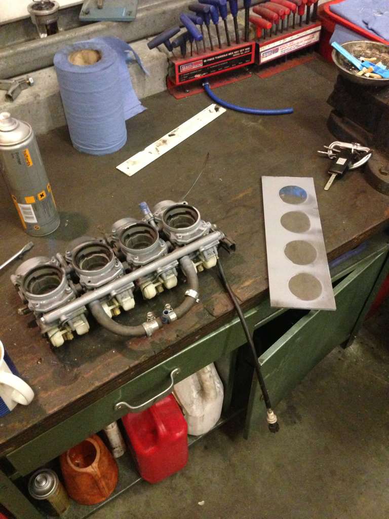

Rested plate on old carbs, and sprayed paint to mark out where to cut holes
Drilled holes
This is hiw it will sit, bolt straight through into carbs, with seals in between
Now gotta decide whether to just weld old plenum to this flange, or make a new box up? Hmmmm

i hope you're putting more bolts in the cover? its asking for a boost leak,
need at least 1 in the centre of the long side if not 2 or 3
Gunna cut a gasket out too to sandwich between it.

you will be very lucky to get areldite to stick to silicone, not very much sticks to it, to the point you could use the silicone to make a mould and cast the part in areldite, the only think ive ever successfully stuck silicone with in my previous fob was loctite 435 ( i think) and the specific primer for silicone
I've used the araldite to stick the two air box mounting plastics together, and the silicone sleeve is glued and sandwiched between them, jus for a bit extra help, plus it hides the ugly glue mess between the two plastics
