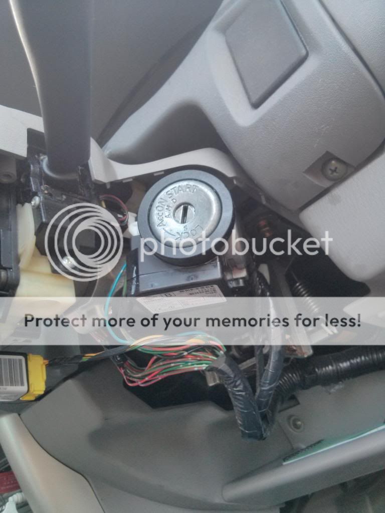

My trusty little Micra has an issue with the ignition barrell. I believe its the barrell as both keys present the same problem.
If you look at the pic below, you will see letters etched on the barrell. If I take the key out at point S, when I put it back in, it simply won't turn at all right the way round and start the car. However, if I take the key out at point A (pic further down, you can just make it out), there are no issues, it will start.
The only way to turn the car on again if you took the key out at point S is to take a hammer and a socket and put the socket on the face of the ignition barrell and give it ONE tap, then immediately put the key in, it will turn no problem, all the way.
Unless I am wrong, the solution I guess is to change the lock barrell? Anybody care to advise on whether its an expensive job? Can I use an ignition from a breaker's yard? I don't mind having 2 sets of keys.

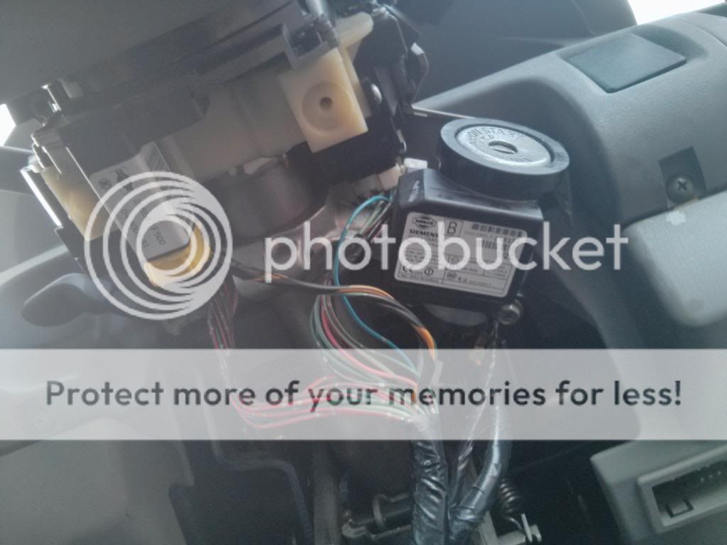

Other idea I was thinking is maybe to manufacture a crude switch so I don't actually have to stick the key in the ignition, I can just hold it up to the immobiliser box (I am guessing that's the Siemens marked small black box) and just tap the switch to start the car? Or maybe I can disable NATS and get any old Micra barrell and go down that route?

if you change just the metal barrel you dont need to play with nats as the small black reciever box unbolts from the ignition barrel :)
So I can just change the barrel and as long as I also change the small black immobiliser box with matching one, I don't need to worry about ECU, is that right?

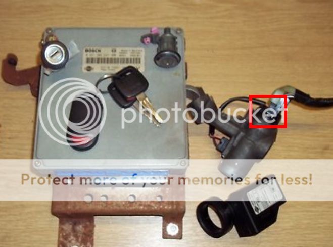

Based on that, I am wondering if I can simply get the rear bit for the ignition barrell (see highlighted part in red square, attached to the barrell) and that means I can leave everything else as is...
Opinion on tackling the problem that way?

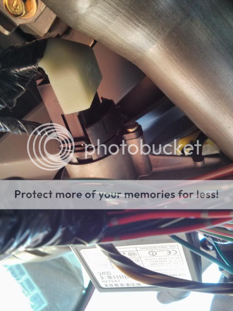

does yours have just 1 screw holding it on ss ? the facelift k11 wirings are quite different (97 one pictured)
