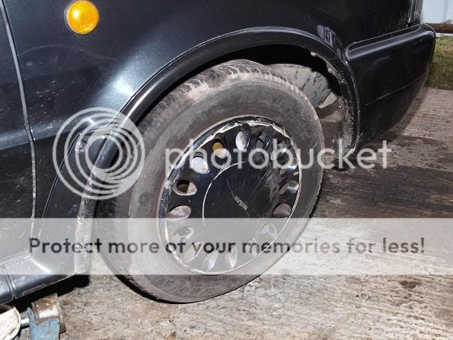

few pics of my new wheels..
old ones first nice lol
these are the new 1s £80 off ebay with tyres

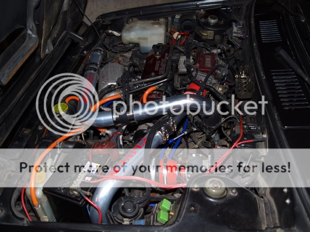

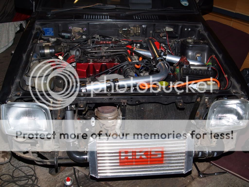

also started stipping it down today for the fmic. i have question i noticed that the belt for the alternator goes off the aircon. do you guys take the compressor off and move the alternator across or something so it lines up with the bottom pulley?

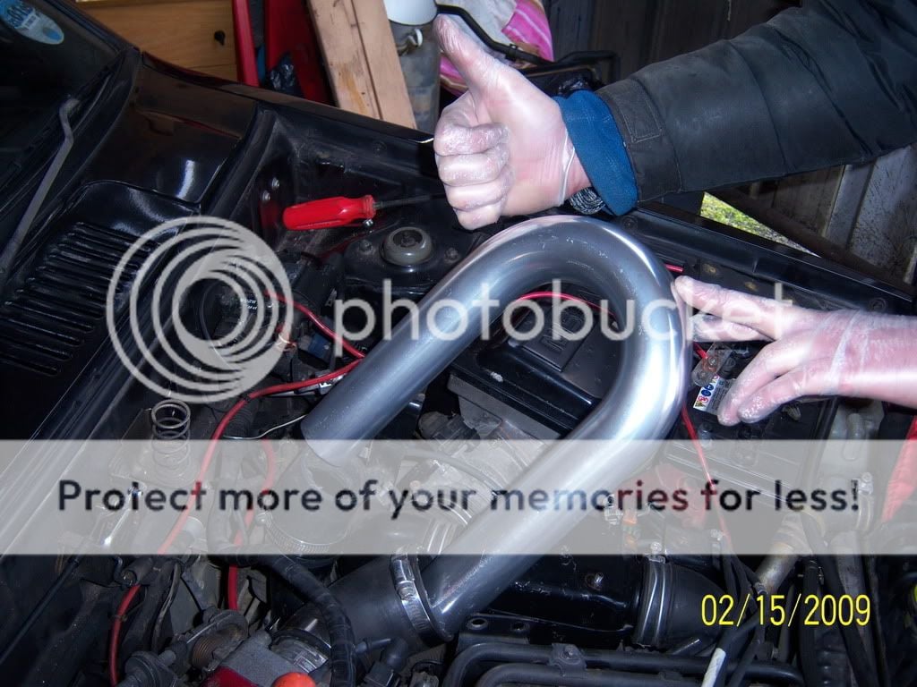

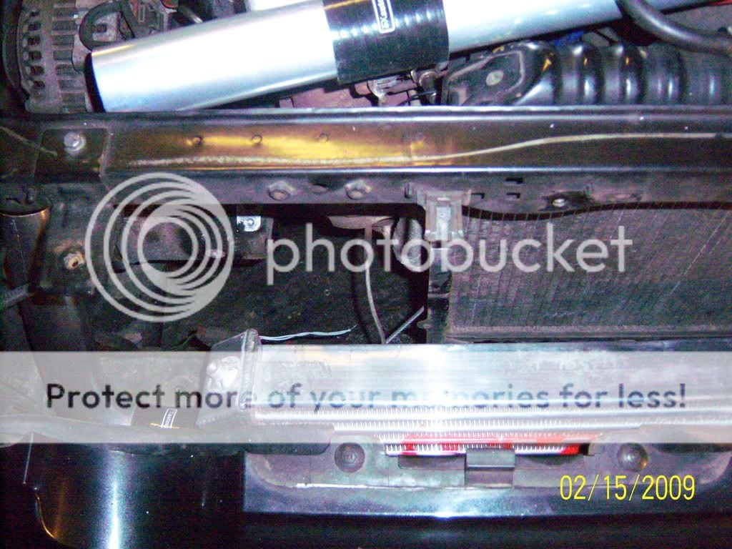

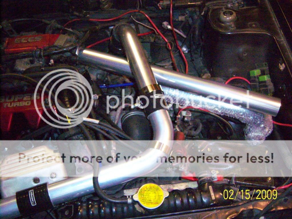

another pic of the start of the intercooler install.

where do you plan to put the fmic? piping? going to cut anything?
remember measure twice, cut once :D
im gonna take a good hard look at every possible route i could take with the shortest route but trying to avoild that bhp sapping turbo heat area.

Its grand man we're all here to help :laugh:.the altenator can be moved to where the ac compressor is now with a bit of cutting and new bolts I'll email pics off the way its done on myself and warrens cars and we've had no problems with belts slipping.
We did in the other position with thew ac out

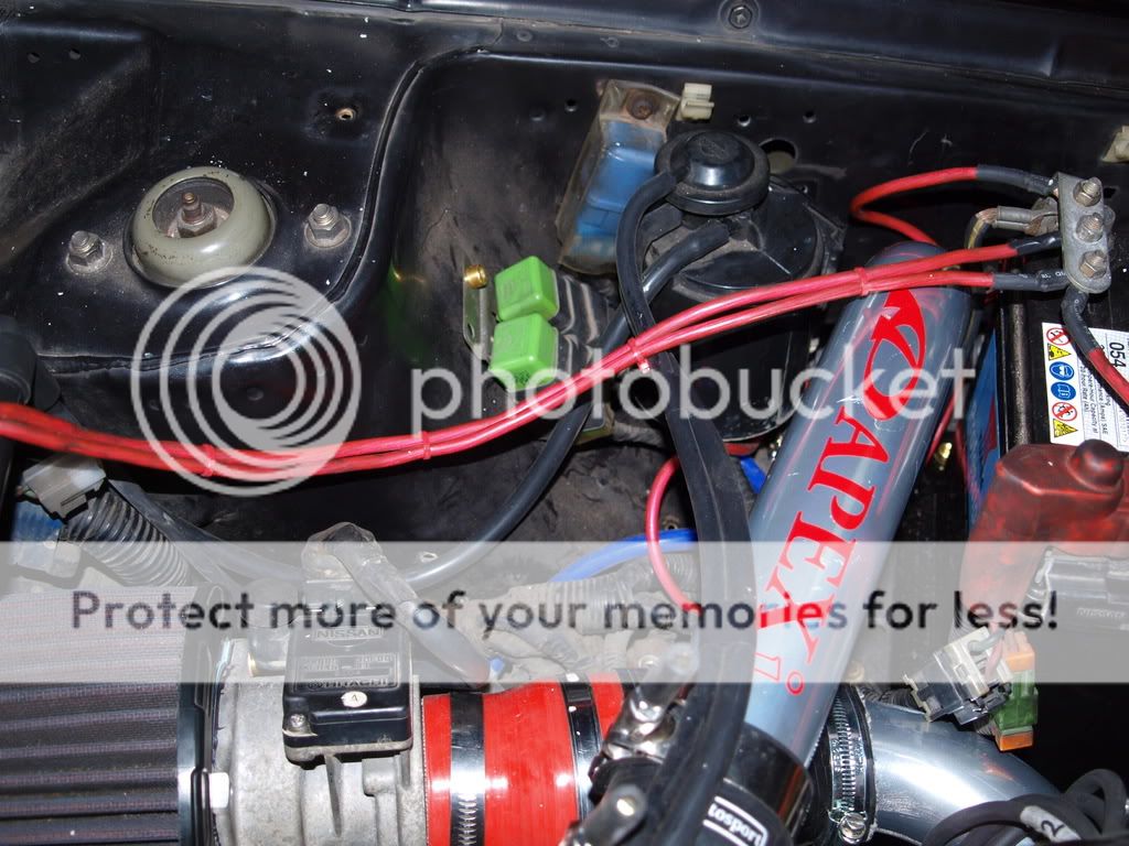

cheers for the comments lads... here's a few more picks of how I'm getting on with the install.. and baz if you could send me a pic of what you have done on the alternater that would be great mate cheers
gonna try keep battery where it is for now.

what are you doing with the fittings that normally go on the black pipe from the inlet manifold?
cheers glad your pleased with my progress. i got the pipe work off ebay i just asked the guy to supply black hoses with the kit and the hks inter cooler is off ebay to its second hand but will be up to the job.
im havin some nipples tig welded on the pipe off the eccs for 2 hoses that went on the original pipe.i had to ditch the air con its sapping me power.
heres a pipe of the shortest pipe route lol
i ment a picture of the shortest pipe route and i was joking lads

great work with the fmic mate, looks like thats the way to do it, and how i'll try do it when i revisit, can't complain about how mine is setup, it works fine! but then i only had bazza's pics to go off and nothing else

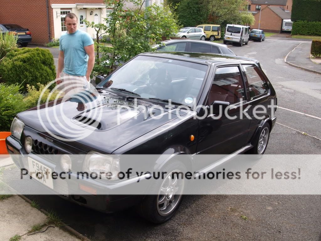

She looks well clean!!!!!!!!!!!!!!!!!!!!!!!!!!!!!!!!!!!!!
Not a big fan of those wheels,the bro had them on a k11 and the weight of them is unreal,twice the weight of the rotas on my st.
Well done man she's a tidy unit!
yer i really want some old school split rims with a polished dish 14" is what i really want but these was cheap at the time with tyres aswell so i got them. do you have any suspension 4 sale baz but not standard stuff? as mine gets floaty doing about 80mph down country lanes need something stiffer..
