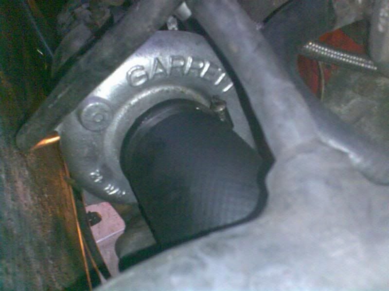

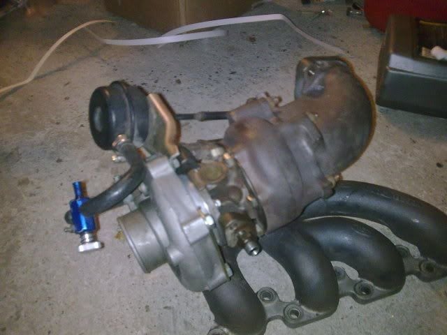

Escort RS Turbo Engine with wiring loom, inter cooler, metering unit, radiator, manifolds, Garett T3 Turbo, Bailey Dump Valve, Silicon Boost Hoses, crackle Painted charge carrier.

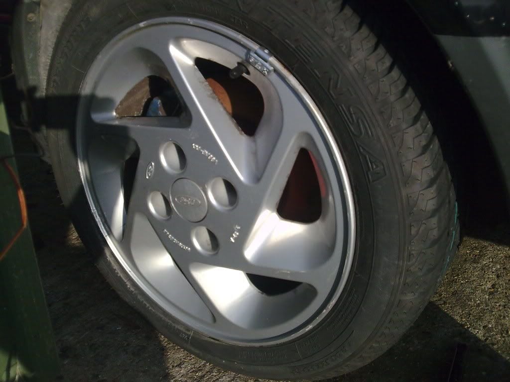

Series 2 RS Turbo Alloys

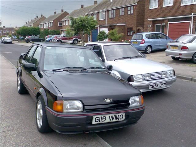

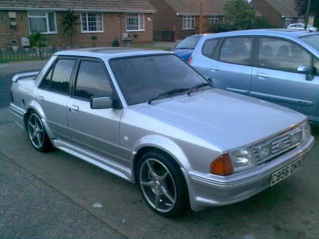

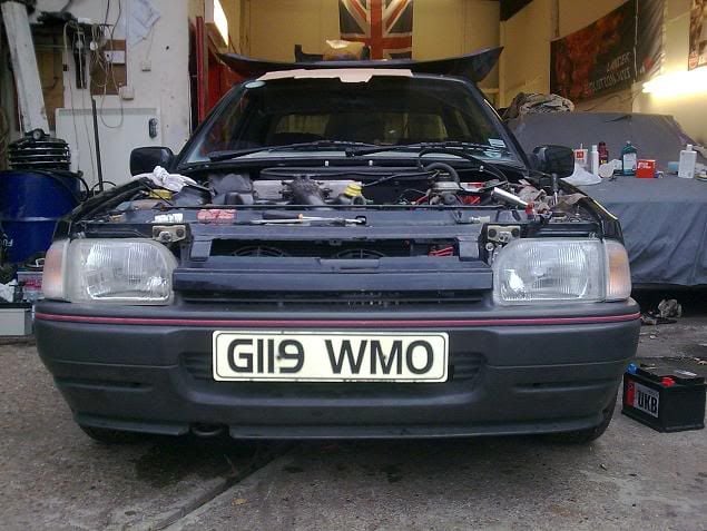

Well this was the day I went round saw it, fell in love and brought it. It was love at first sight!!!
And this was not longer after, parked next to my mates MK1 Orion

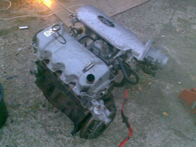

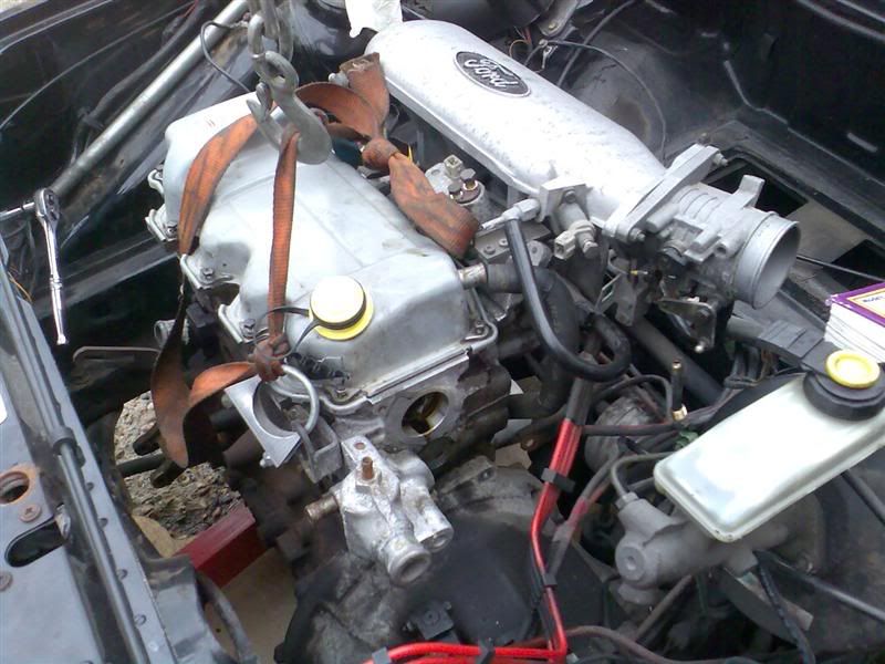

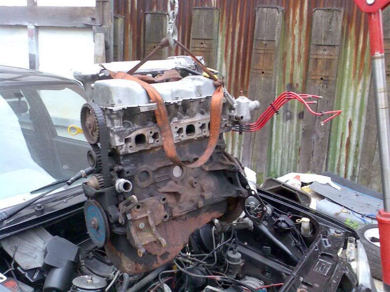

It was not long after purchasing it, that I decided 105 BHP was not enough, plus an N/A engine sounds a bit pants. So was offered an RS Turbo engine + ancillaries for a very good price and snapped it up. The conversion began Like so:

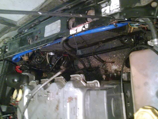

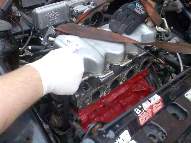

Out with the old:
In with the new:

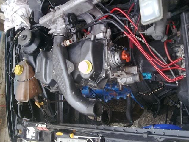

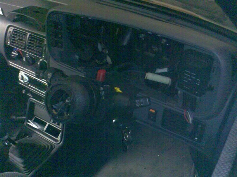

Dials had to come out to splice the two wiring looms together:

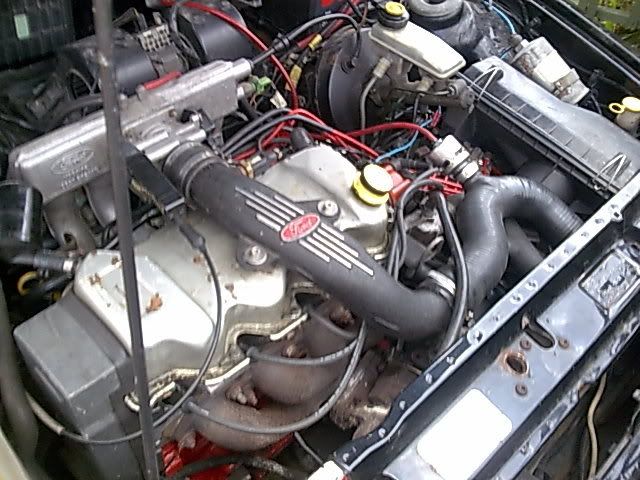

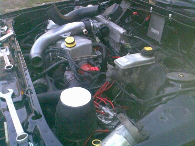

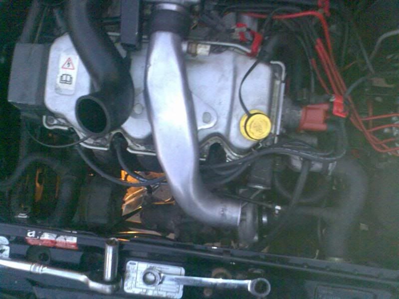

And hey presto the conversion was done. After a few teething problems, the engine is now running superbly. All of the above was completed 10 or so months ago. The car has been off the road since the end of may awaiting a few repairs. I have now started work on it and here she is at the moment:

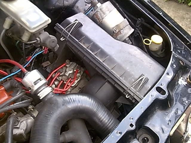

Escort RS Turbo air box fitted with K&N panel filter

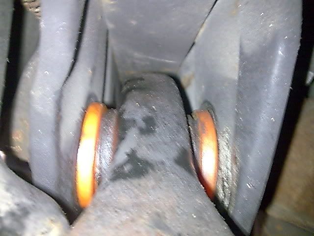

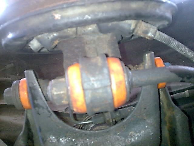

Poly Bushes in process of being fitted:

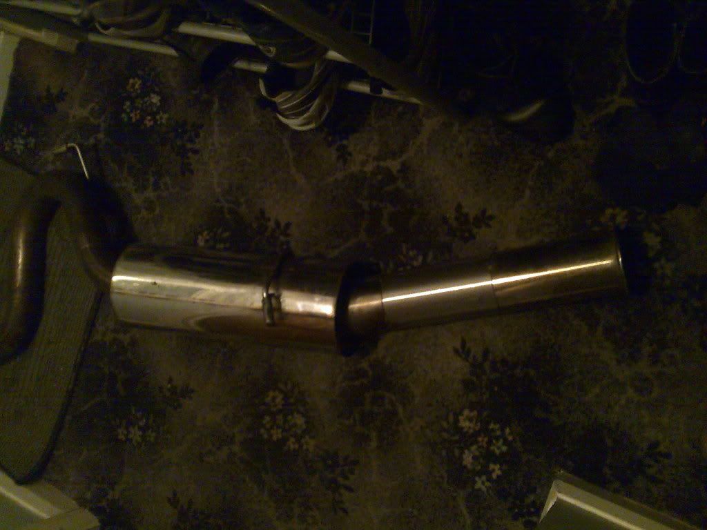

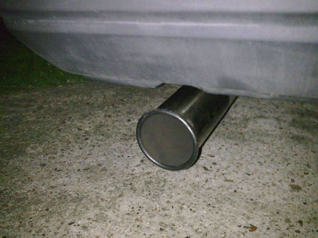

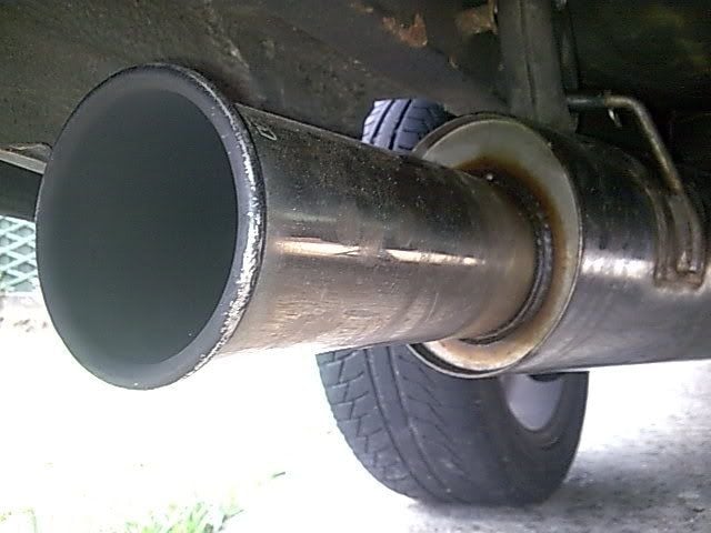

Nice new Scorpion stainless steel exhaust system from turbo back:

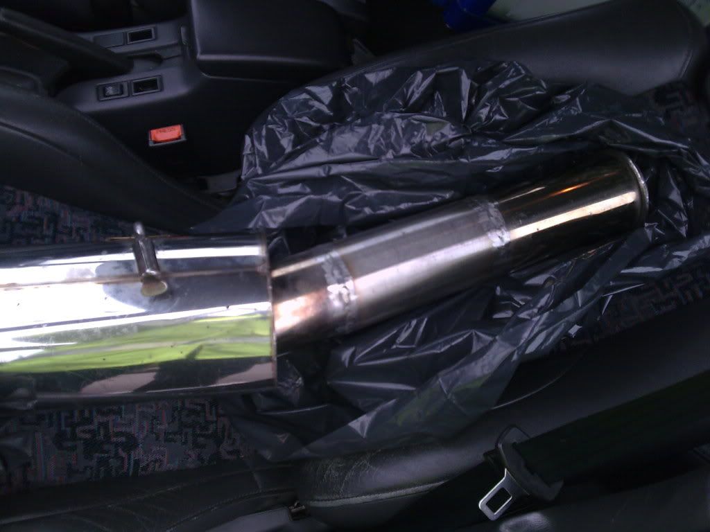

This exhaust does need extending, will be taking it into work to have 6"s or so welded onto the exhaust tip (due to the Orion being slightly longer than an Escort)

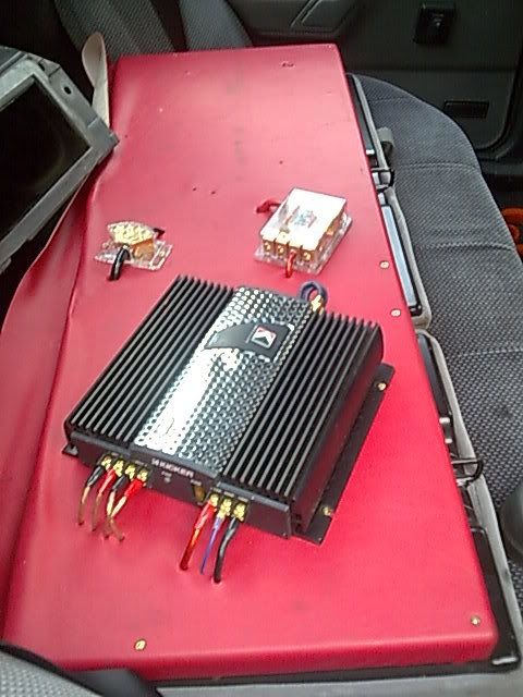

Kicker Amp installed behind the rear seats powering the front speakers:
Additional Amp will be installed next to it and a sub fitted in the boot.

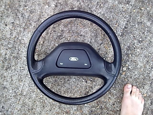

Got an excellent condition Escort steering wheel to fit too (and my foot):

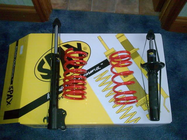

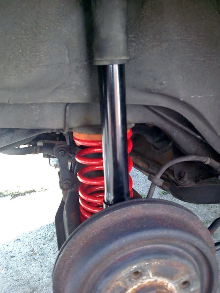

Spax Suspension turning up:
One rear side fitted, looking good with the poly bushes

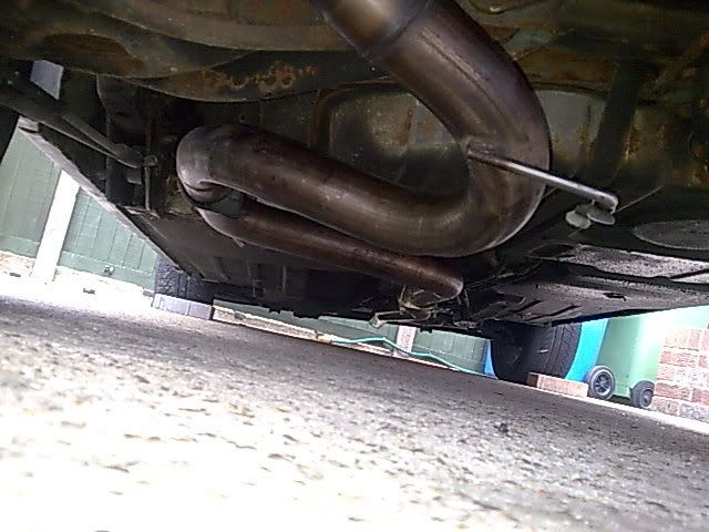

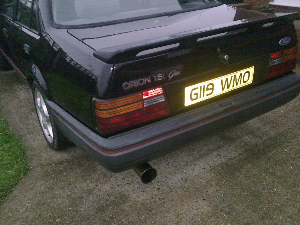

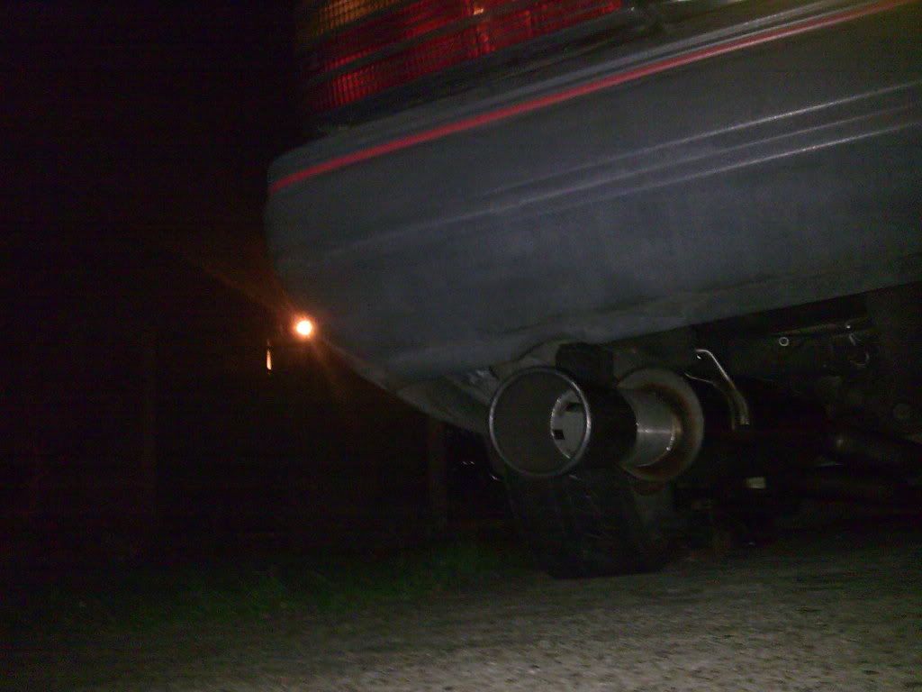

I've got my exhaust finally welded up. This has only been tacked and will be properly welded tomorrow. This was just for test fitting and as you can see its not a bad job. Not a bad job seeing as i got it done at work....and seeing as I work for a PVC drainage pipe manufacturer, it aint bad. lol.
Update:
Exhaust All properly welded up now
Then a photo in day light :)
Ollie
Whats with the weird and looks unnecessary U bend in the exhaust? and nice foot!!
You mean the unnecessary U-bend which goes round the fuel tank?
The Exhaust on the Orion and MKIII and MKIV escorts goes underneath the rear axle and because its so low it goes round the fuel tank so if the exhaust is hit from the bottom it doesn't dent/damage the fuel tank. Thats my best guess anyway.
Exhaust is all welded up and fitted. It sounds lovely!!

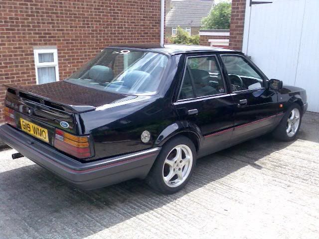

I like it, looks fantastic. My best mate has a MK1 Orion Turbo with the RS Kit as well shown here:
We're a rare breed us Orion owners, I love them though!!!

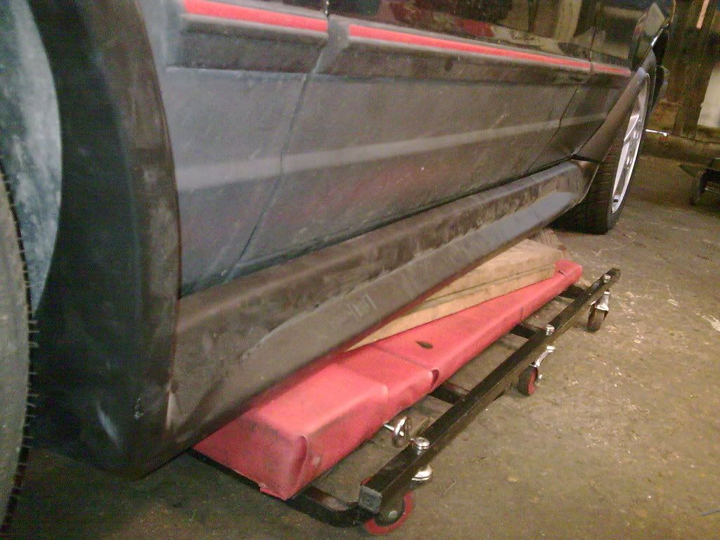

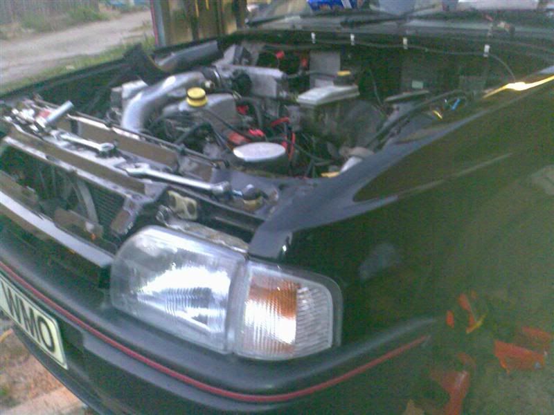

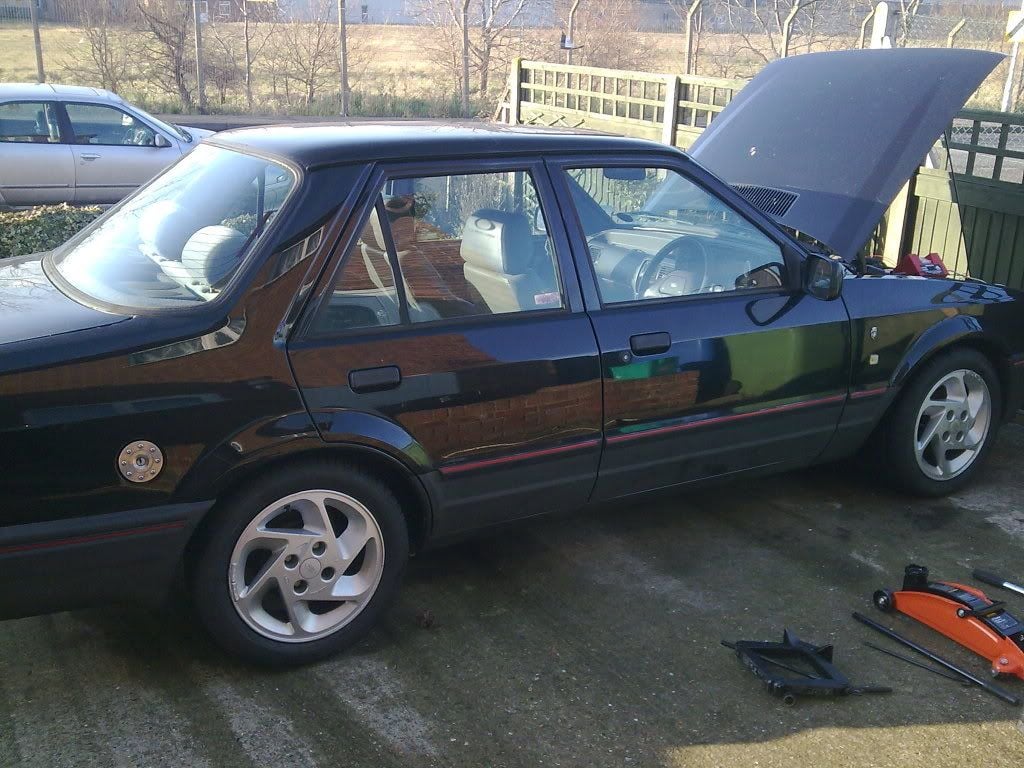

Got my car up my unit now, have fitted my Escort RS Turbo bonnet, have welded a patch over a tiny hole in my sill and now shes ready for an MOT test.

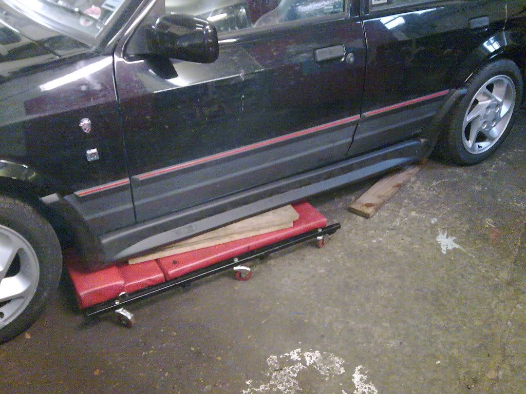

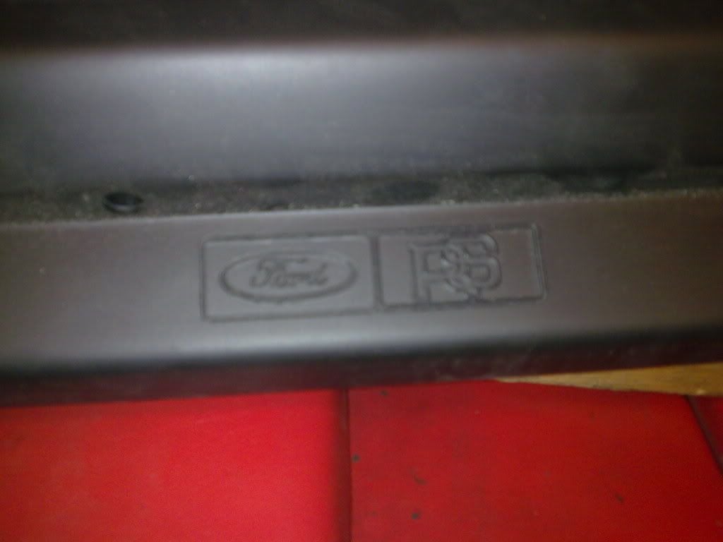

Got bored and decided to see what it'll look like with the side skirts on, these are 20 years old and i've only just took them out the packaging. lol.

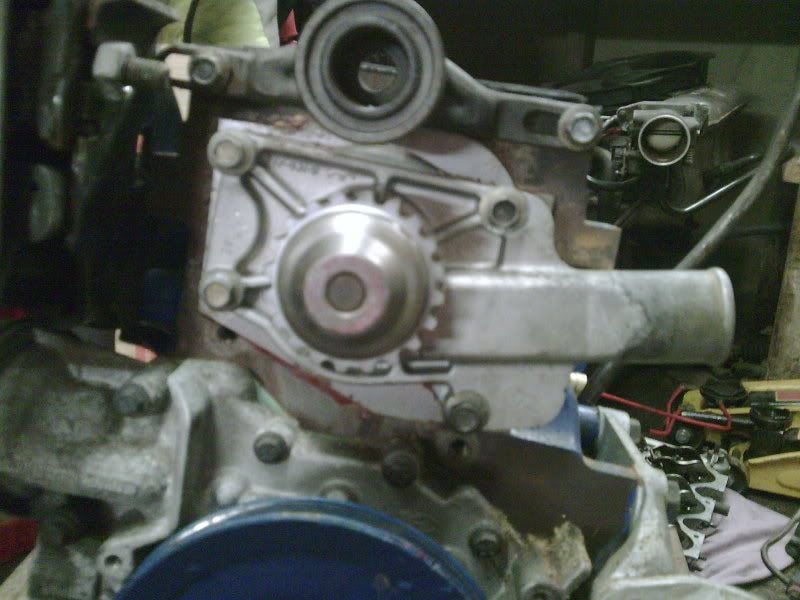

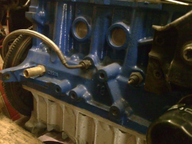

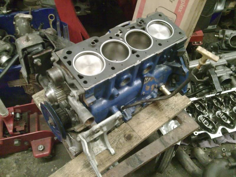

Q. What do you get when you take a 1.8 Zetec bottom end, blank off the 4 oil returns, fit some forged pistons, a CVH water pump, a 1.3 CVH cam belt tensioner, fit a crank case breather, an oil turbo return and then bolt a CVH RS turbo head to it?
A. A 1.8 forged ZVH Engine.

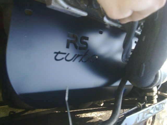

Ahhh, I thought you might of had a plain heat shield and went somewhere that does Laser Cutting, thought it might of been a good idea if I ttok my heatshield off and had it laser cutted. Nevermind, your car is looking great though, I used to own a Sierra 1.8 LX, I only drove it once and that was to the scrappers, lol.
Thats a usual place for a ford. haha.
Wouldn't be too hard to get your own one made up, Any decent engineering firm will do laser cutting. I would of done my own cad drawings and got one made up, but because they're so cheap for the ford I couldn't reallly be bothered.

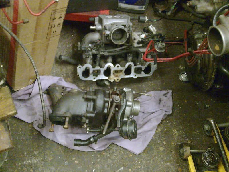

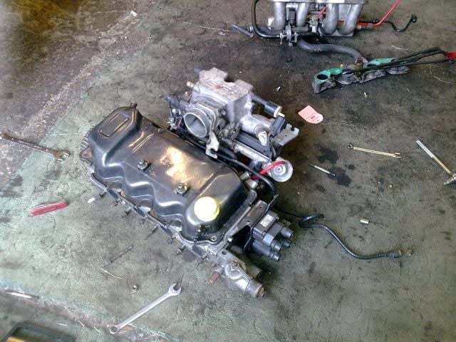

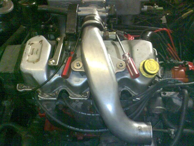

Head now built up.
Escort RS Turbo Head
Piper 285 T2 Cam (rated to give an extra 26 BHP)

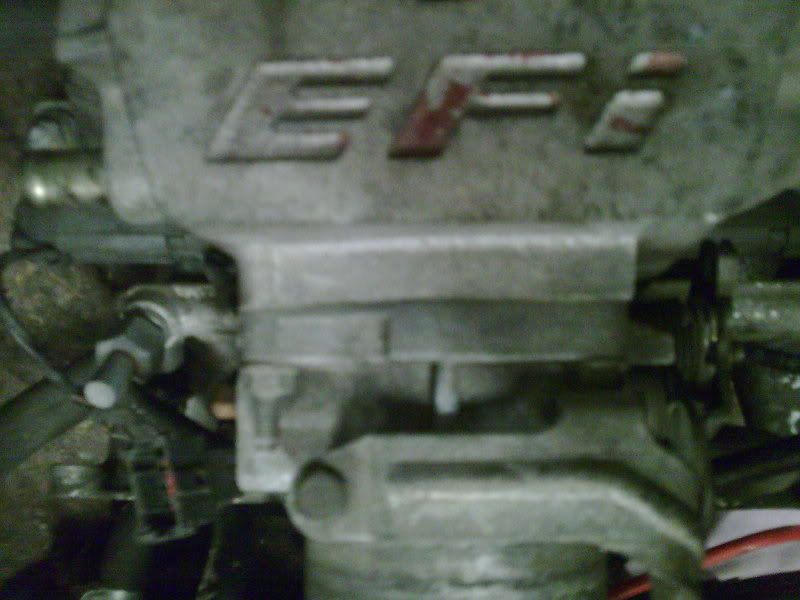

Fiesta Turbo Inlet Manifold with Beige Injectors (Think they are 240cc) this will do for initial running before the boost is cranked up

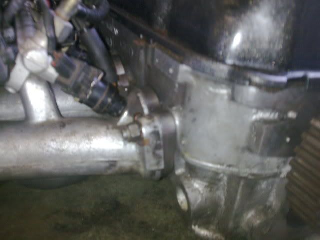

Adaptor plate to allow the EFI inlet manifold to fit to the MFI head
Ford EDIS (Electronic Distributorless Ignition System) same as Fiesta RS Turbo and other EFI CVH fords.
Just need to bolt it together and she's good to go, here's a couple of pictures:

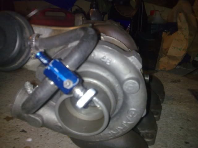

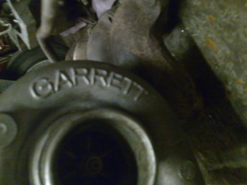

A Brand New T3 Turbo

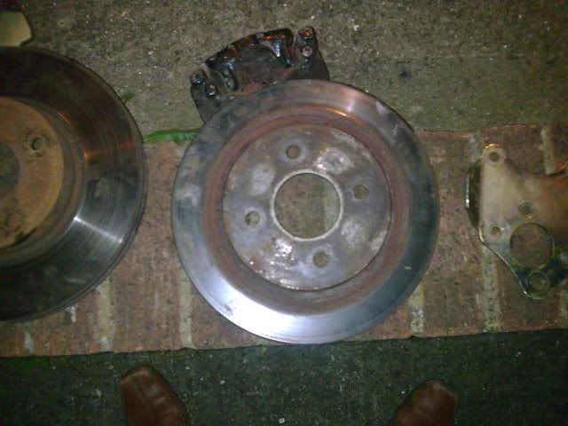

Sierra Cosworth front brakes with red stuff pads
Sierra Cosworth rear discs with brackets and handbrake cable.

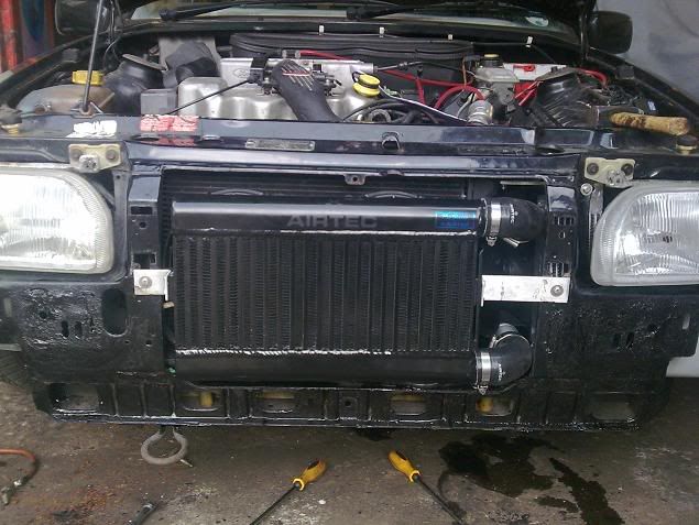

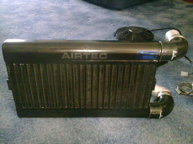

FMIC installed:
How it looks under the bumper:
Turbo cooler installed:

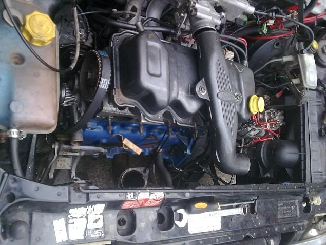

1.8 ZVH in, waiting for fel-pro head gasket to turn up (which is why the cam belt is loose)

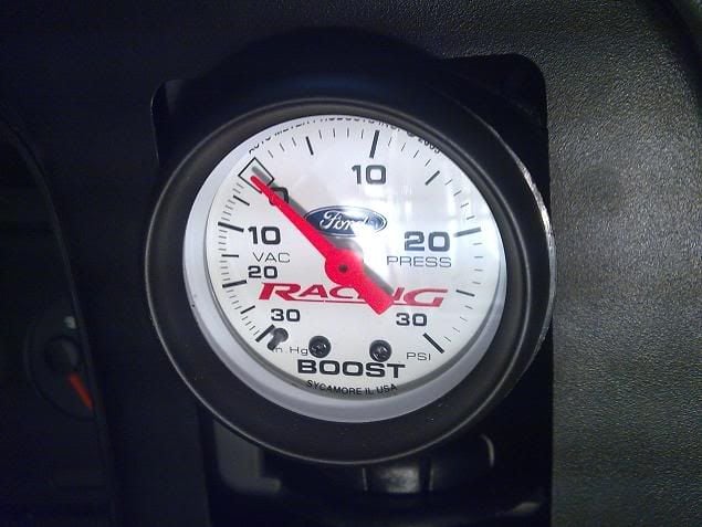

And I've loosely fitted my boost gauge:
