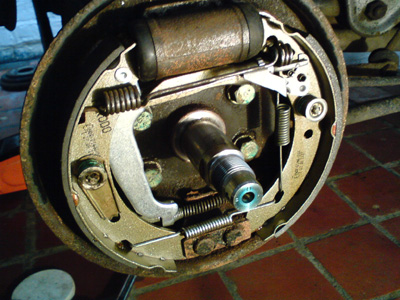

  • removing the hub makes access alot easier. knock the grease cap off gradually with chisel & hammer. remove split pin and undo the very tight hub nut with socket & long breaker bar. remove hub (1:00)
k550i-248-jpg.27790
  • unhook the lower spring (0:10)
  • now carefully remove the spring loaded brake shoe retainer pins, don't lose em (0:30)
  • unhook and remove the shoe from the bottom groove of the backing plate that it pivots on (0:10)
  • unhook the cable from the handbrake lever on the shoe (0:10)
  • check the shoe thickness and replace if needed (1:00)
  • always disassemble the self adjuster, clean the threads with brake cleaner/rag, regrease then screw the self adjuster ratchet nut all the way in (5:00)
