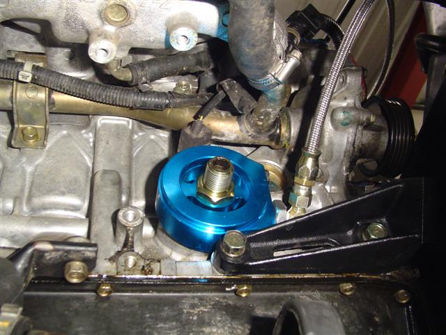

ok its official it will not fit!
heres a pic to show you how tight it is. theres no way any adapter plates will fit in there no clearance at all on either side.
BTW most jap cars have 3/4 thread size for thier oil filters. Just in case you wanted to know lol
As for now i will save the peice of kit for future car.
Type-R said:
how the hell did this guy get this to fit? and i dnt understand the angle of the shot!!
it's same angle as your pic, but the inlet support bracket has been removed ('Y' shaped, 3 bolts).
