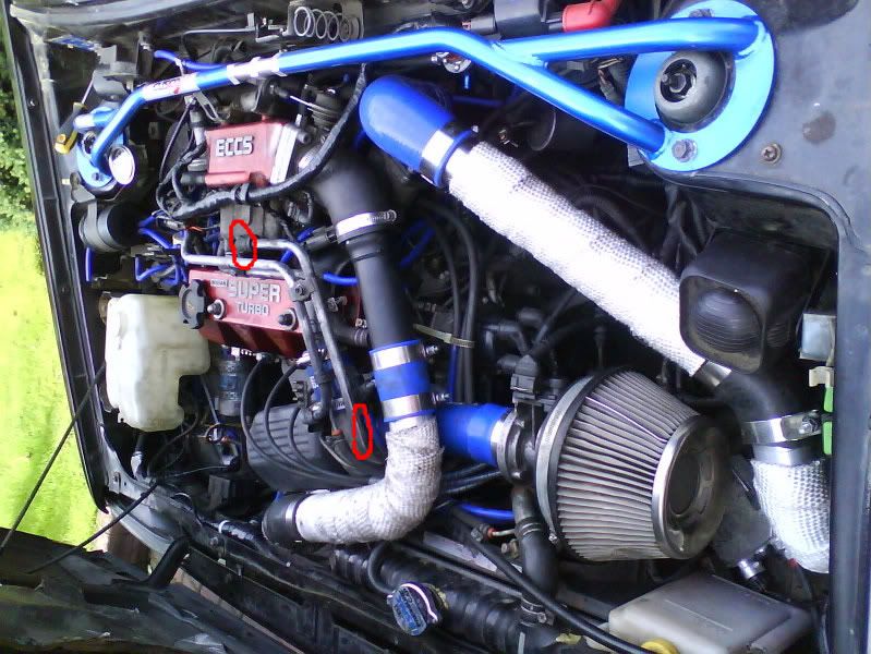

Right lads I've aquired a new oil catch for a good price that I could'nt turn it down just wanted to know what the best way to pipe it up?
Off this breather?I want to incorporate the PCV in to it so all the vapour is condensed before it enters inlet/turbo inlet
Anytakers????
Disconnect the PCV and block it on the head and manifold. Then use that pipe circled and feed it to the catch tank then if you want into the turbo inlet.
Cool,thanks What you reckon gimic mod?
