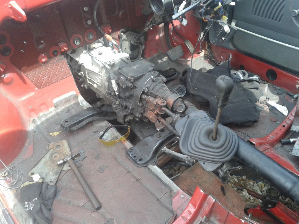

So I had to finish my gearbox mounting (still not done it yet)

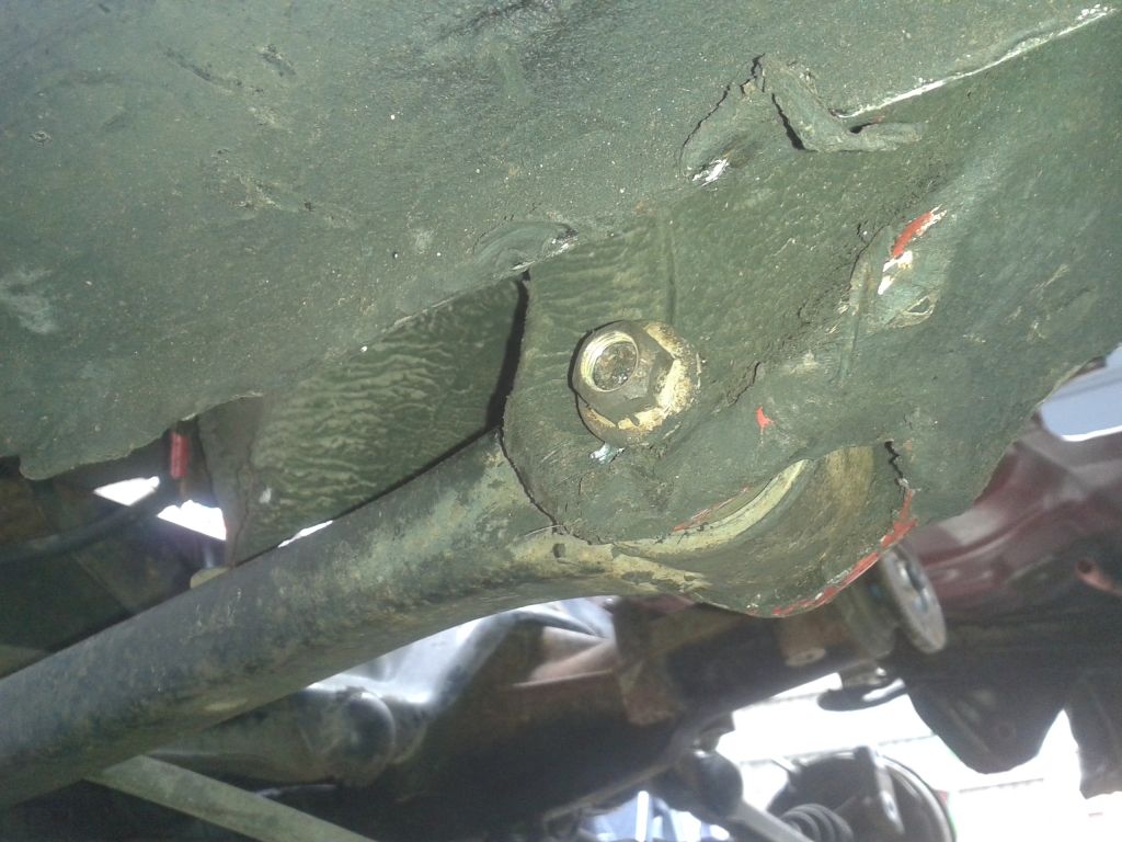

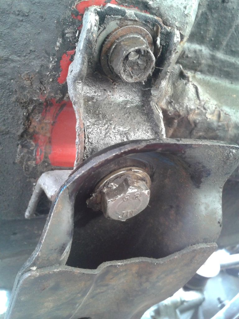

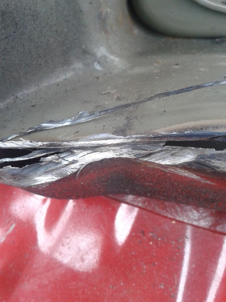

Wanted to start by showing you all how thick the k10 is in places. Triple layered 1.2mm steel

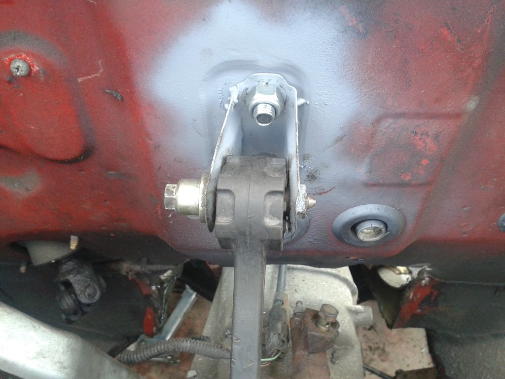

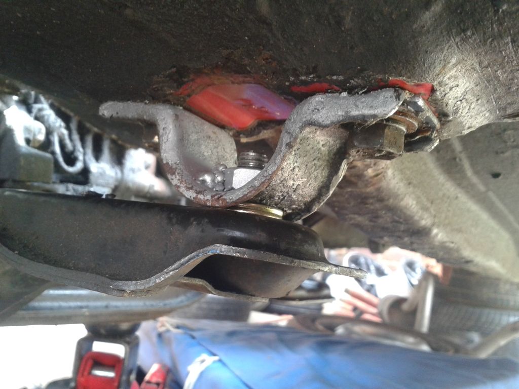

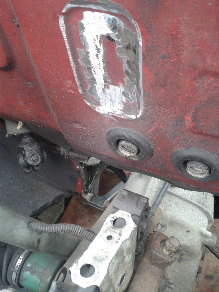

Here the old wishbone mounts converted to subaru gearbox mounts. Millimetre perfect. No drilling required :confused::D
Passenger side
Drivers side done slightly differently
I'll see which I prefer before making some proper tough ones later on

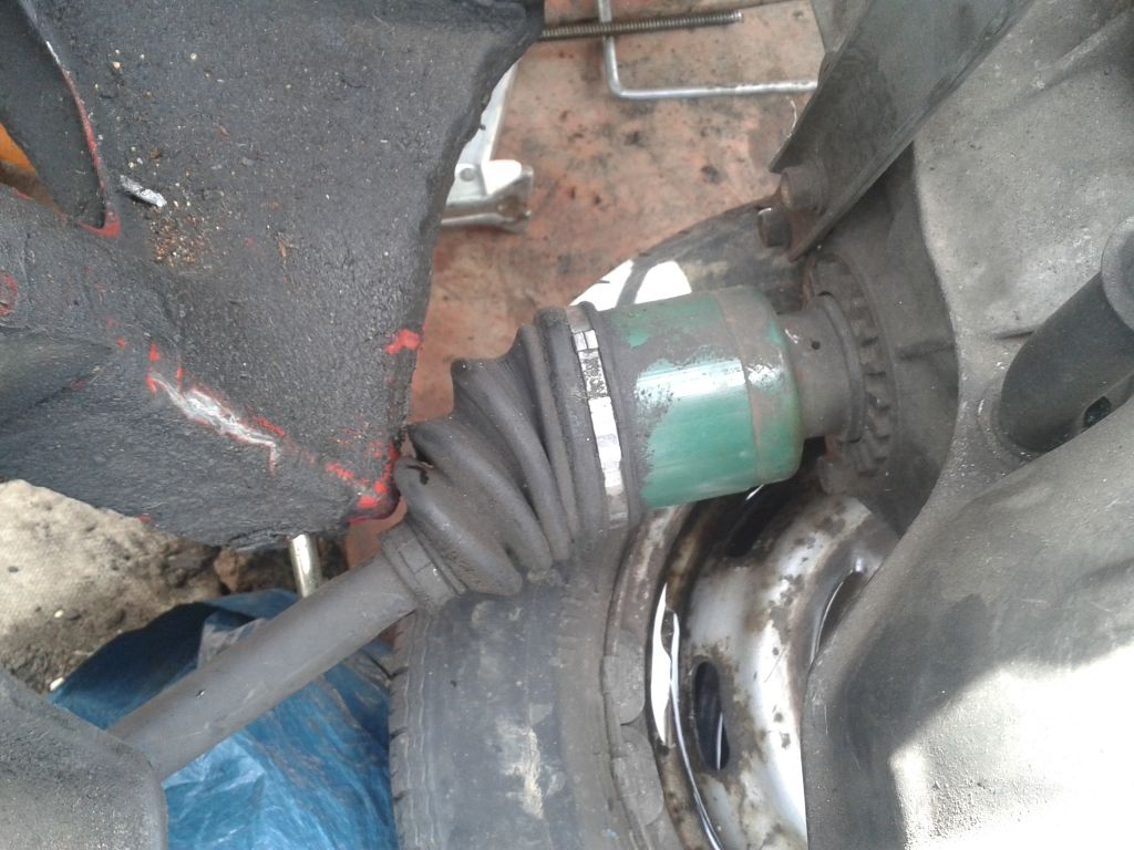

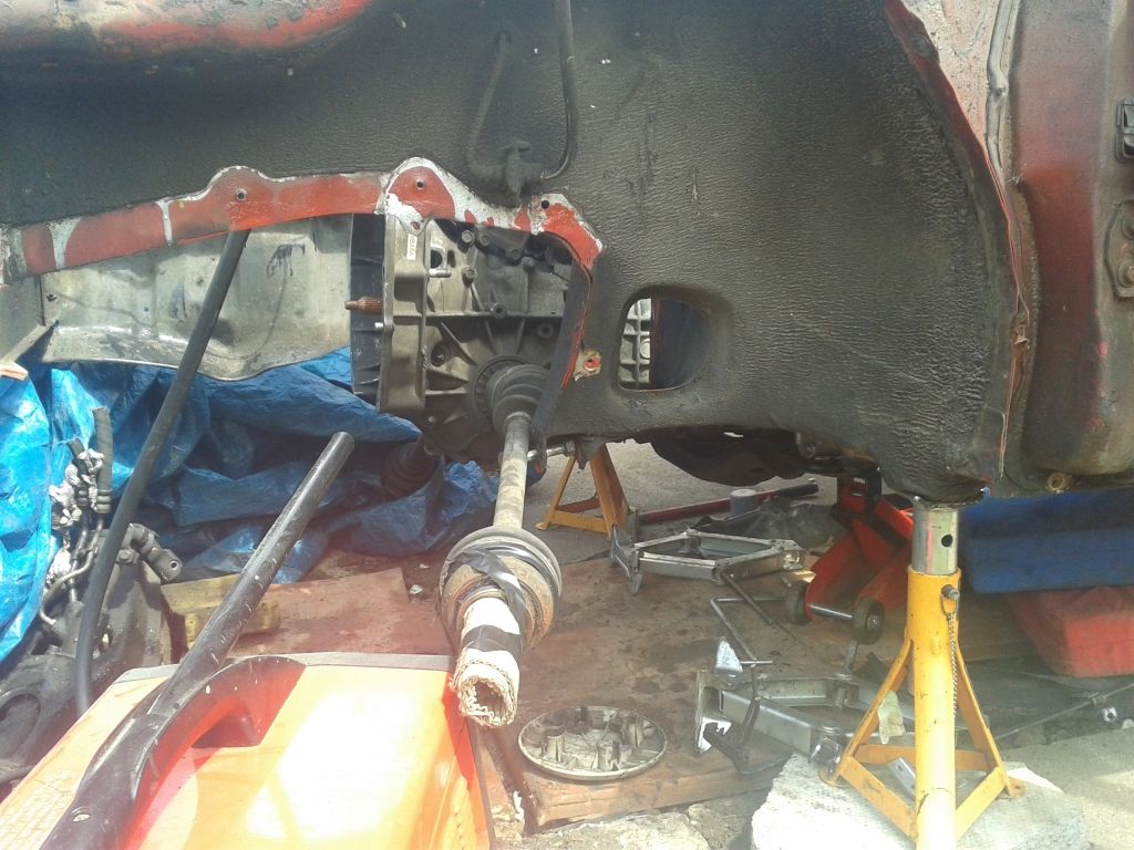

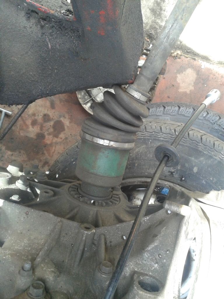

Next is how the driveshafts sit... cant be having this so major rework comig up
I'll stick the rest in a different post after I've eaten my scran :)
Mate wouldnt it better if you pushed the transmission further into the car so the shafts can go true the holes (or does your steering rack interfere with that)? And since your transmission is at the place where your air-warm heating thing should be (idk how to call it in english a/c?) how you gonna solve that? any pics from the inside? This is gonna be one hell of a car when it's ready :D
Those holes are for the old steering rack. I can't push it back coz I'll increase drive shaft angle. Which will severely limit the cars capabilities.
Plus I have to keep them where the wheel centre is on the k10 shell at the same time as ensuring the prop is straight and the gearstick sits in a place I can actualy use it. It can't be adjusted.
Any further forward and the engine wont go in.
Cant go forward, back or sideways.
I've made a happy compromise on it :) appreciate the interest though

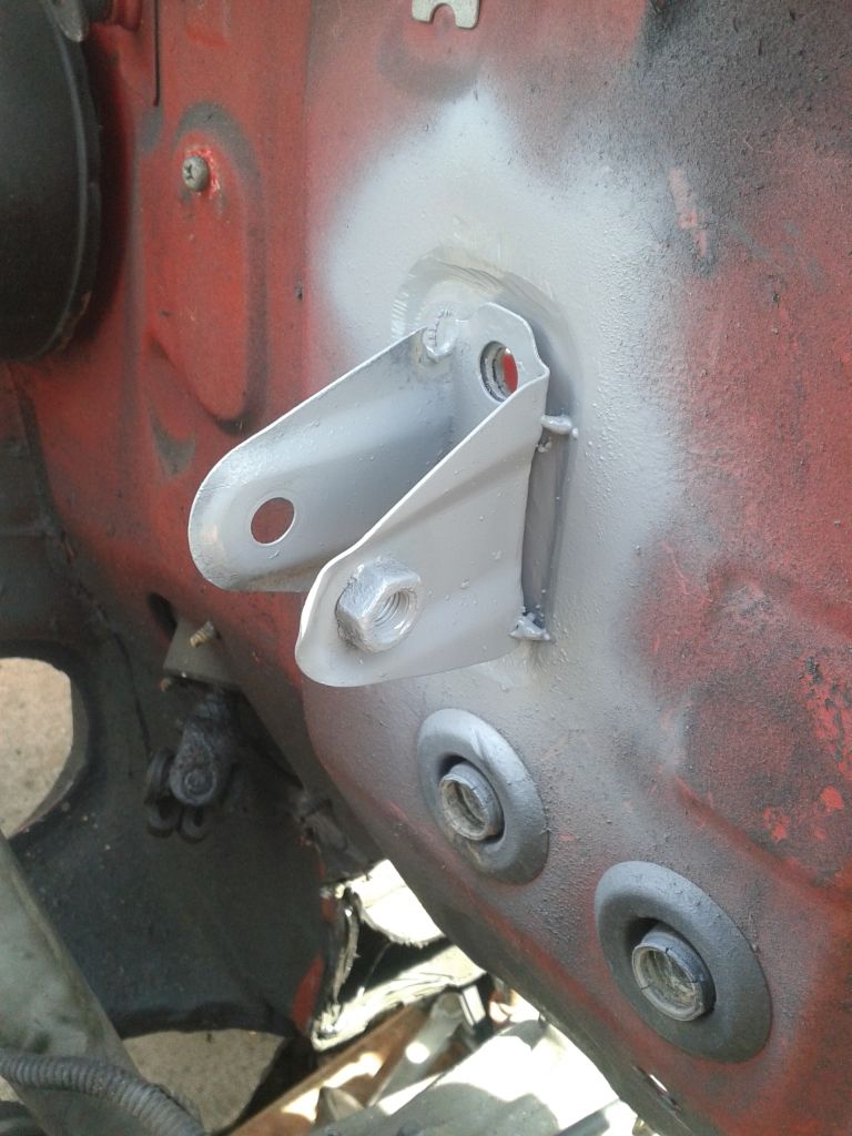

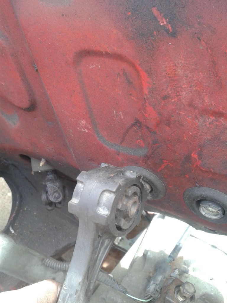

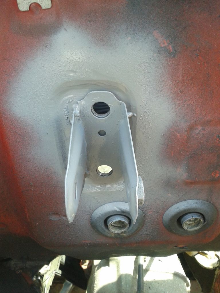

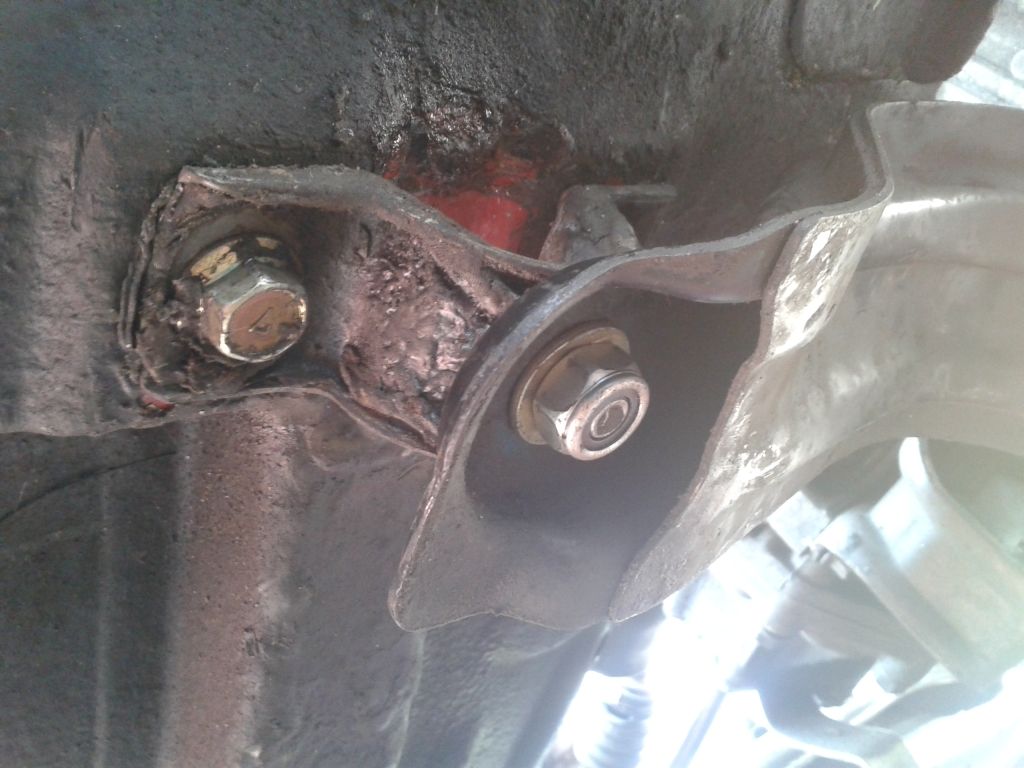

So.. that front mount
Grind clean
Braved the rain and wind with the welder (it sort of worked) tacked it into place and gave it a coat of zinc oxide
Holes drilled for bolts
Bolted up and ta dah! A front mount

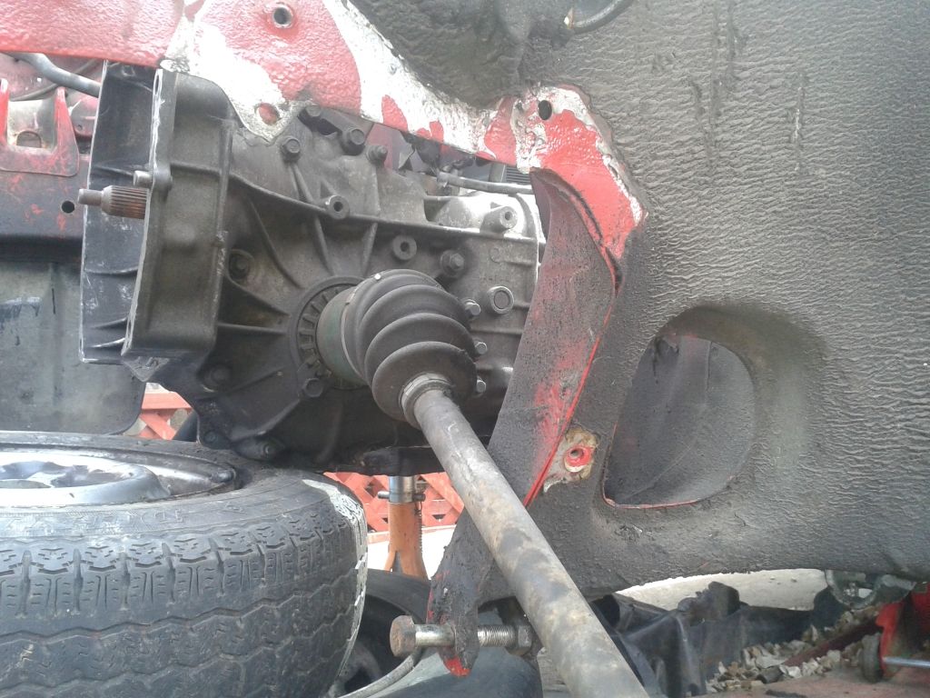

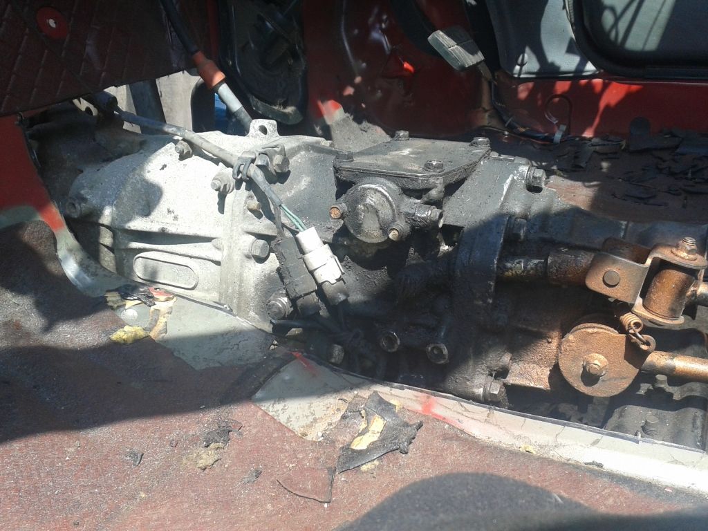

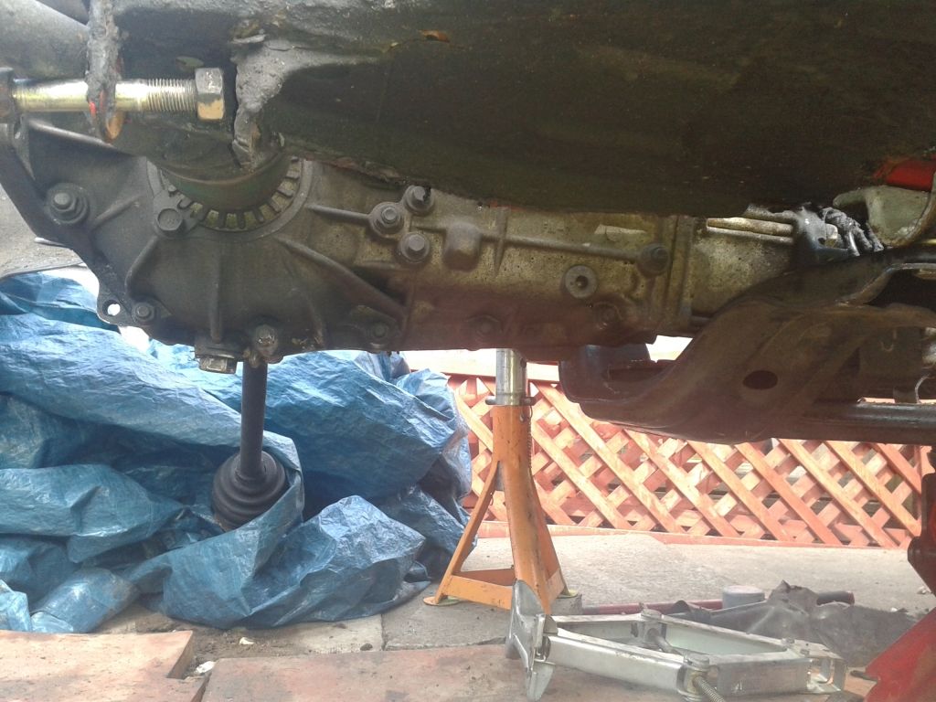

So how does the gearbox sit? Well a little like this...
Even the speedo drive is in place
Sits a bit lower than I'd like but like I say I've had to compromise
I'd love to but I cant :)
Chassis has to be modified anyway for the engine regardless of which way I move the box.
Its really hard to show it through pictures but there really is no other place to go without giving me a dodgy driveshaft angle.
Not to mention the wishbone front mounts are on the steering rack subframe which attaches to the gearbox and has to keep my hubs central to the arch.
Plus hanging the engine any further forward will make it handle like crap too
Its all thought about :D if anything it needs raising 5.5 inch to put the driveshafts in the correct place and not run inverse... hmmm must look into it now rather than later... thanks glen :D

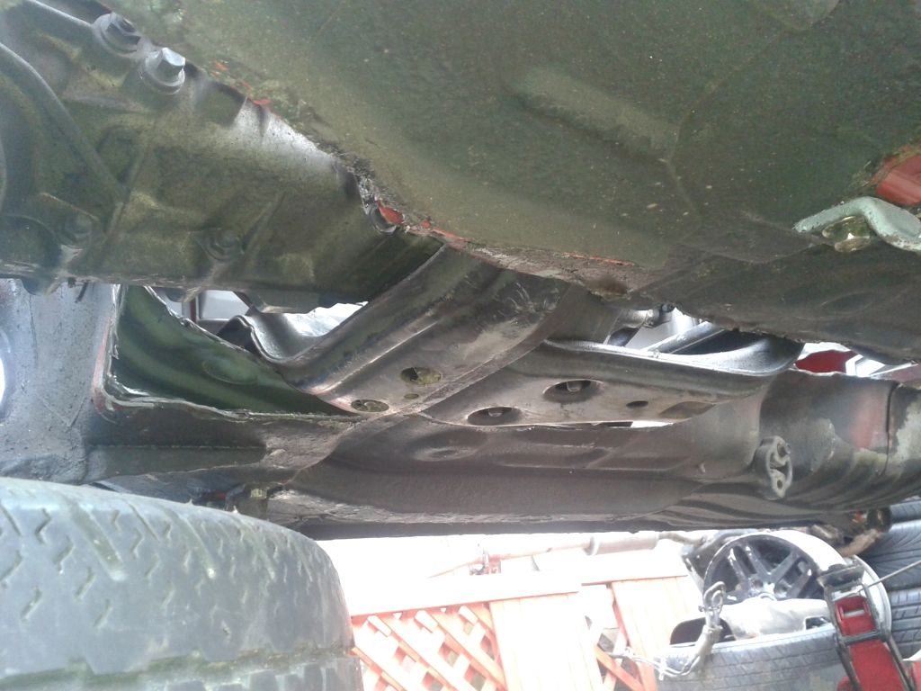

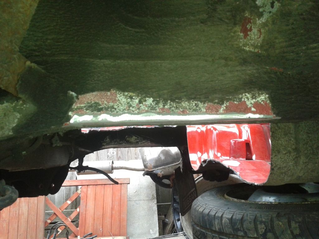

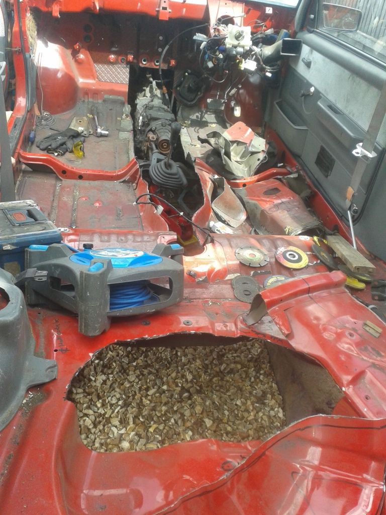

Tunnel cut

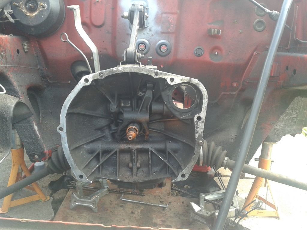

Gearbox raised 5.5inch... loadss better
More tunnel to make
Hard to show in a picture but there's proper drive shaft clearance
Looks alot more flush :)

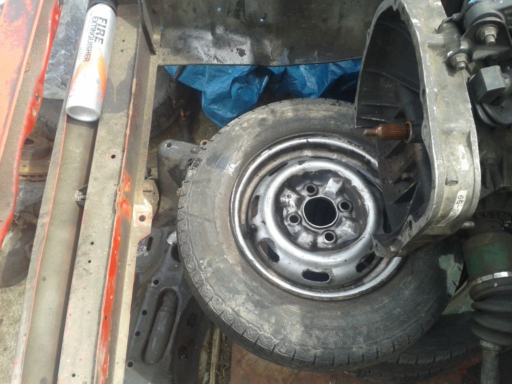

Engine space... still tight :p... actually its half inch either side clear and there's room for the crank pulley too. Only issue is getting the engine in.. it has to come forward and slide over the 2 inch gearbox spline in a 1 inch space. I love my projects :D

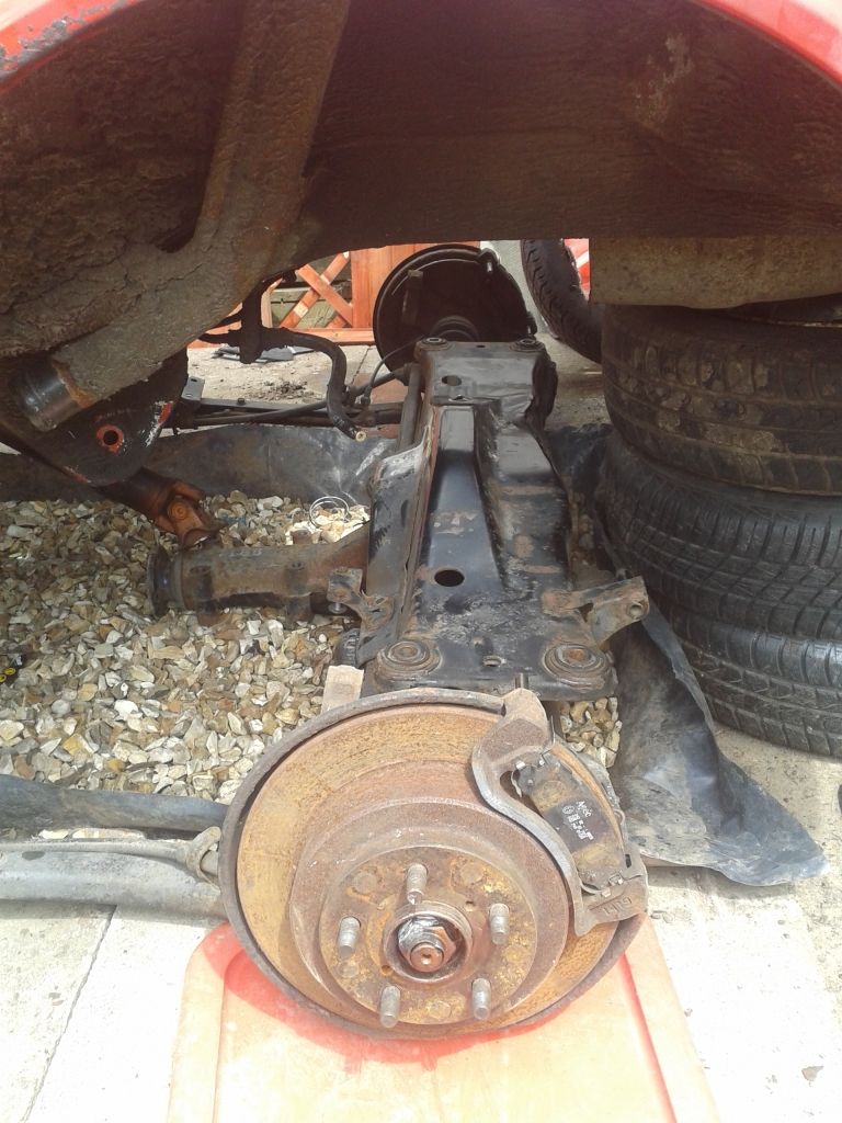

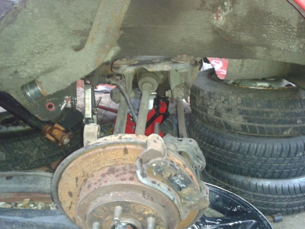

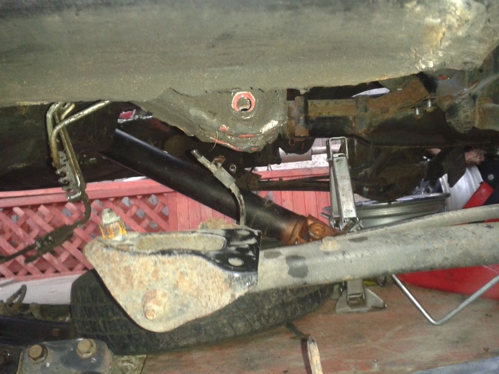

Rear setup put it in place. Believe me it wasn't easy
Slightly wider than original
All lined up

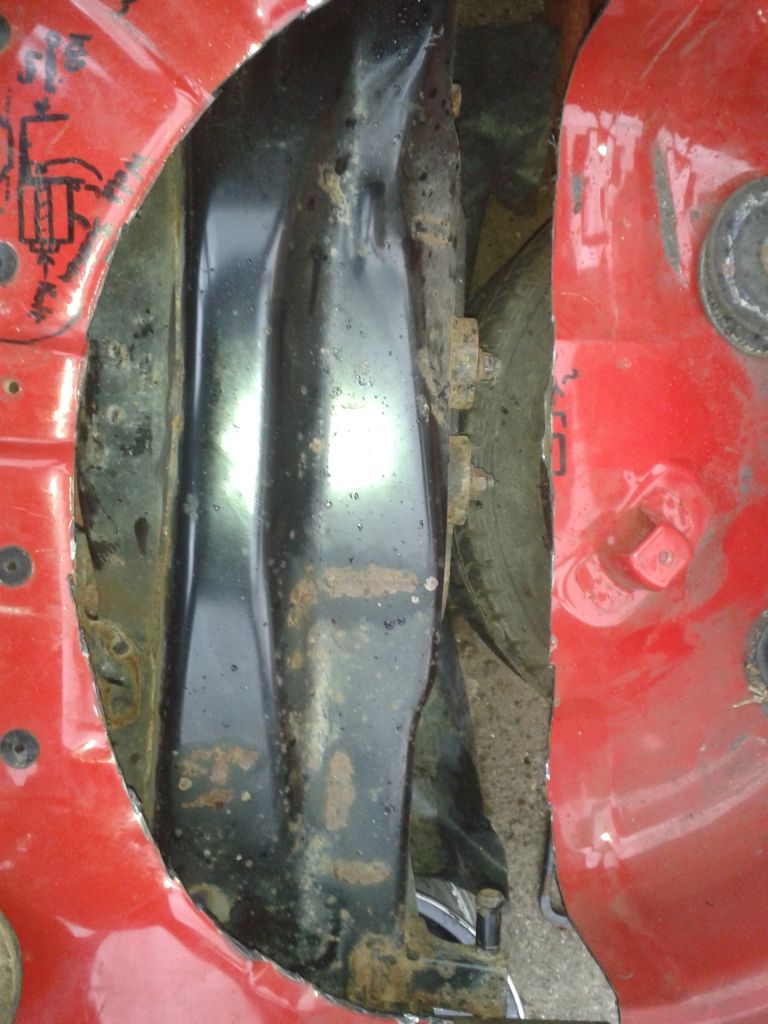

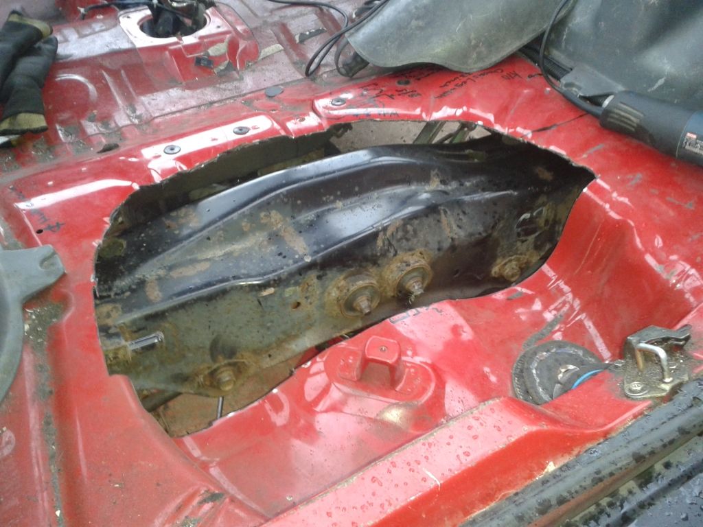

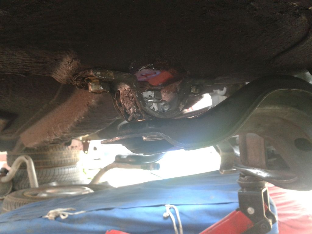

So time to raise it up. What a nightmare. 2 scissor jacks and a trolley jack later I got it raised in place
Cut more wheel well out to make room for the bolts I didn't account for
With the extra 3 inch clearance I can move it back. And raise it passed the chassis arms too leaving it intact :D
It also brings these scarily into line ( when I move it)
So when the rain buggers off I'm hoping that all drops inline and that's half a headache out the way
Just the prop then :D

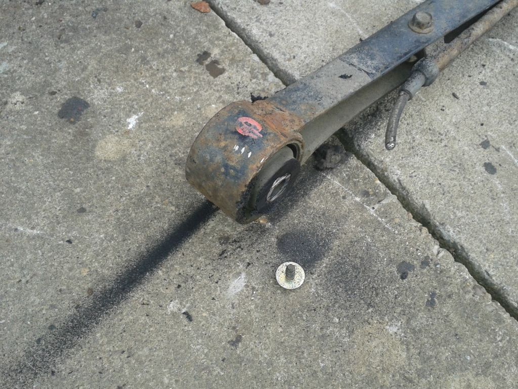

I then proceeded to drag it out again... back ache much. Just aswel RTLkyuubi (Ryan) was here pinching yet more parts off my apparent rare model k10

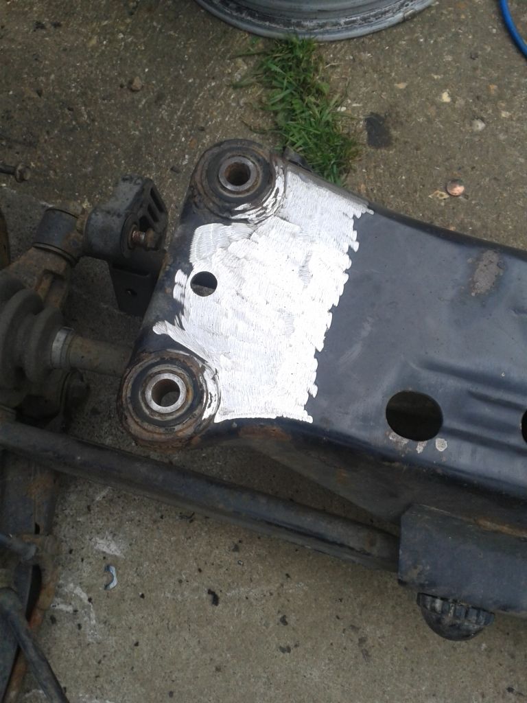

Cleaned the subframe up
And the chassis legs
Trimmed down the scooby bushes

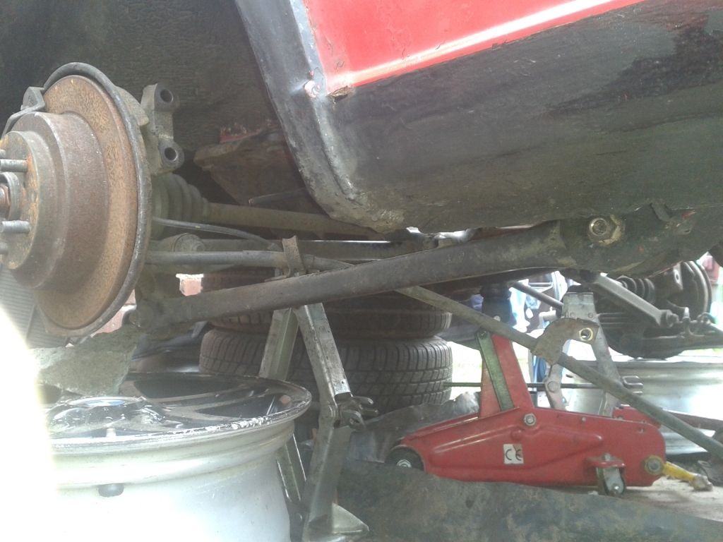

After a long old struggle I got this in place
And it bolted up nicely
Now after alot of swearing, crap in my eyes and a few new cuts and bruises I got the other in
This is the angle they sit at

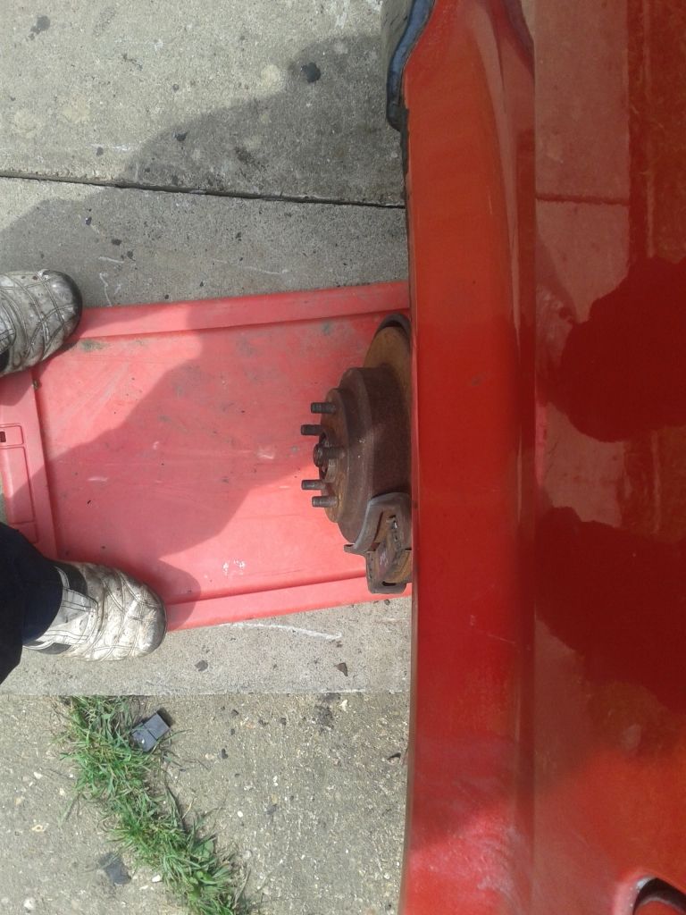

And the wheel hub is way off centre... I prefer simple fit 4 wheel drive. Mid profile 14s will be fine.. if I can get em. If not 15s and elastic bands

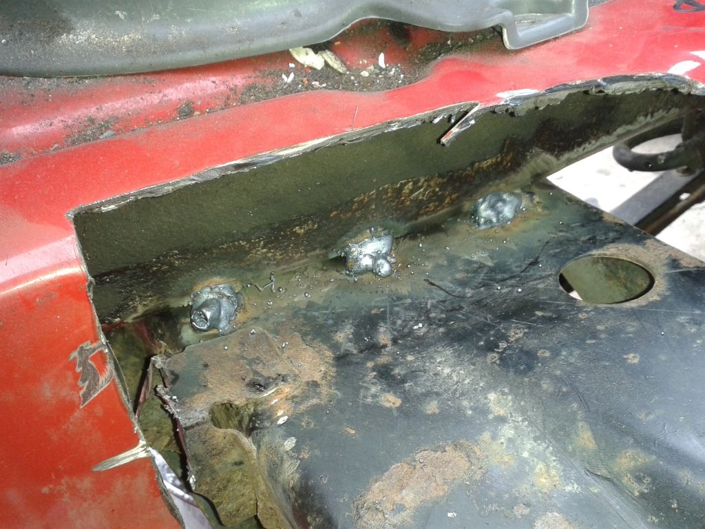

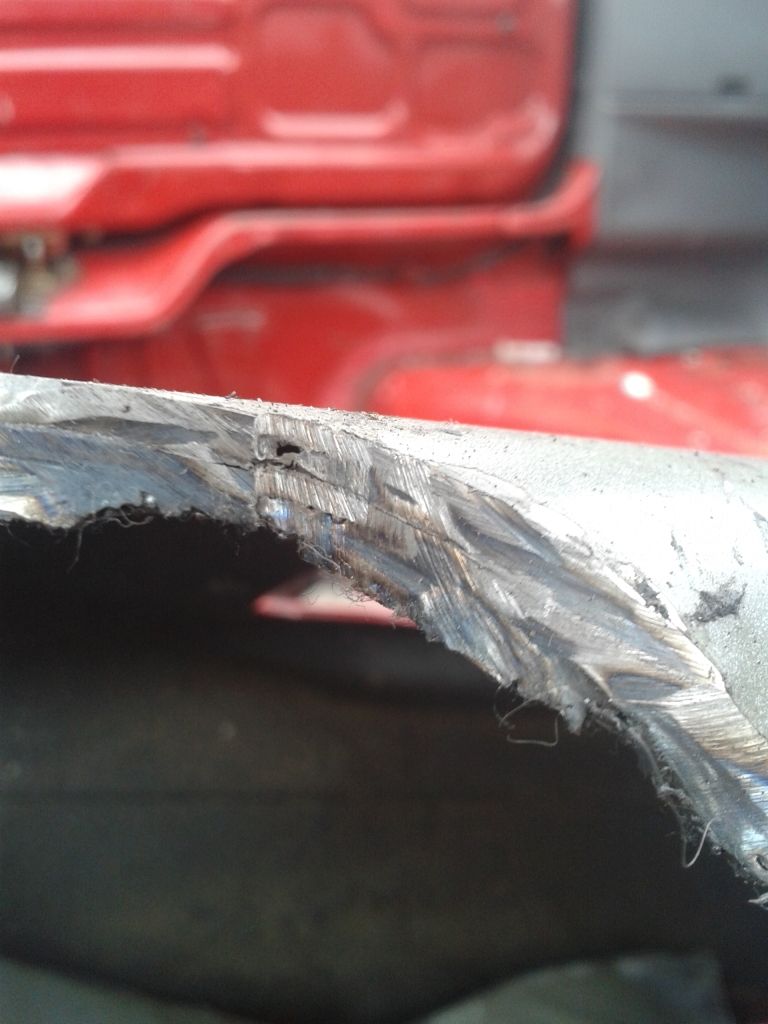

Onto the reason I cleaned the above up. I welded in place after checking it was central
This ran out
But I pushed on
[IMG]
So that's my day. Doesn't look much but it was all hard work and I'm pleased with the result (apart from the welding)
