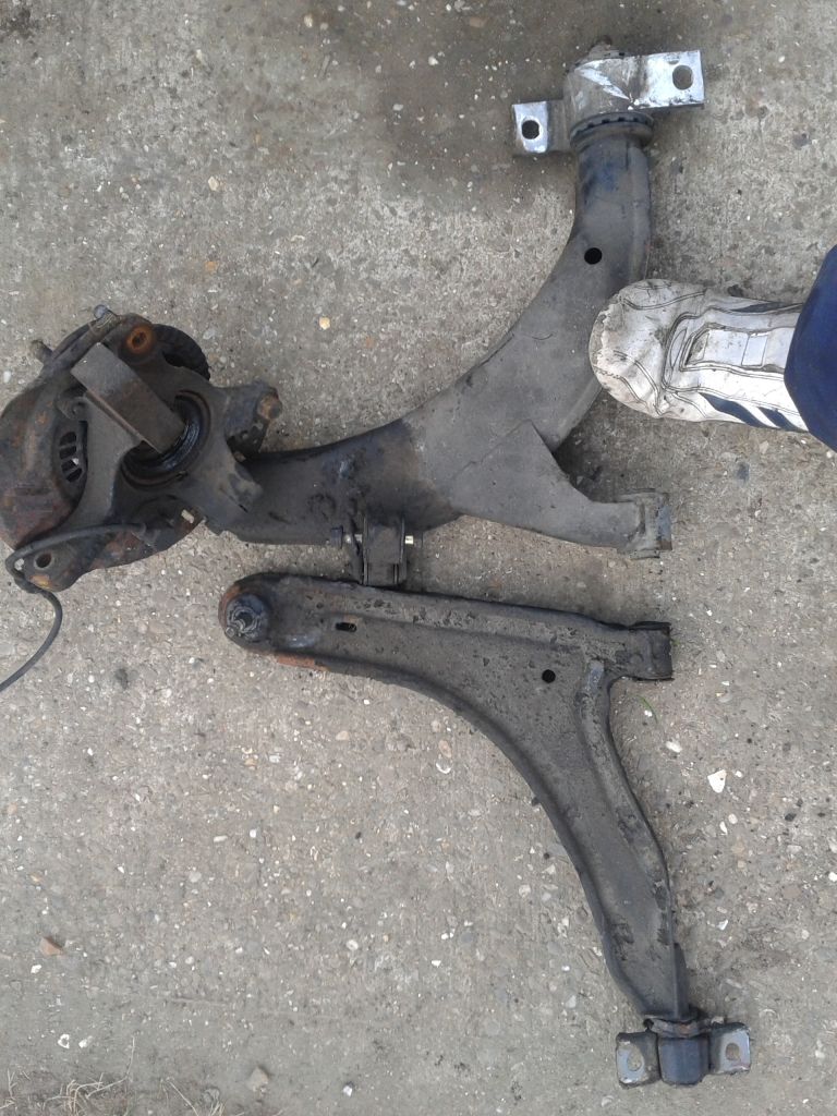

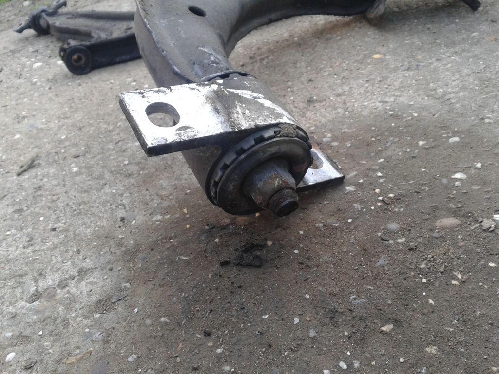

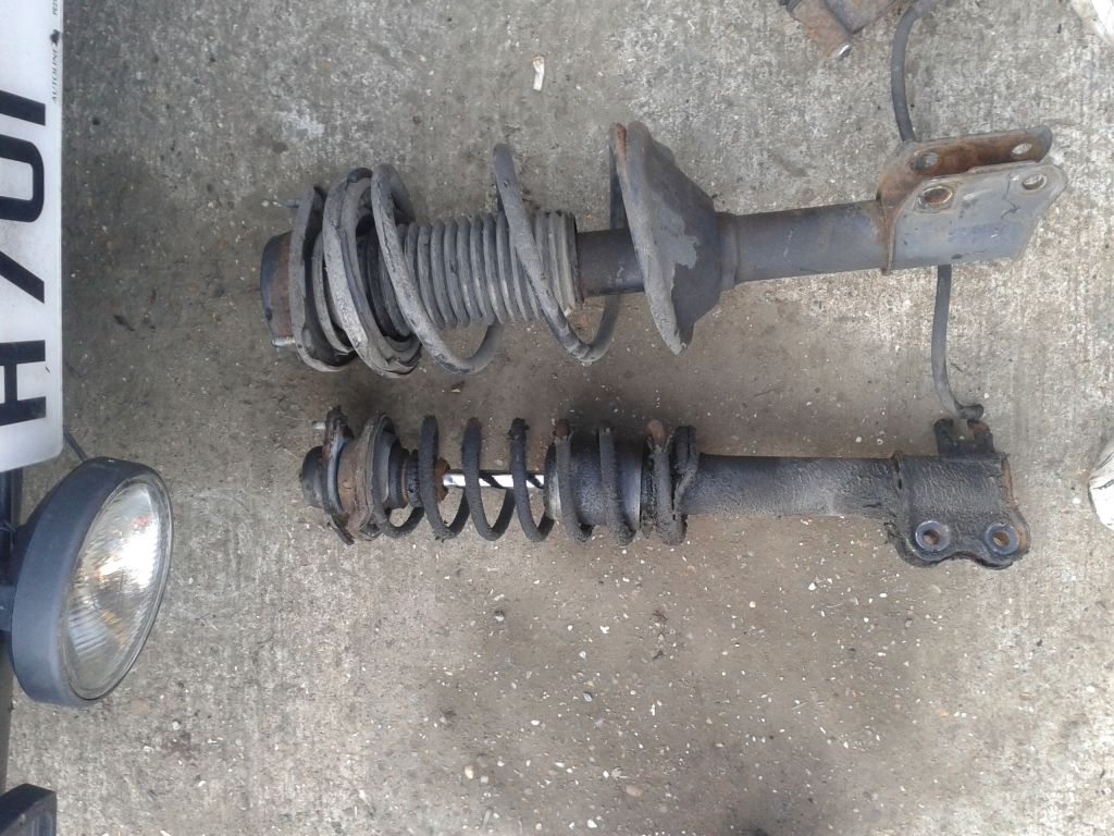

Subaru impreza wishbones are nye on identical to k10 ones. The only reason they wont fit is the ball joint for the hubs is a tad large. You'd also need to either change the rear bush or drill and reinforce another hole 10mm behind the original.
Personally I'd custom polybush it and use the micra mounts
Being as I'm running an ej20 I haven't got to worry about the ball joint. Pics to follow soon...

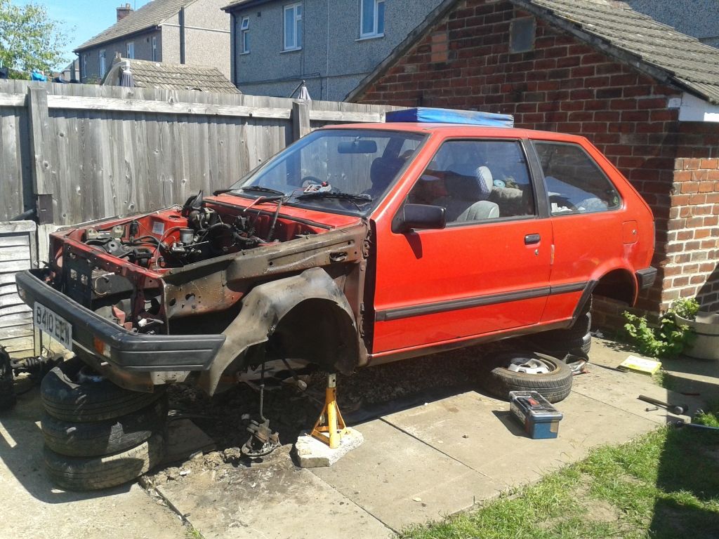

Just thought I'd clear something up with you all. This was near finished a while ago running and moving etc. Yet its back to square one.
So why am I back to the start? Well our white donor shell was verrryy rusted but with most of it going to be renewed to accept scooby parts it passed us by. Its when it came to final mount making that it got too much. The materials we woulda needed to get it built would of cost exactly what I paid for an absolutely beautiful example of a k10. That I'm now breaking for spares (mine has enough spares now)
So its being reshelled at my place instead. Which means just me on a driveway and my tools in my spare time. Instead of 5 people, a lift and bigger better tools going at it all week :)
Its just going to be slower than expected now with just me doing it but I'll crack it soon (I've technically built it once) except this is an auto so I've pedals to do too

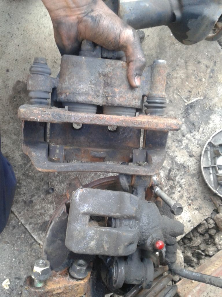

I am I am... I keep getting stopped by little things like the seized brake pipe bolts. Handbrake cable refusing to leave the car.
That much waxoil and crap I'm struggling getting to the bolts on everything. The stripping and prep of the micra is going to take longer than the build itself :(

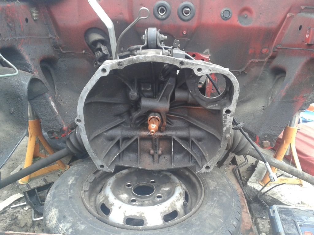

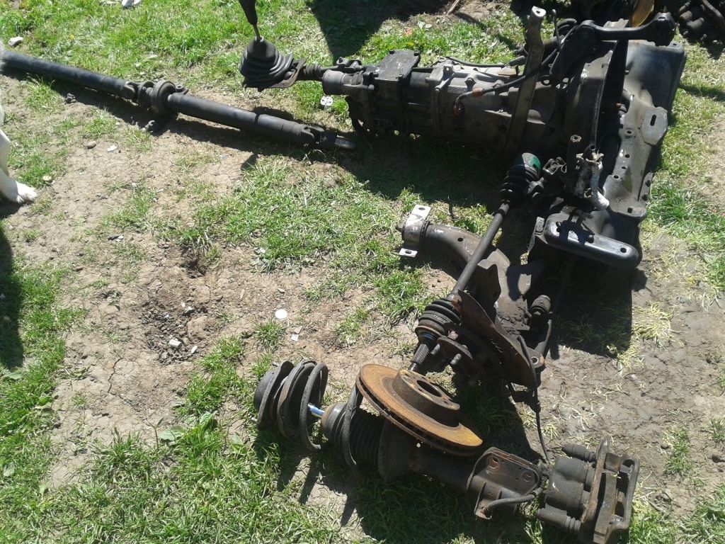

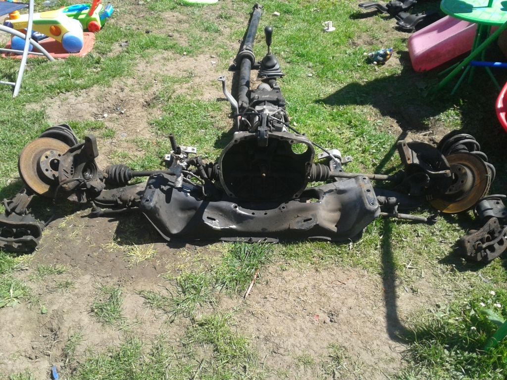

Incase anybodys interested in how tight a fit the subaru engine etc is in a k10
The front panel is where the engine touches
It slots millimetre perfect in the front of the chassis legs except.. they narrow towards the back so they have to go.
On the micra your driveshafts sit central with the steering rack behind. In this special case its the other way round. What a fiddle I've got going on. Thankfully its all subframed

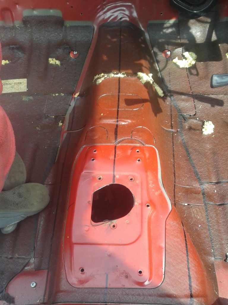

Tomorrow the tunnel gets cut out
And the gearbox will be mounted should all go to plan. Just have to get some steel :confused: to make my bits n bobs up
Still no pictures though unless you wanna see a subaru gearbox laid under a k10? And a bare shelled k10 with permanent marker lines on it

There's a subaru gearbox under there ;)

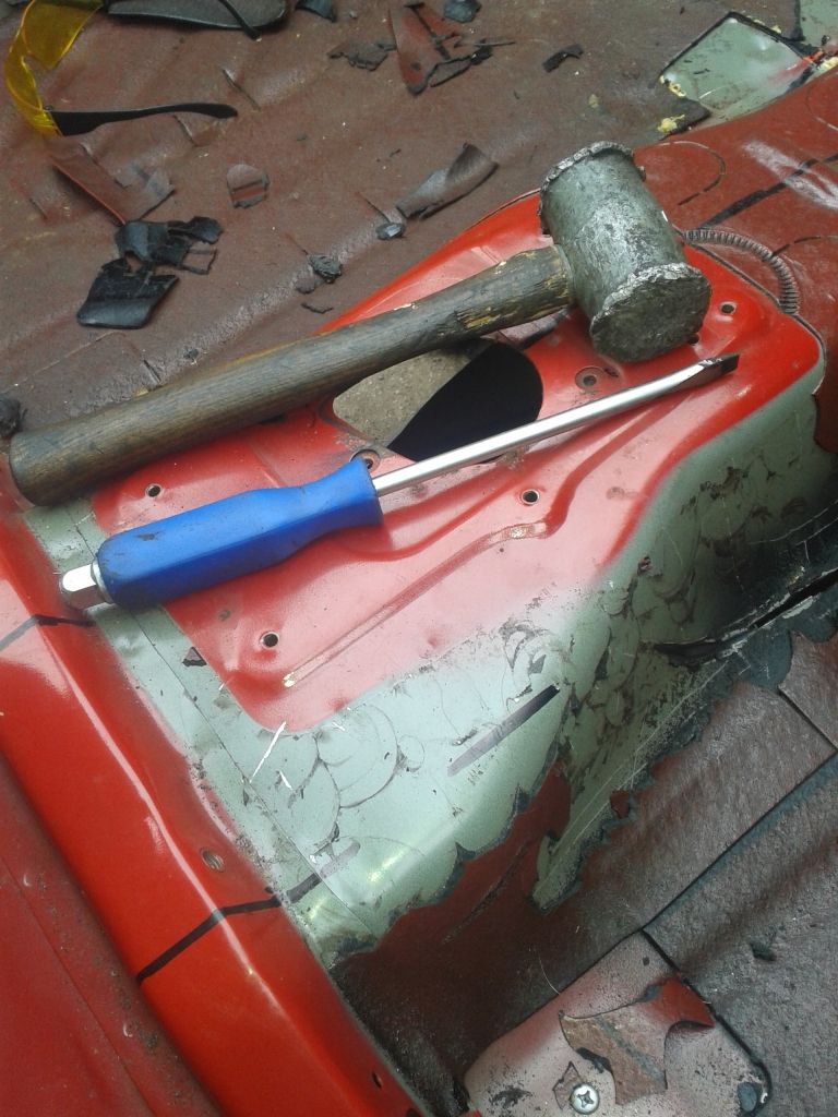

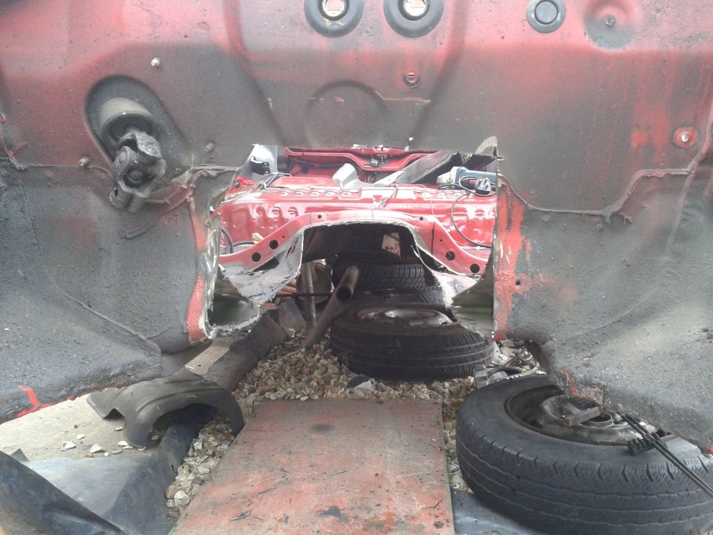

Dam micra is bloody tough with its 2mm double skin it takes some cutting
Tested the gearbox clearanceat the back etc. Beautiful
Its a careful process I dont want to be crabbing down the road so lining it up has to be precise. Once this is in the rest should be alot simpler.
Less cutting more fabrication which is more my thing
Yup 80mm eithet side too narrow. But with it being subframed its easier to work with as that takes care of the wishbone mounting points

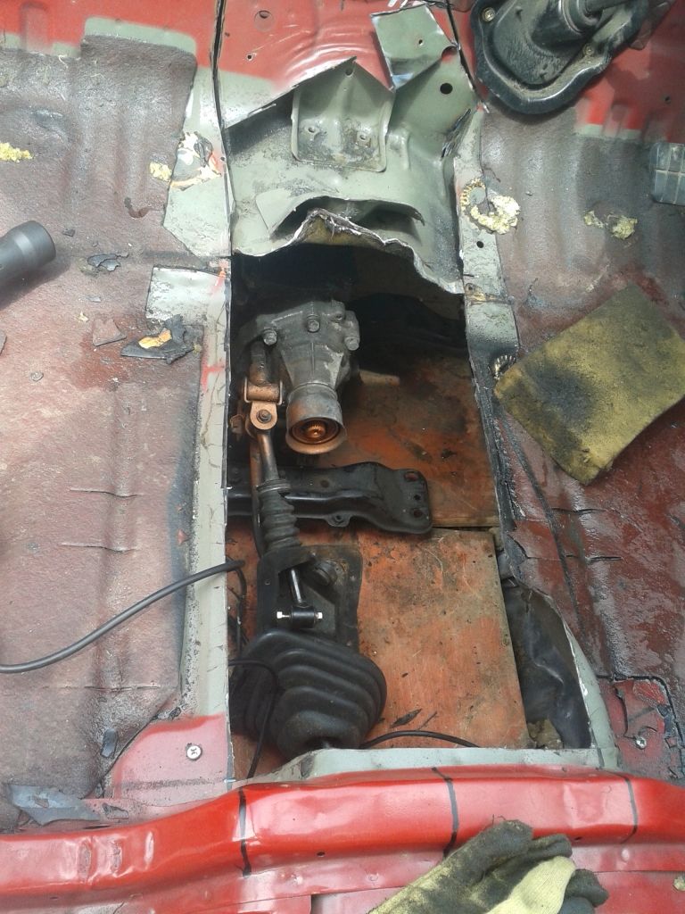

So more pictures. Today was a success... sort of

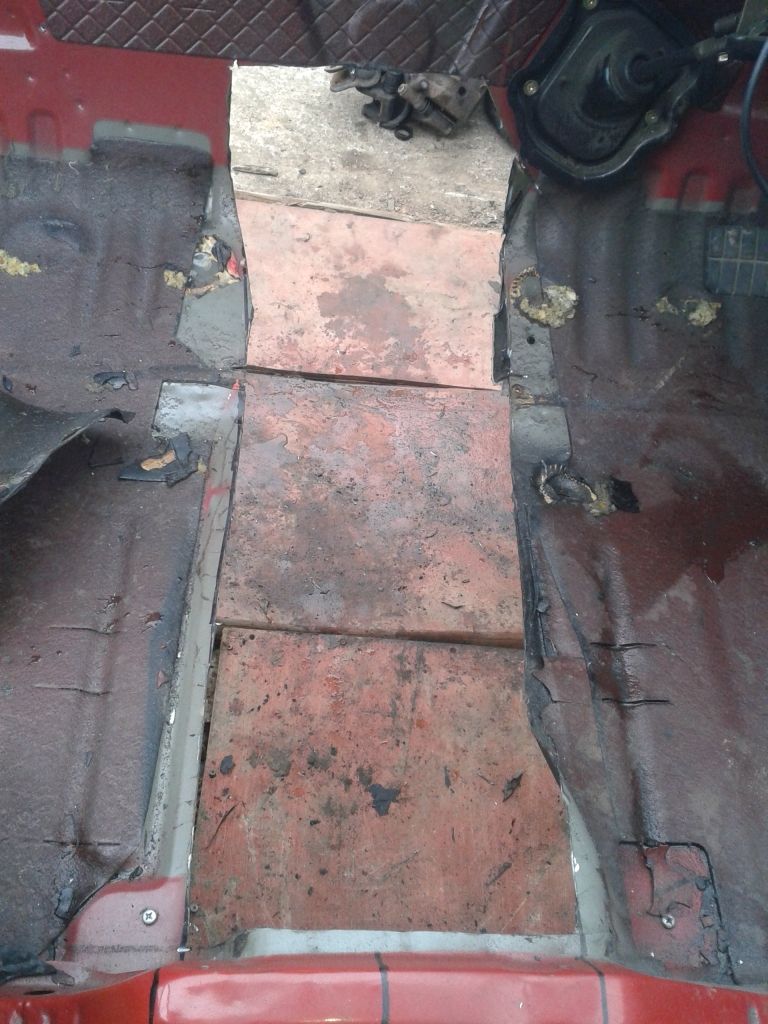

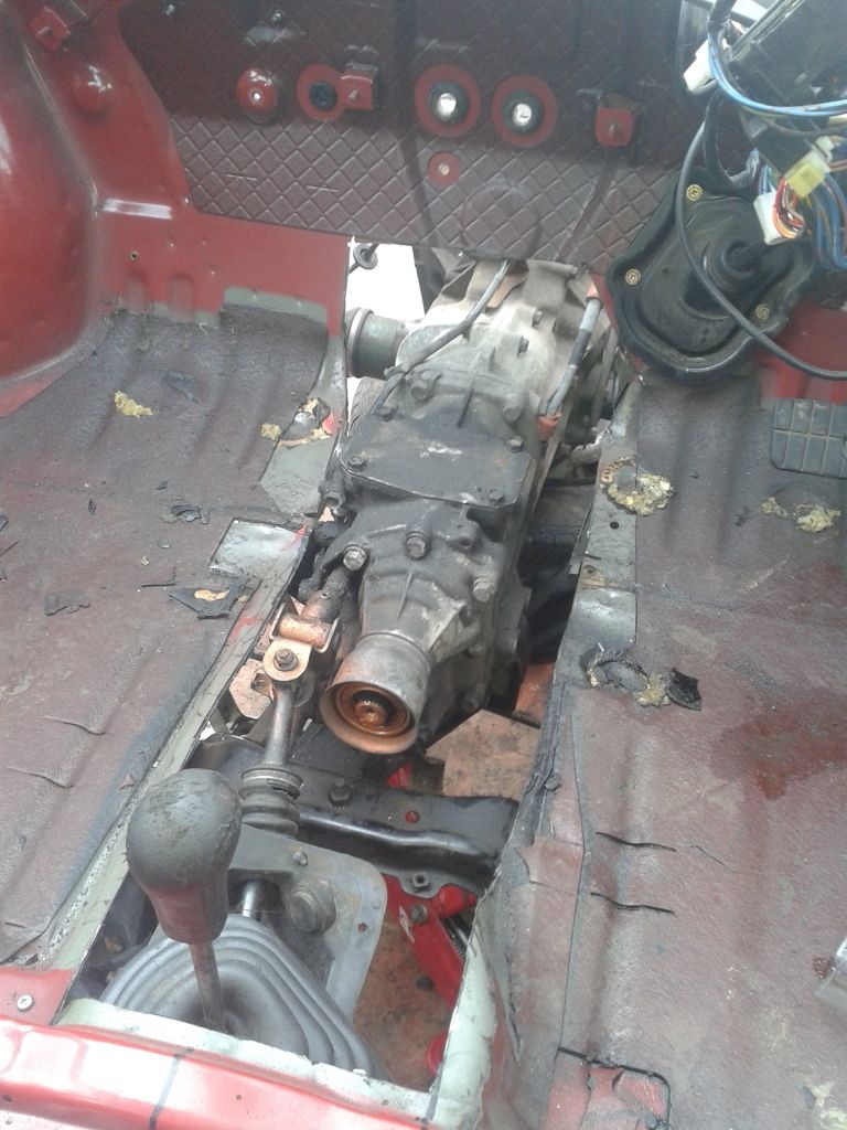

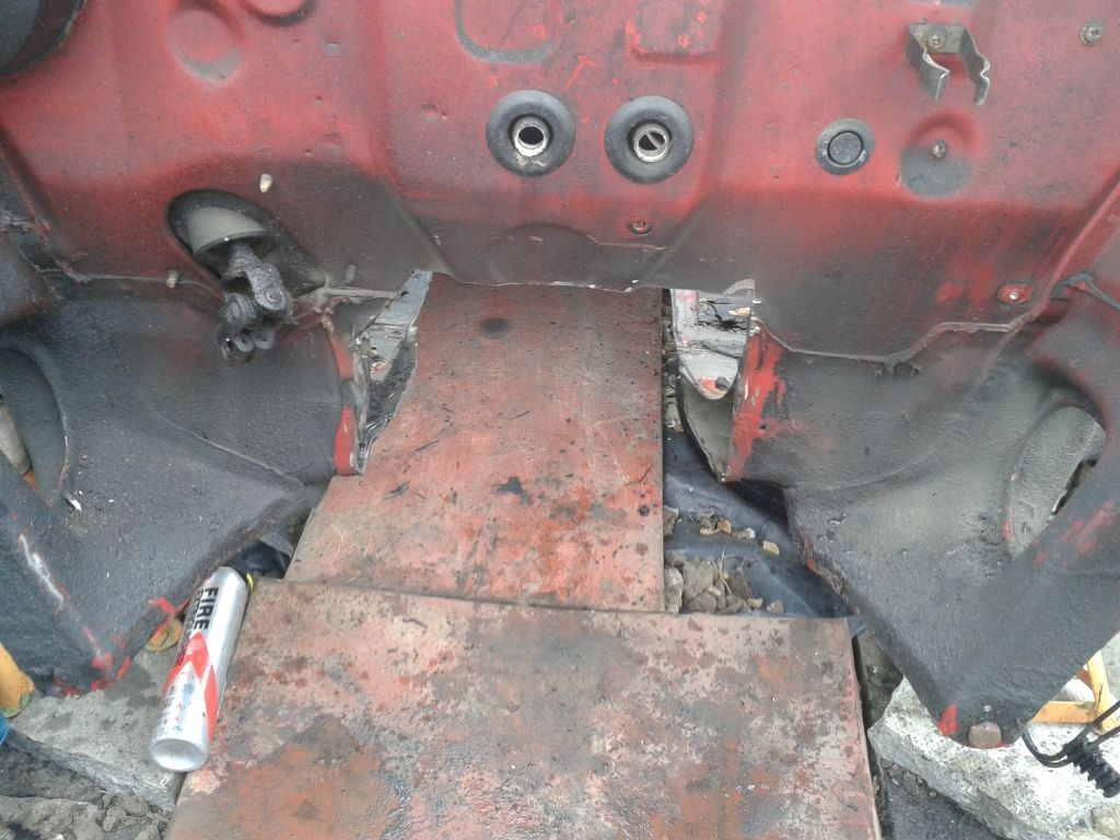

Firstly. Armed with new discs I finished off the tunnel. Slightly different to how the old white shell we did was done and for good reason. Good square lines are easier to work with when making this tunnel. Hindsight is a great thing

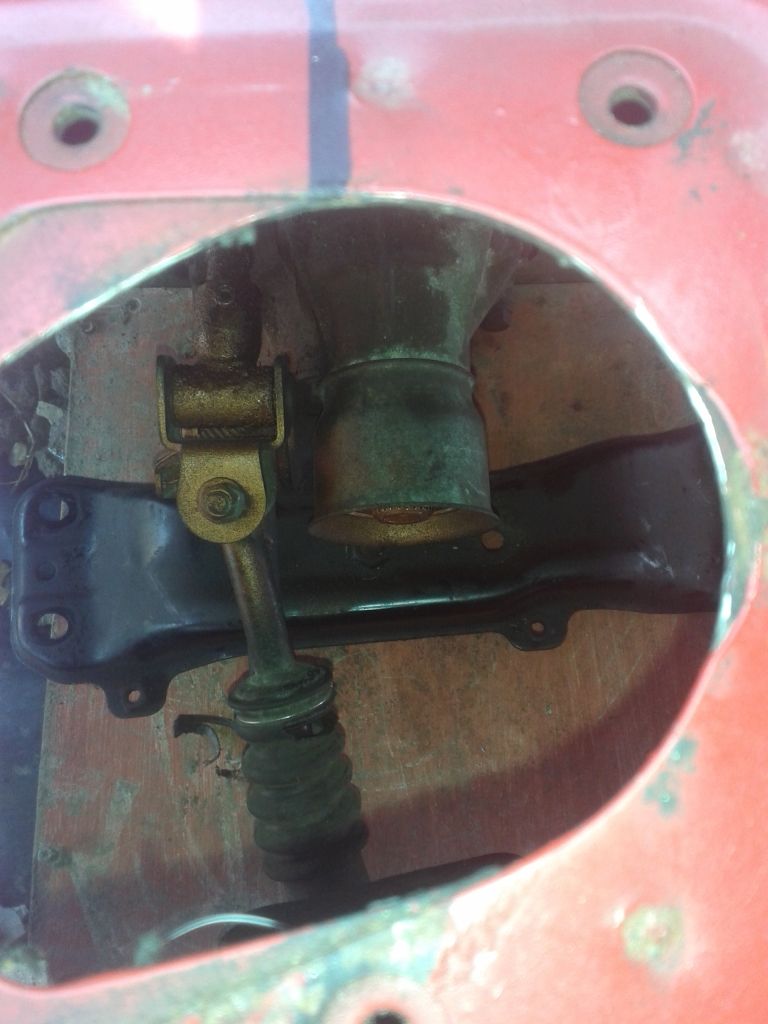

Next job was to get the gearbox actually in place rather than laid under. Forgot the gearstick recess but I know that ive got to raise half of the back section of the tunnel anyways so no worries
You can see how much room I dont have for the engine

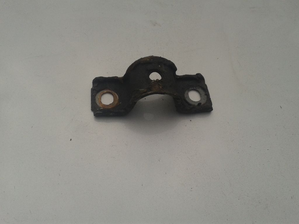

This is how it stayed because one of these went walkies so I gave up. Plus tea is ready and I've two blinds to put up. So called it a day.... found the other as I tidied up to come in.... typical
So I couldn't mount it in the end I'm making two mounts out of them
But that should be easily completed tomorrow :) that's why I say almost a success today but not far off
The new tunnel will onlyl be made once the prop and rear setup are mounted in the right position

Its 3mm too far forward for the front panel. I cant move it back either
I'd planned for space framed front anyways :) so I'm not too paniced. Plus I cut the tunnel to a 10 inch width. Instead last times 8.5 but I forgot to offset it half inch left. So its tight. The box touches the floor plan on the left
