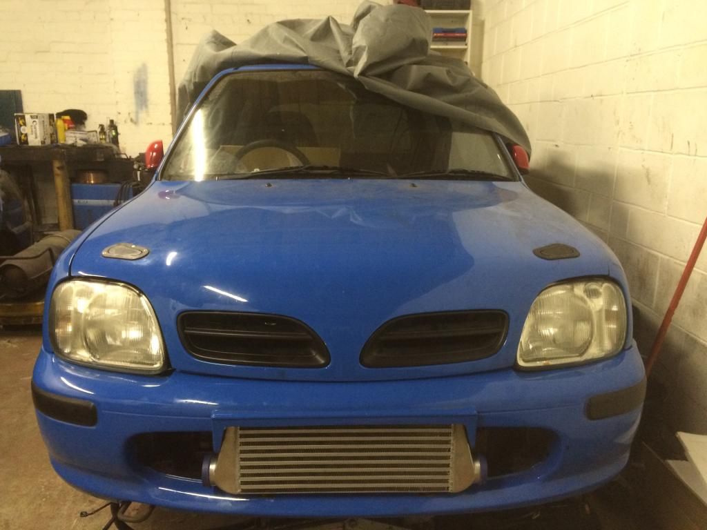

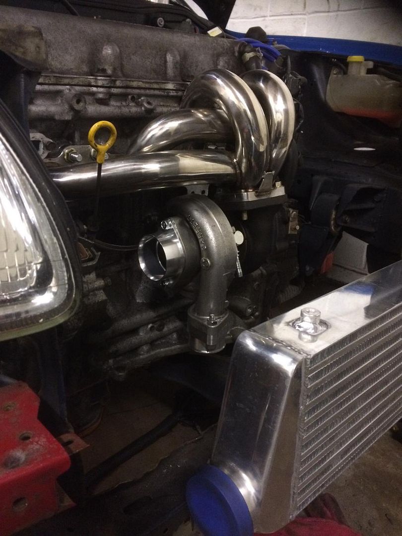

Got a few bits done last night, turbo, intercooler, pipes and injectors have all arrived

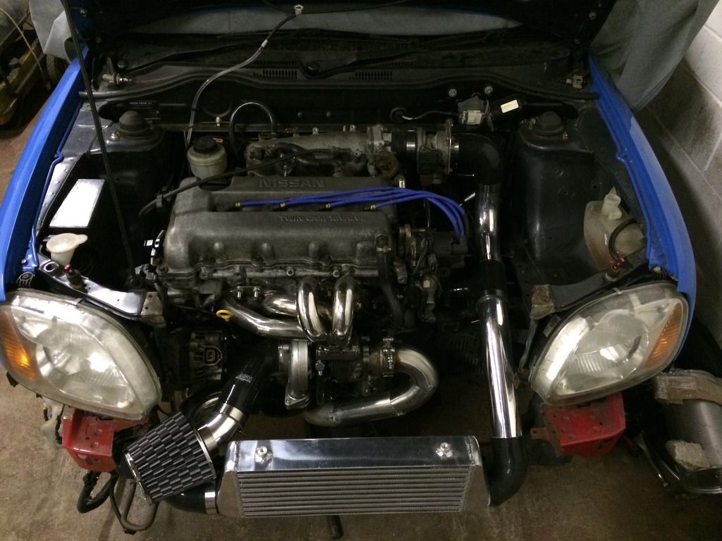

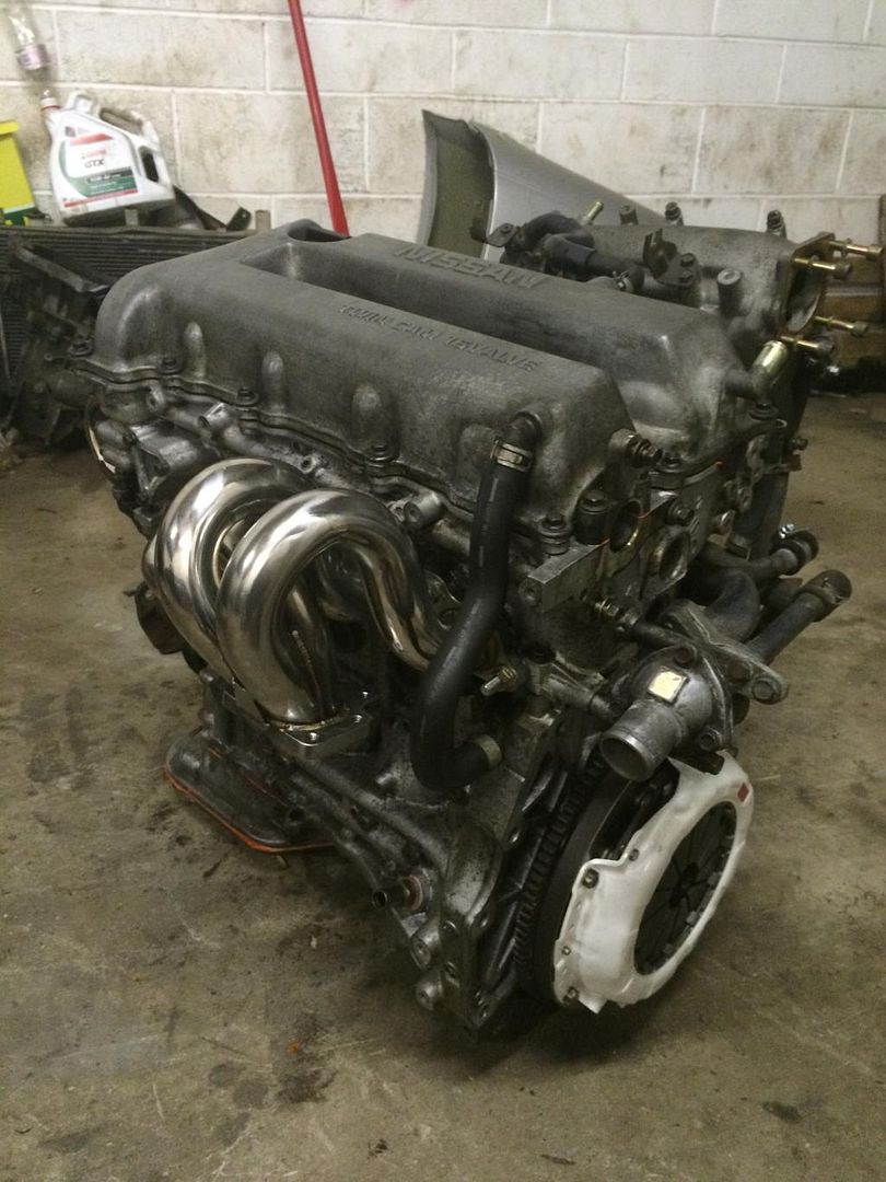

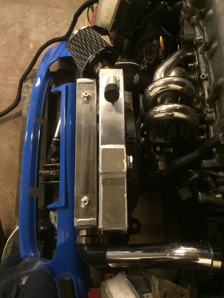

Turbo fitting all put on, intercooler bracket welded onto crossmember

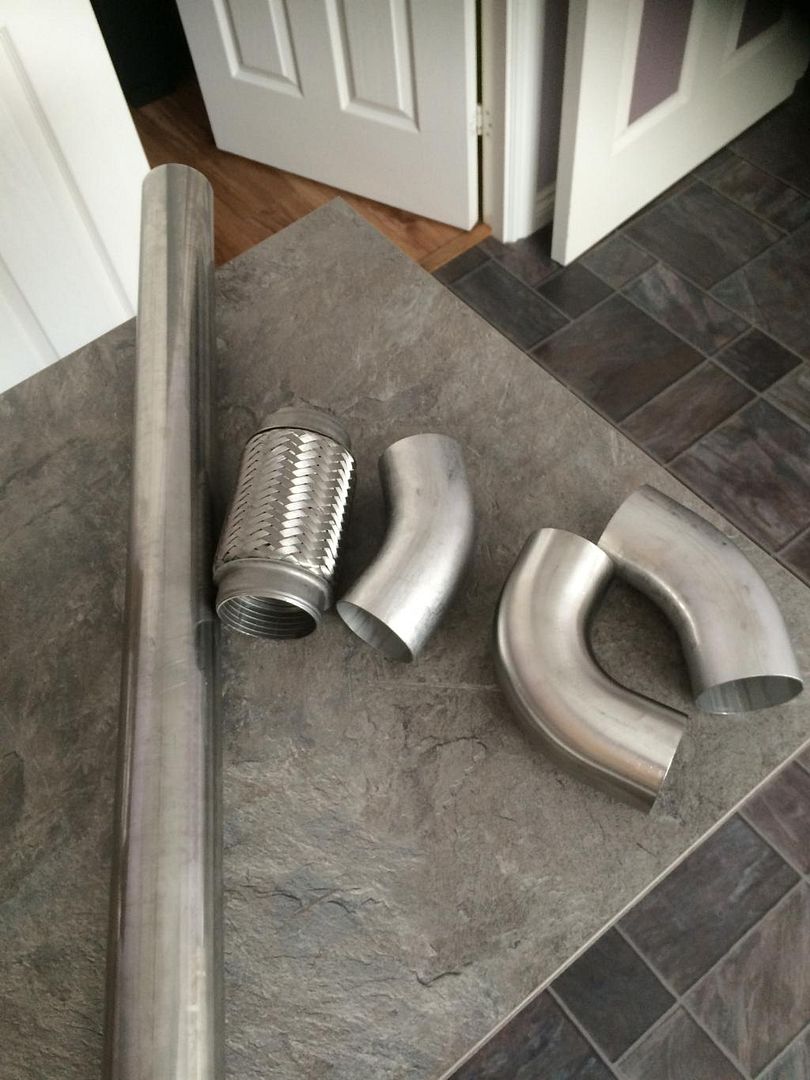

Rough pipe layout. Ordered the bend and reducers i need
Bumper chopped lol

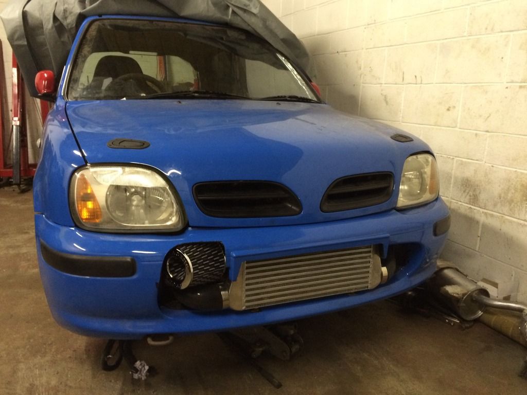

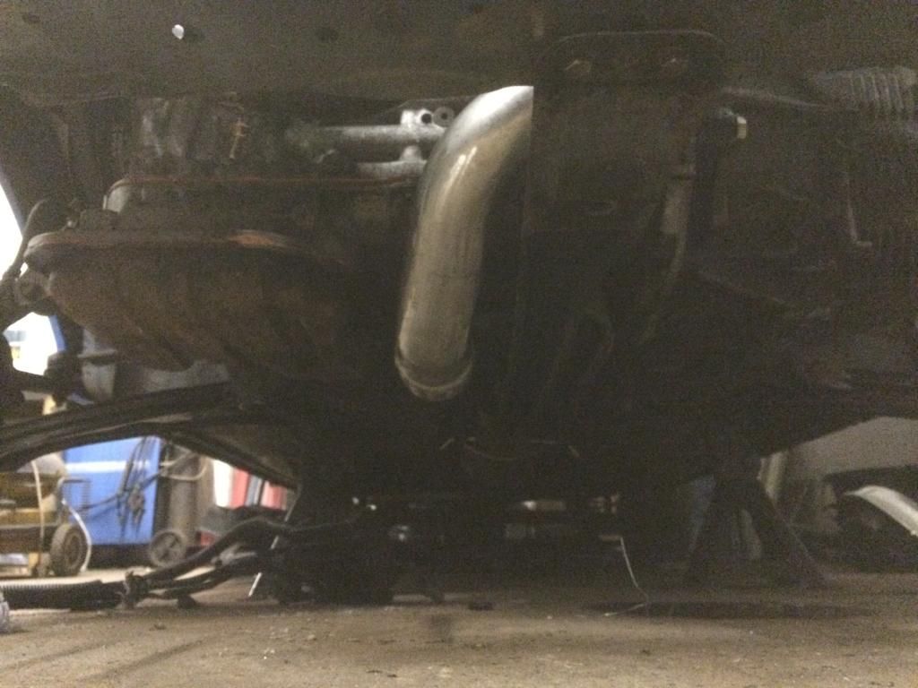

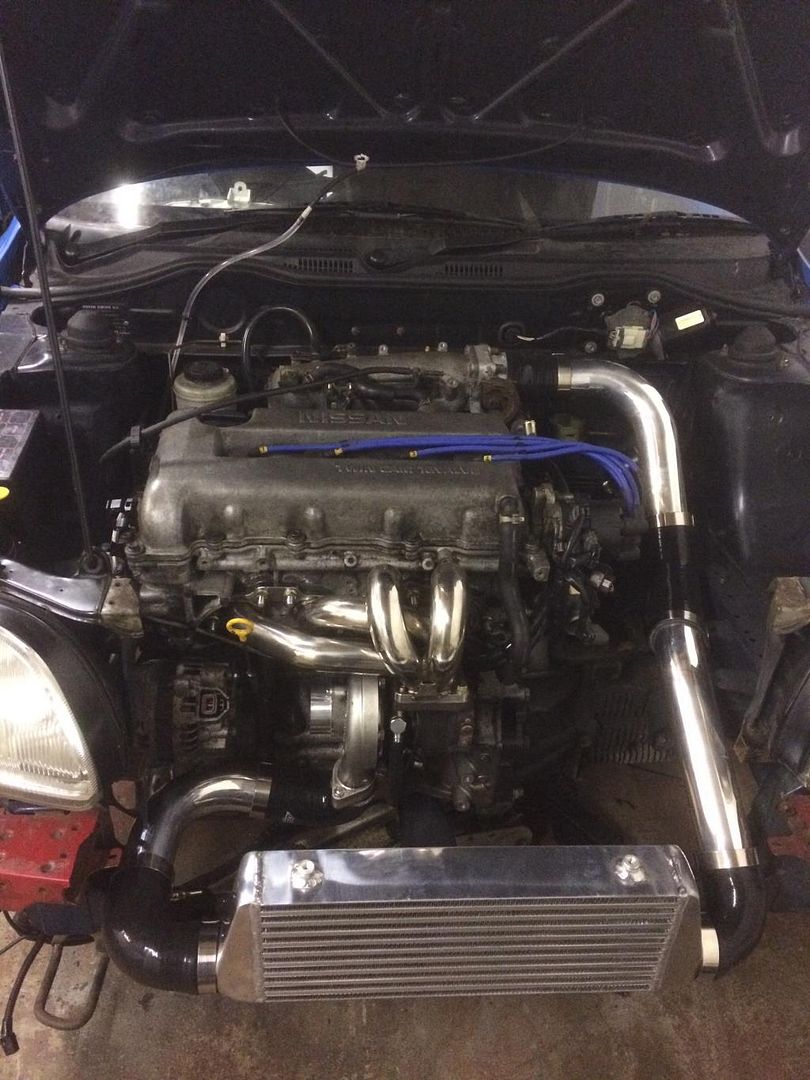

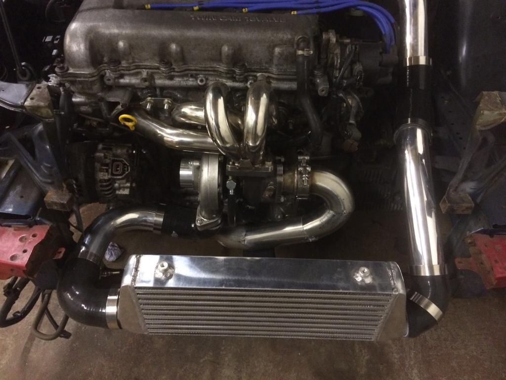

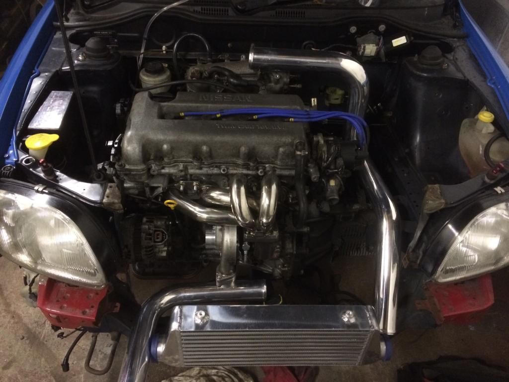

Got a few little bits done, Intercooler piping route done. Just need to add in a maf and recirc valve

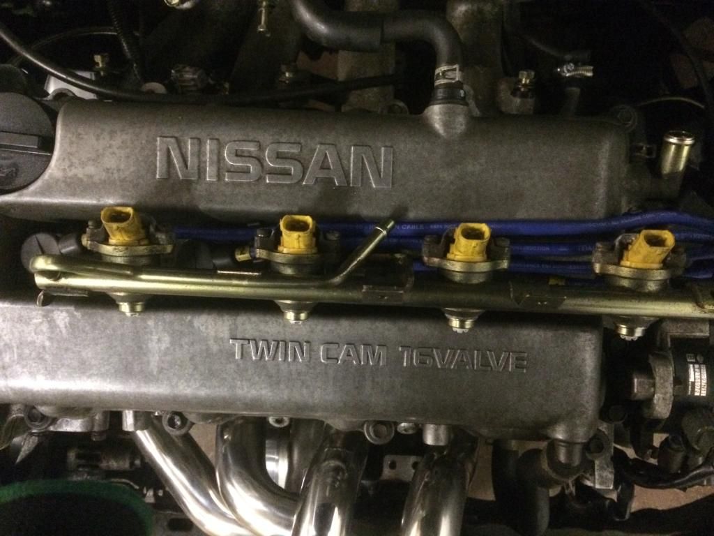

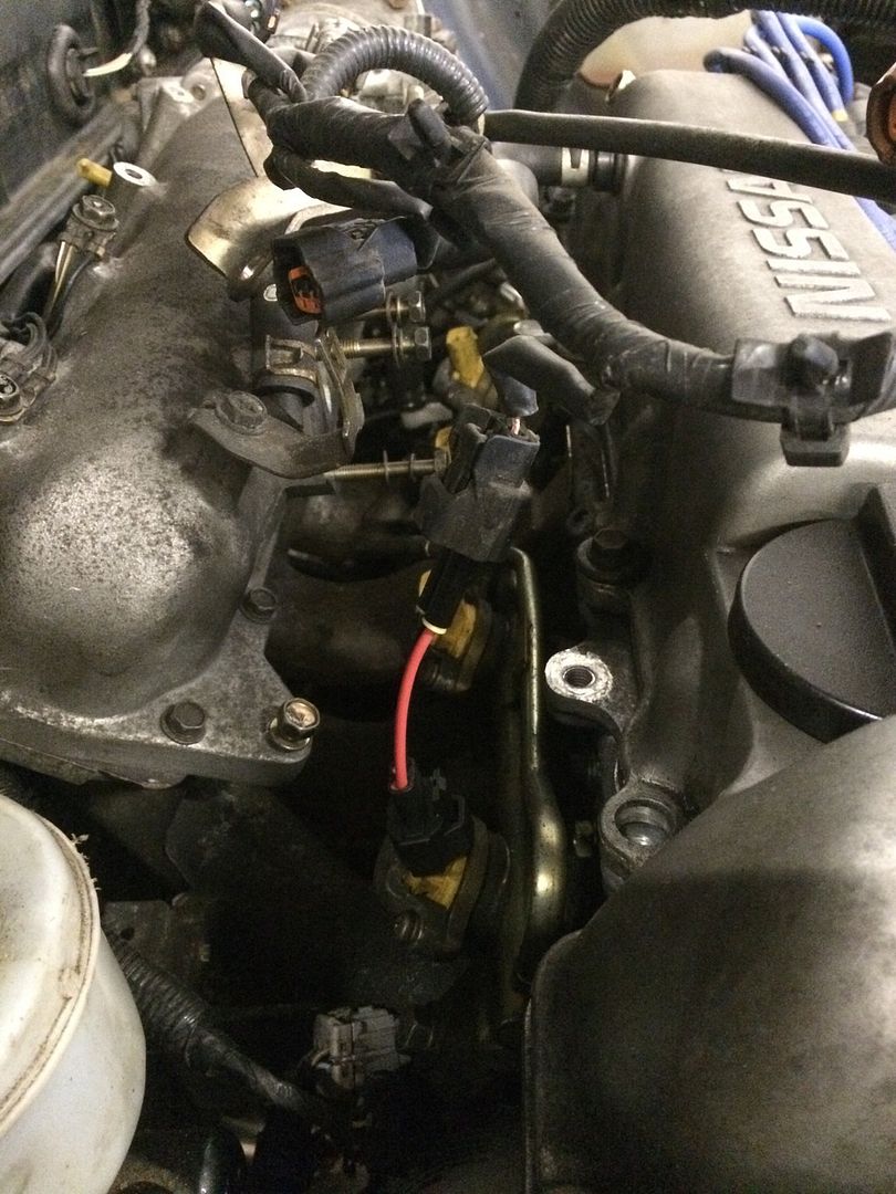

555cc injectors fitted, need to buy the correct plug adapters for these

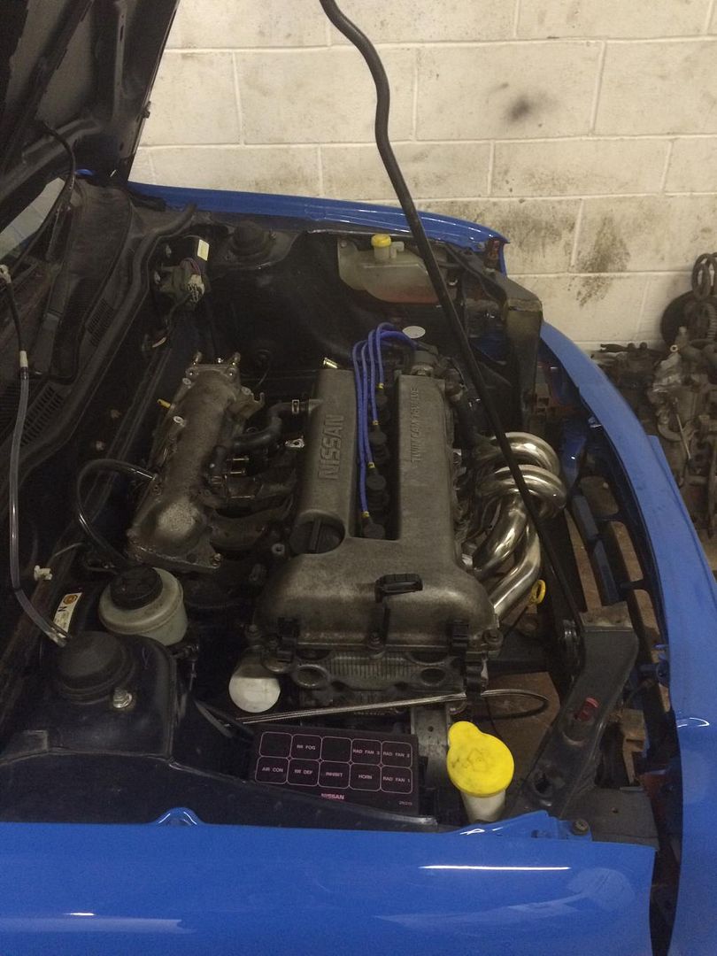

Enough to bits to reach the cat

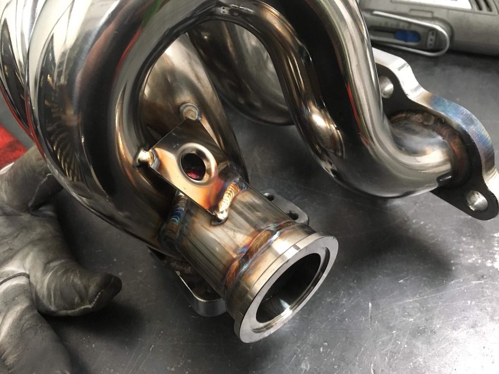

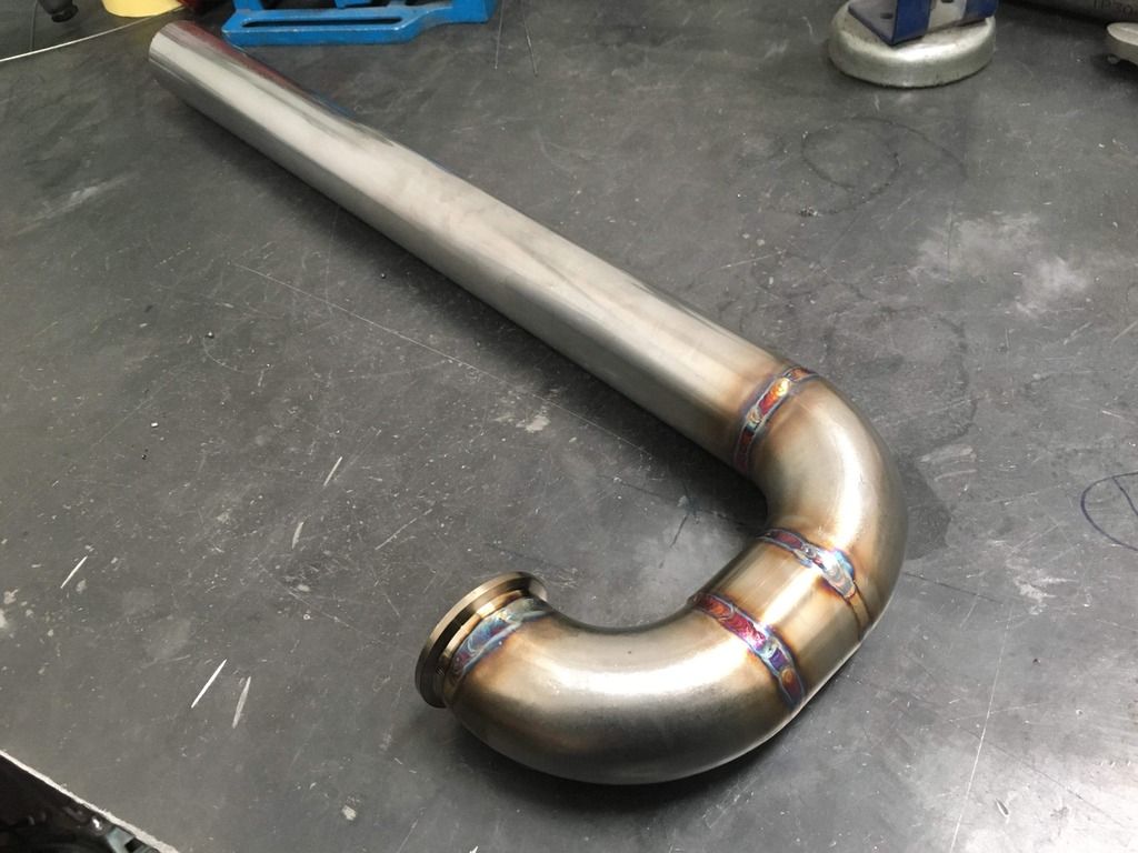

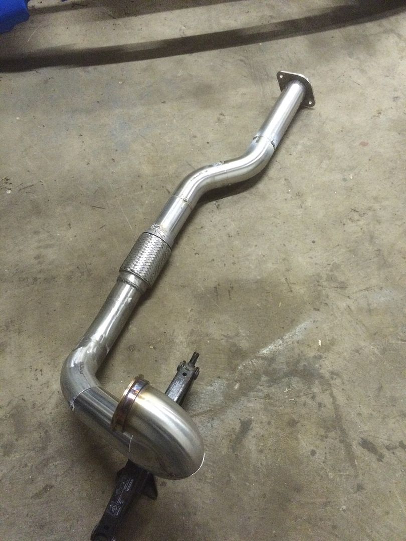

Downpipe is done and flanged to suit a cat and standard micra cat back system for mot time. Also bought more bits
Front section of exhaust
50mm radiator, will need some mods to fit

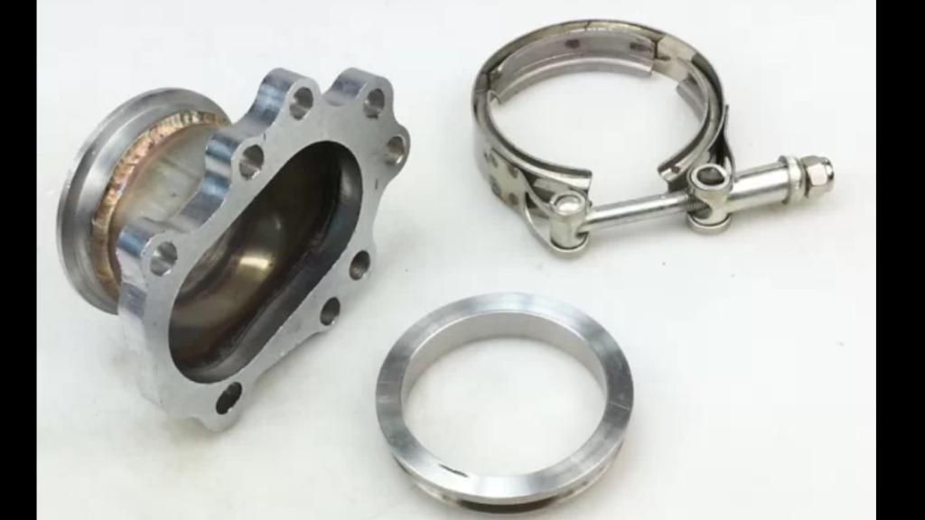

Eboost 2 controller, 40mm external wastegate and wideband

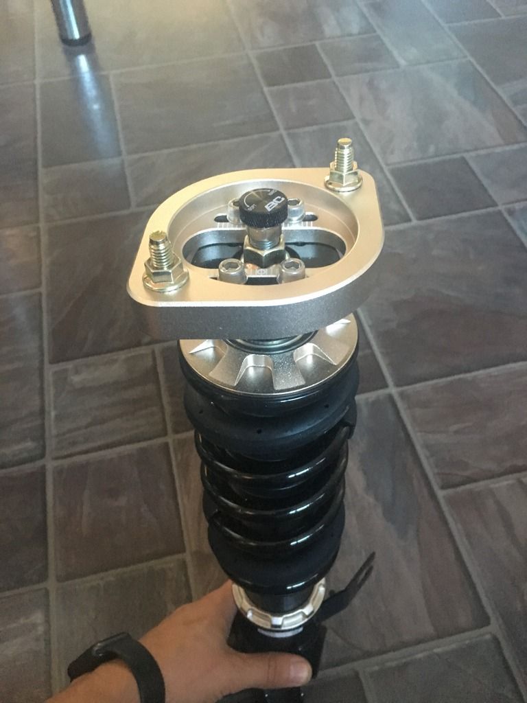

Thinking about coating the threads in grease before fitting to help with any dirt once its on the road. Ive seen the 'socks' youve made there awesome!
the grease alone will help keep the surface oily & rust free for awhile till the water spray washes it off but exposed grease will also clog up with tons of dirt particles and potentially jam up the threads when you wanna adjust em later.
imho I'd both grease the threads to control rust plus make a tight fitting water proof jacket to shield most of the water & crap away from the assembly so it lasts as long as mine.
Ok ill have a think about what ill do. Do the covers pass mot?

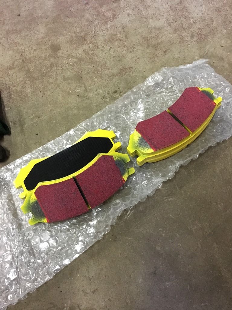

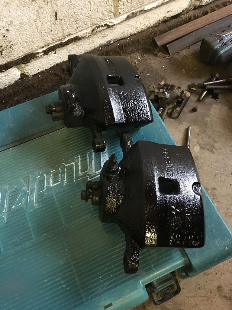

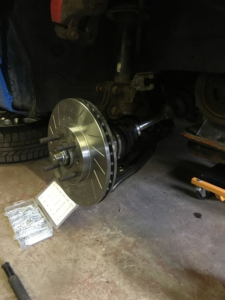

Driveshafts refitted, calipers cleaned up and repainted and fitted with evora discs and EBC yellowstuff pads
Think i need my discs machined! I ordered 256mm discs aswell, they dont rub the caliper but theres maybe 1mm clearance.
Also because its brand new pads and ive used the vibration stickers the pads are very tight against the disc.

Since the last update ive had eden at gizfab make me an exhaust from cat back, ive got some perspex windows waiting to go in, i broke my turbo whilst rebuilding it so thought F it and treated myself to a new garrett gt28rs, eden has welded up the internal wastegate on it and made me a custom coolant port and my nistune ecu is on its way!

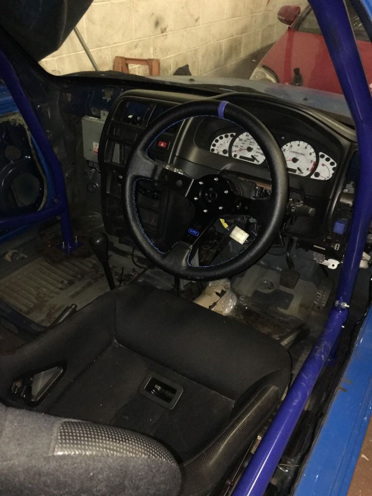

Recycled an old number plate to mount my gauges

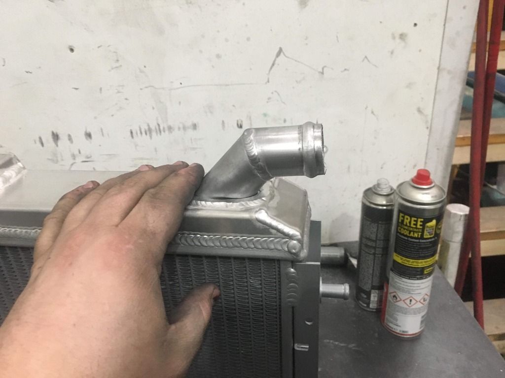

Ok so the car passed its MOT back in september 2019 but i only had 1 months use (300 miles) before i decided to fit the nistune. But that is where the problems came. Ive had no ecu to use until the beginning of this year but im happy to say the car is now running on the nistune along with 550cc injectors and a Z32 maf. Ive been able to make a few changes to the car along with things i wasnt entirely happy with so photos are to follow...
First thing was the radiator, previously I used an inline filler neck which sat at an angle and made it very difficult to top up/bleed correctly. Using a weld on fitment now corrects this
